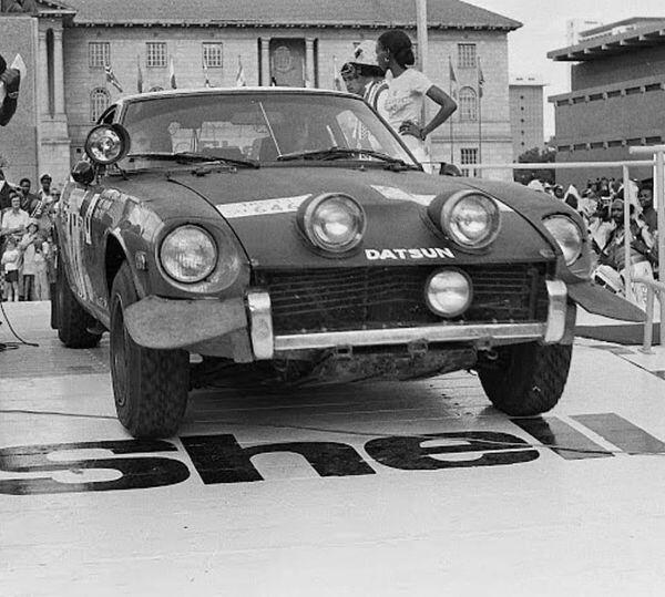

At speed, it would act something like a surfboard. I think there's a skill to driving through deep standing water where you create a sort of 'bow wave' effect which pushes the water out in front of the car at the right speed to stop it coming over the top of the car?
Some of the later cars had big rubber flaps attached to the corners of the front bumper to help with this.

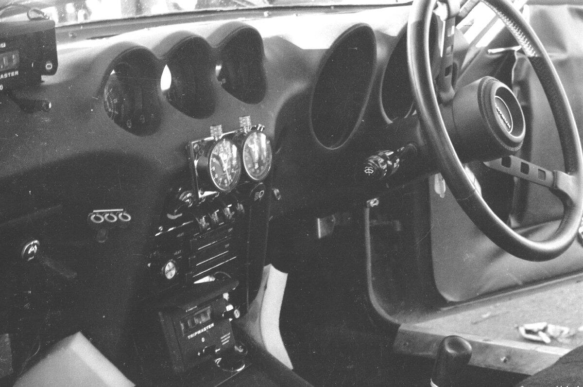

My thought process on this badge - comprised of one part deductive reasoning, and one part wishful thinking - originates from a picture taken of the dashboard in one of the Works cars, downloaded from the Nissan Global Media site. I can't say for certain that the tag pictured is an identical style, but it does look similar to my badge I had on the dashboard covering the hole made by the pen holder (since removed, when I reinstalled the pen holder- see here for more info).  Regrettably, no amount of "AI picture enhancement" - a-la Blade-Runner-style - has been able to sharpen the digits to allow me to accurately read the number.  I'd probably need someone at Nissan to provide a better source picture.  Irrespective of what the key tag actually reads, it would still seem to be similar enough in it's style to indicate that my badge was made in the same fashion.  Any inputs as to what you all think the number on the key tag reads?  (credits: Nissan Global Media)
Also to add- I’ve yet to see a period photo of any Works dashboard where the Kanri number is prominently displayed. My own reasoning is that the badge was placed there by the enthusiast-owner in period, simply as a means of covering the slot for the pen holder.  It made a bit of sense to further reason that he got the key tags with the keys when he bought the car, and later refashioned one for use on the dashboard.

Here's a photo of one of the Works cars from the 1971 RAC Rally of GB. Key fob tag just about visible under there, and with rounded corners like yours:

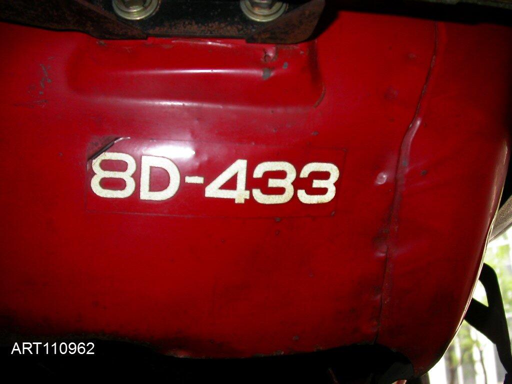

Works 'Kanri' (maintenance) numbers are a tricky topic by their nature. These were Nissan's internal ID codes for the individual Works cars, not for us to use or necessarily to understand. Even the service barges had them, but sometimes they did not appear on the cars.
Here's a photo I took of the Kanri number on the '71 East African Safari winner, before the car was 'refreshed' a few years ago (in my opinion it didn't need half of what they did to it, but there you go...). The number is on a clear oblong sticker with the letters and numbers in a kind of golden reflective material:
