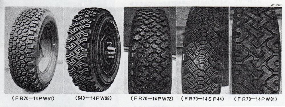

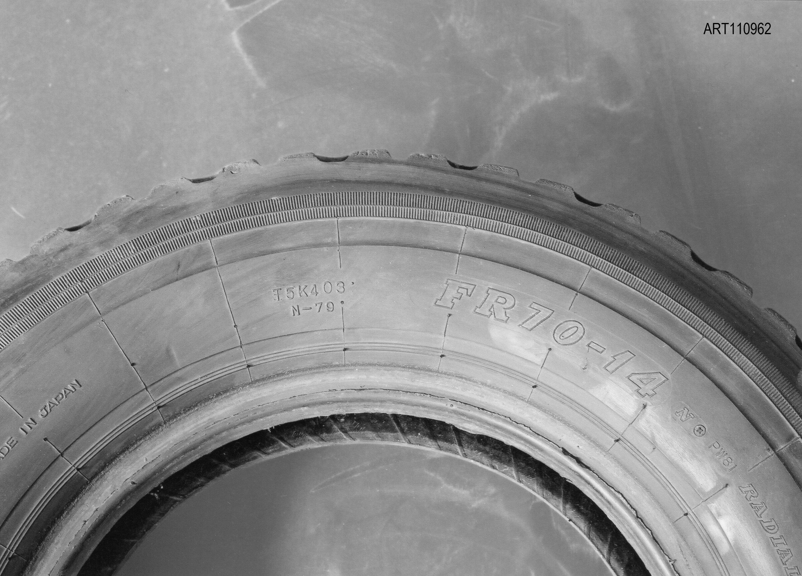

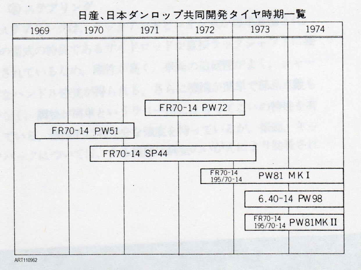

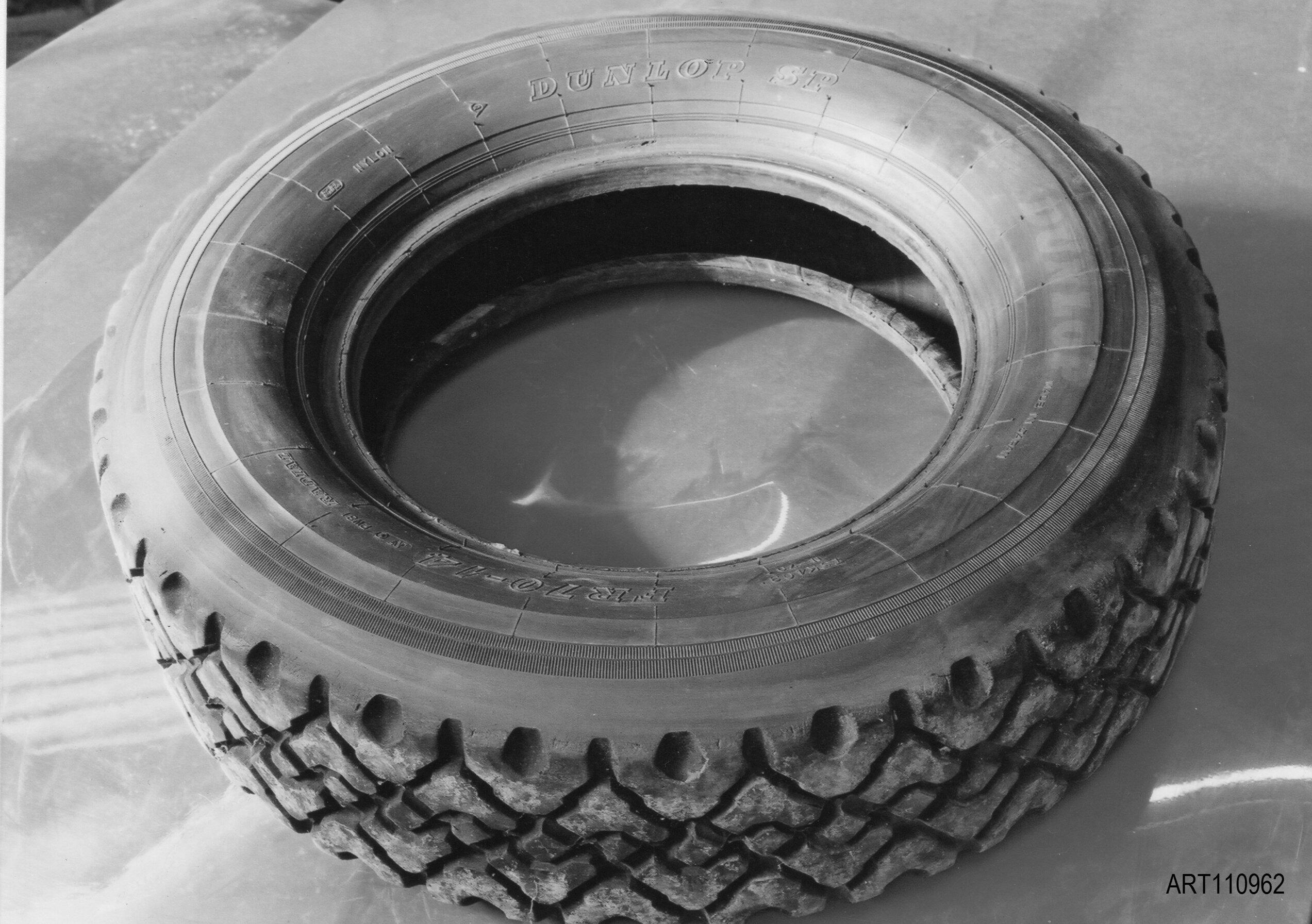

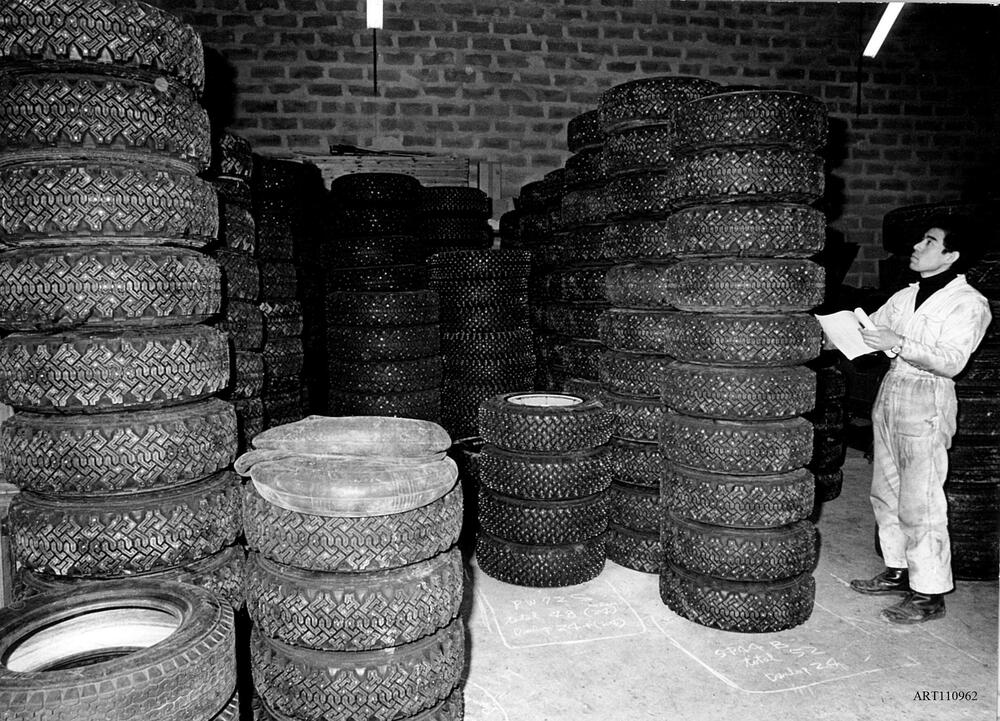

August 27, 20222 yr Popular Post comment_644605 On 8/27/2022 at 5:42 PM, 240zadmire said: Found the tire size and type http://zhome.com/BRETotal/Tires/BajaTires.htm The BRE Baja 240Z and the Nissan Works rally 240Zs have no connection whatsoever. Two completely different things. The most commonly-used tyre on the Nissan Works rally 240Zs was the Dunlop (Japan) SP44, with the PW51 and PW72 also used for snow and ice stages, usually fitted with spikes. Link to comment https://www.classiczcars.com/forums/topic/67572-1970-240z-works-rally-the-road-to-restoration/?&page=5#findComment-644605 Share on other sites More sharing options...

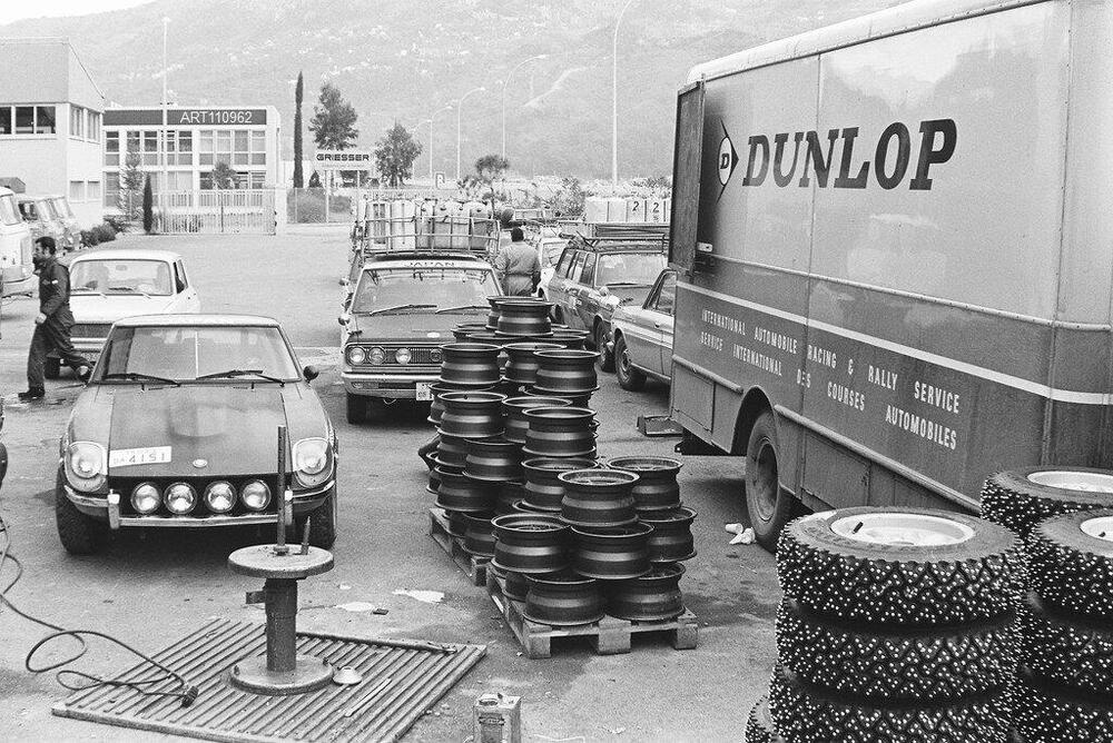

August 28, 20222 yr comment_644609 I really love seeing those piles of rally tires ! Today I am hopeless about 14 inches off-road tires in Japan .We have many cool tread patterns but they are all for 15 inches or bigger wheels. I have stored Michelin XWX 205/70-14 ( I was thinking about if I buy a Dino 246 ! ) , so far this is my least choice for fatty bigger tire for my Zs when I want some feelings of rally car. Kats Edited August 28, 20222 yr by kats Link to comment https://www.classiczcars.com/forums/topic/67572-1970-240z-works-rally-the-road-to-restoration/?&page=5#findComment-644609 Share on other sites More sharing options...
August 28, 20222 yr Author comment_644610 @HS30-H Interesting to see the tubes. Did they run the studded tires with tubes? How about the regular tires? I also ask because tubes tend to give the tires that "rounded profile" look when mounted, and I've always felt that the XP44 tires appear to have a sidewall bulge in some period pictures, indicative of their use. Also, I must say that some of my Kobe Seikos (both the real and the replica mags) do not hold air for long. In 2-3 weeks time, at least one tire is low. Edited August 28, 20222 yr by xs10shl Link to comment https://www.classiczcars.com/forums/topic/67572-1970-240z-works-rally-the-road-to-restoration/?&page=5#findComment-644610 Share on other sites More sharing options...
August 28, 20222 yr Popular Post comment_644613 On 8/28/2022 at 4:31 AM, xs10shl said: @HS30-H Interesting to see the tubes. Did they run the studded tires with tubes? How about the regular tires? I also ask because tubes tend to give the tires that "rounded profile" look when mounted, and I've always felt that the XP44 tires appear to have a sidewall bulge in some period pictures, indicative of their use. Also, I must say that some of my Kobe Seikos (both the real and the replica mags) do not hold air for long. In 2-3 weeks time, at least one tire is low. That period of Japanese Dunlop radials - especially the 'SP Radial' series, which was a key branding product for Dunlop Japan on road cars - was designed to run either with and without tubes. There are some good technical articles covering them in the period Japanese specialist press (especially Auto Technic and Auto Sport magazines) and they were certainly pushing the 'Tubeless' philosophy. However, for sure the Works team were running with tubes some of the time. It probably made puncture repair turnaround faster at remote servicing. I use tubes in my original Kobe Seikos when fitted with Dunlop CR65s, but it is the tyres themselves which let the air out! They are supposedly a Tubeless design, but I see no harm in using tubes. Old Magnesium wheels can become quite porous, so best to inspect and treat on a case-by-case basis. Generally speaking I tend to suspect the rubber is at fault rather than the wheel unless the wheel is a repeat offender. The Japanese Dunlops had a really good reputation in period. Nissan's Works team manager said they could not have done so well on the Monte (against rear-engine, rear-drive/front-engine, front-drive cars with their inherent traction advantage) or won the Safari without the Japanese Dunlops. In fact one or two of the UK-based drivers 'acquired' several sets for their own personal use... Link to comment https://www.classiczcars.com/forums/topic/67572-1970-240z-works-rally-the-road-to-restoration/?&page=5#findComment-644613 Share on other sites More sharing options...
August 28, 20222 yr comment_644617 It's surprising the tires are that porous! Also that is a lot of wheels on those pallets! Link to comment https://www.classiczcars.com/forums/topic/67572-1970-240z-works-rally-the-road-to-restoration/?&page=5#findComment-644617 Share on other sites More sharing options...

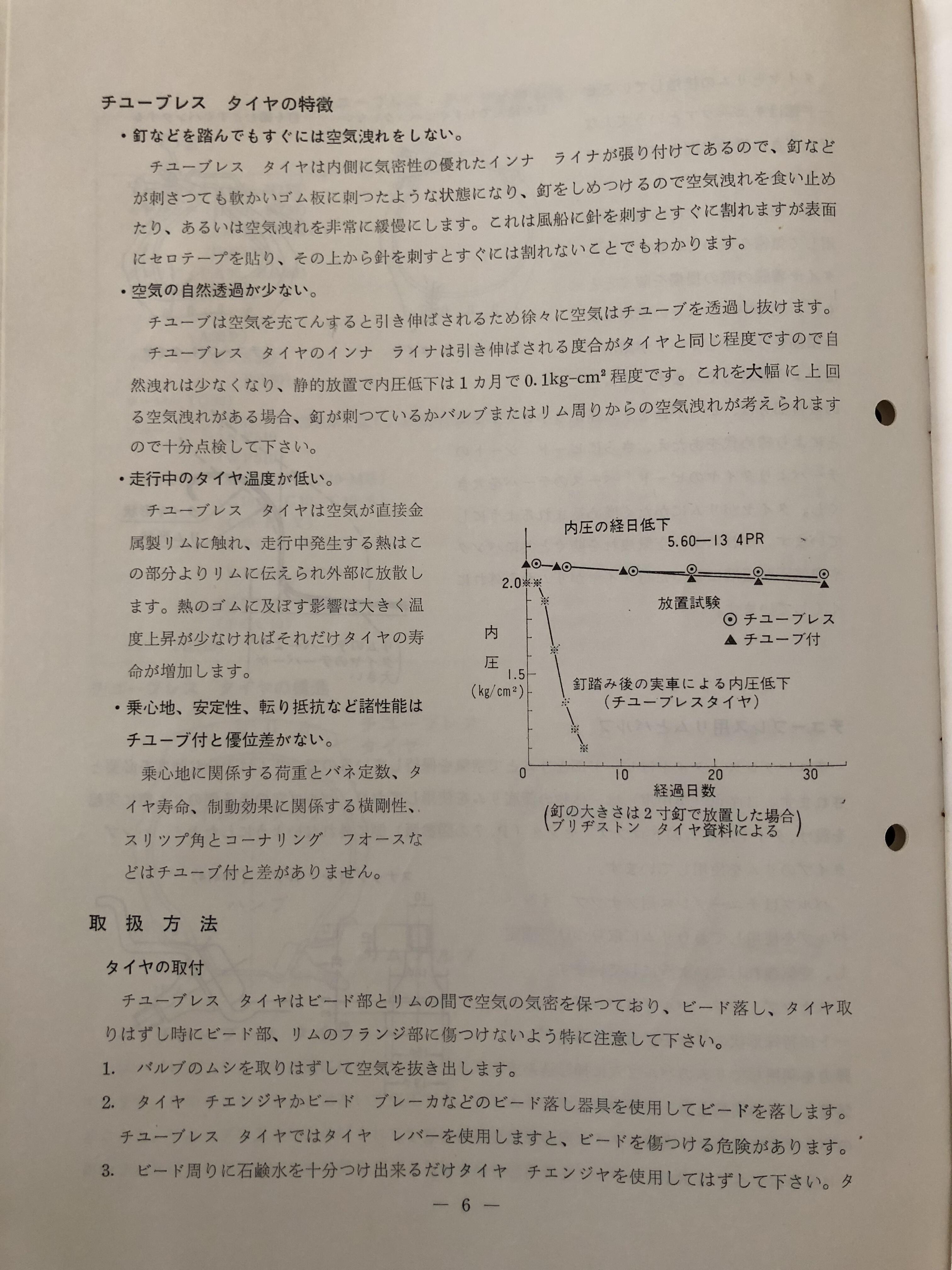

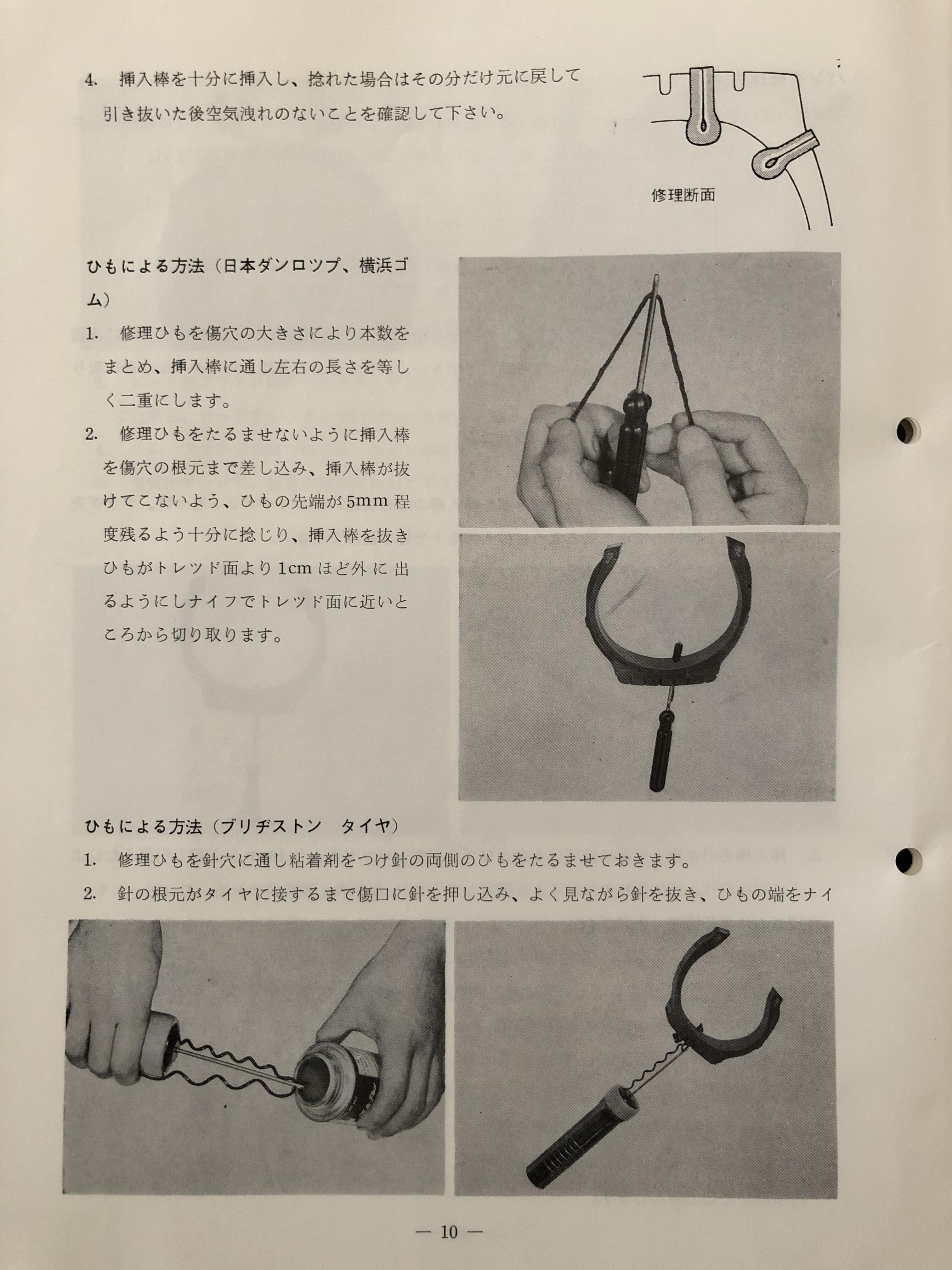

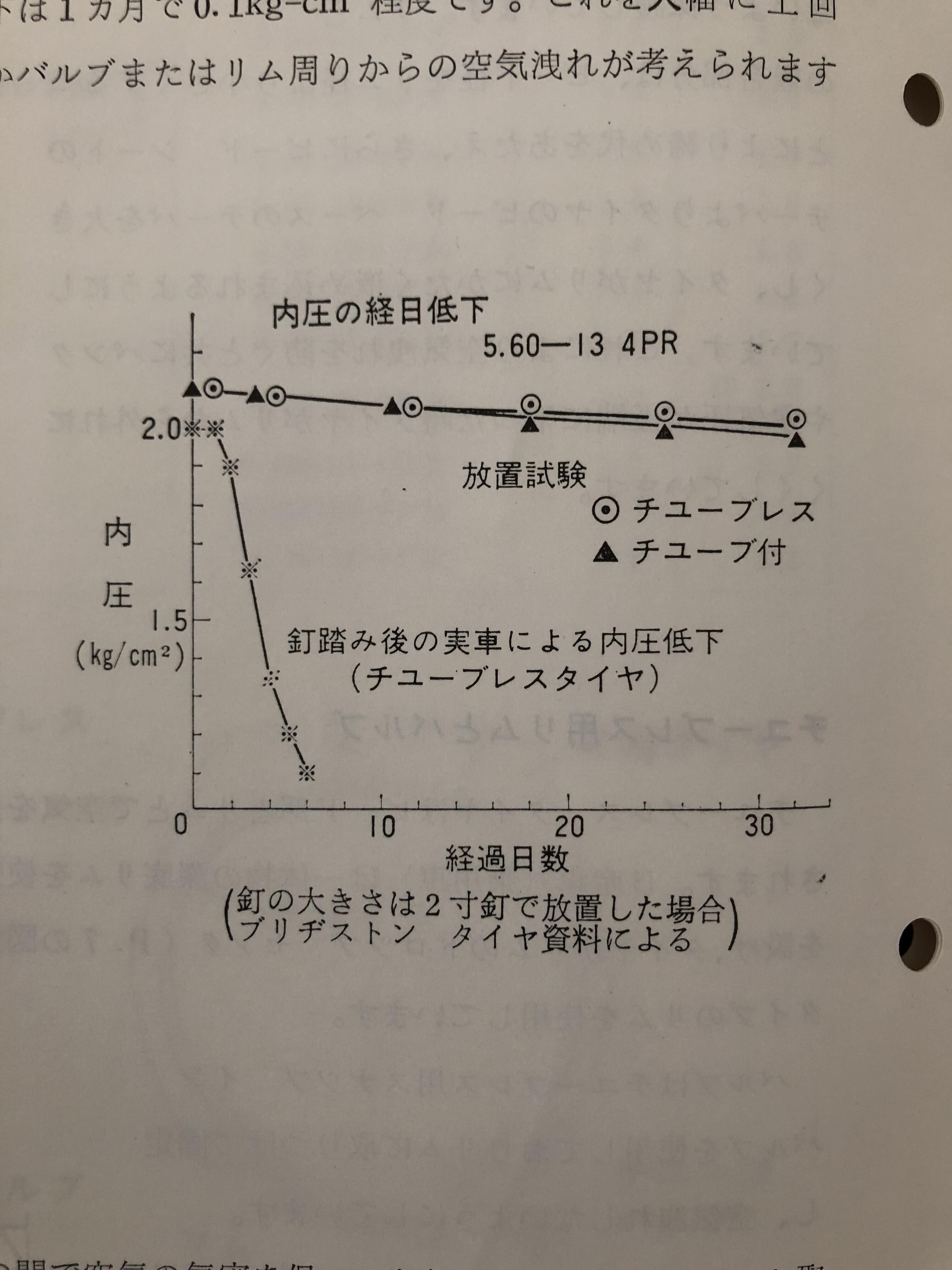

August 30, 20222 yr comment_644699 An interesting book , ‘Service information about Tubeless tire ‘ March 1970 , Nissan Moto co.ltd. Like Alan said ,Nissan was pushing Tubeless tire more than before . This book describes so many advantages of Tubeless tires against tire with tube , a figure is showing air leak of Tubeless vs Tube . Another figure is showing the reason of punctuation, at that time Japanese road was not good condition, it said nails were the highest cause of the punctuation. And an interesting thing is , service for punctuation a several method for each of tire manufacturer . Sorry for off topic . Kats Link to comment https://www.classiczcars.com/forums/topic/67572-1970-240z-works-rally-the-road-to-restoration/?&page=5#findComment-644699 Share on other sites More sharing options...
