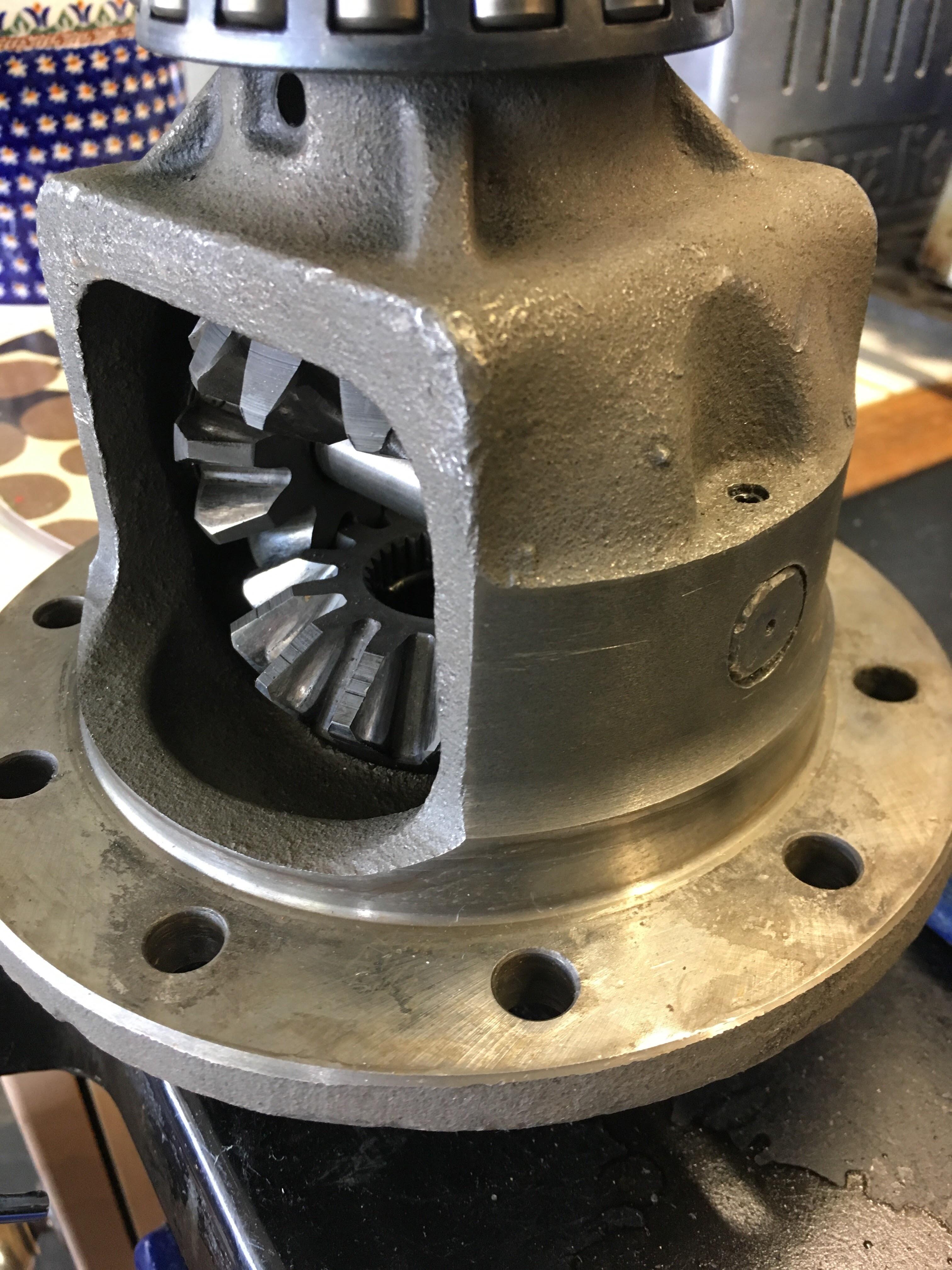

June 20, 20222 yr comment_641694 Here's my old r200 open diff. You can see the end of the shaft that carries the spider gears and its a bit chewed from the roll pin breaking and the shaft rattling around. Link to comment https://www.classiczcars.com/forums/topic/67577-bad-noises-somewhere-in-my-drive-train/#findComment-641694 Share on other sites More sharing options...
