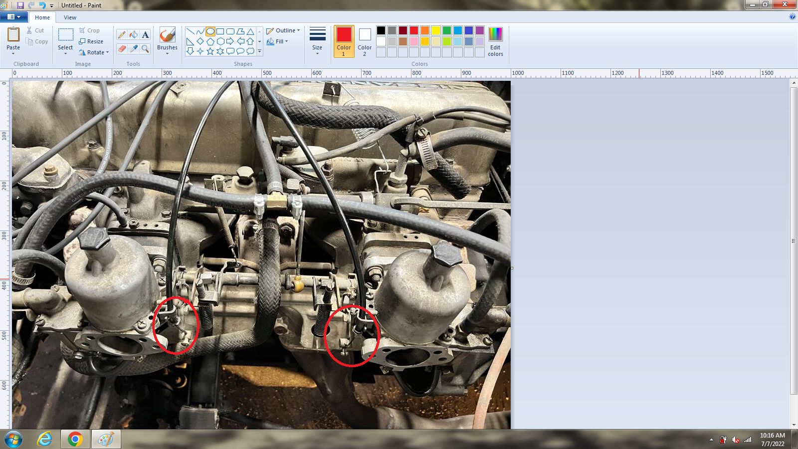

OK, thanks for your patience, folks...here are finally some pix of my carbs as they are. If you see any red flags, I'd sure like to hear from you.
Short story for reference: Car runs. Front carb sucks vastly more air into the horn than back carb, even when throttle screw backed completely out and all linkages disconnected. Idles at 1500-2500 rpm at present, with all screws backed completely off the stops so carbs should be at maximum closed position. Cannot even remotely try to balance.

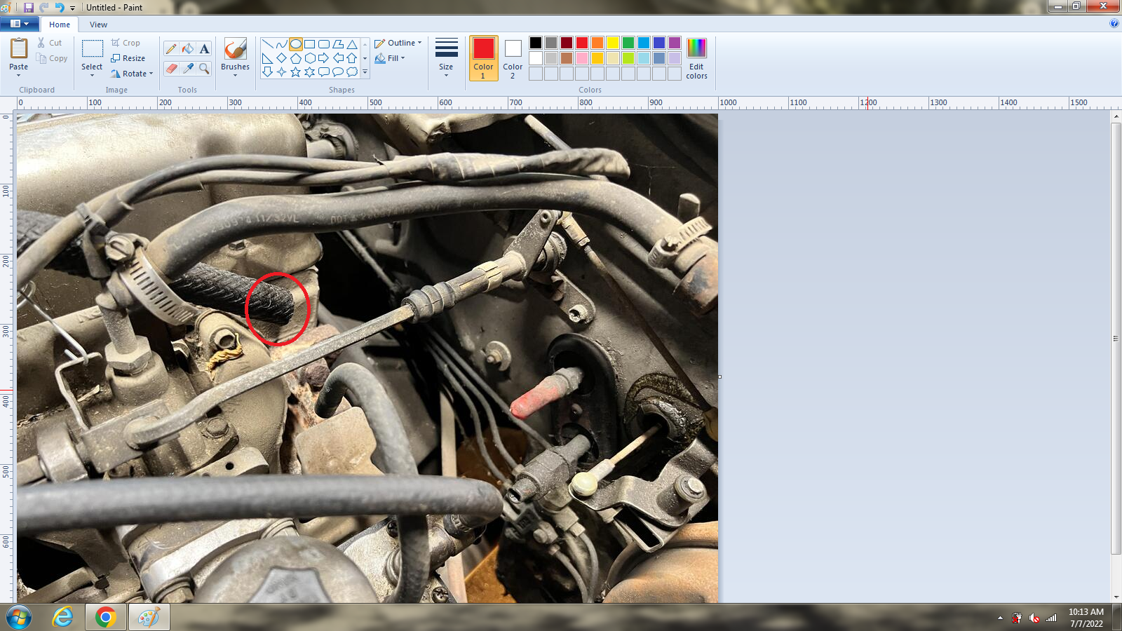

2 minutes ago, siteunseen said:
What does this go to?
And I would unhook the throttle cables while trying to figure it out.
Those are the choke cables, no? I have had the throttle linkage disconnected entirely while doing all this but have not messed with the cables indicated here. Still it makes sense to disconnect them in case it's a choke problem hassling me here, thanks for pointing it out.
Also that fat hose goes from the valve cover to the back of the air cleaner assembly, as do the two smaller hoses coming from the carbs. The big one I assume is some sort of PCV thing? Here I reassembled the air cleaner backplate hose layout for a visual aid.
Curious how the fuel lines go to a "T" and then over the top of the valve cover to... what? How about a pic of the other end of the single fuel line that goes over the top of the valve cover. I'm guessing it just goes to the hard line on the right inner fender? I'm also guessing you have an electric fuel pump at the tank? Or is there a mechanical pump on the passenger side of the engine?
That's a good observation, @w3wilkes. @DadAndLadZ, you should probably check your fuel pressure. With not having the stock fuel rail, you lack the fuel pressure regulation afforded by the orifice in the return line.
