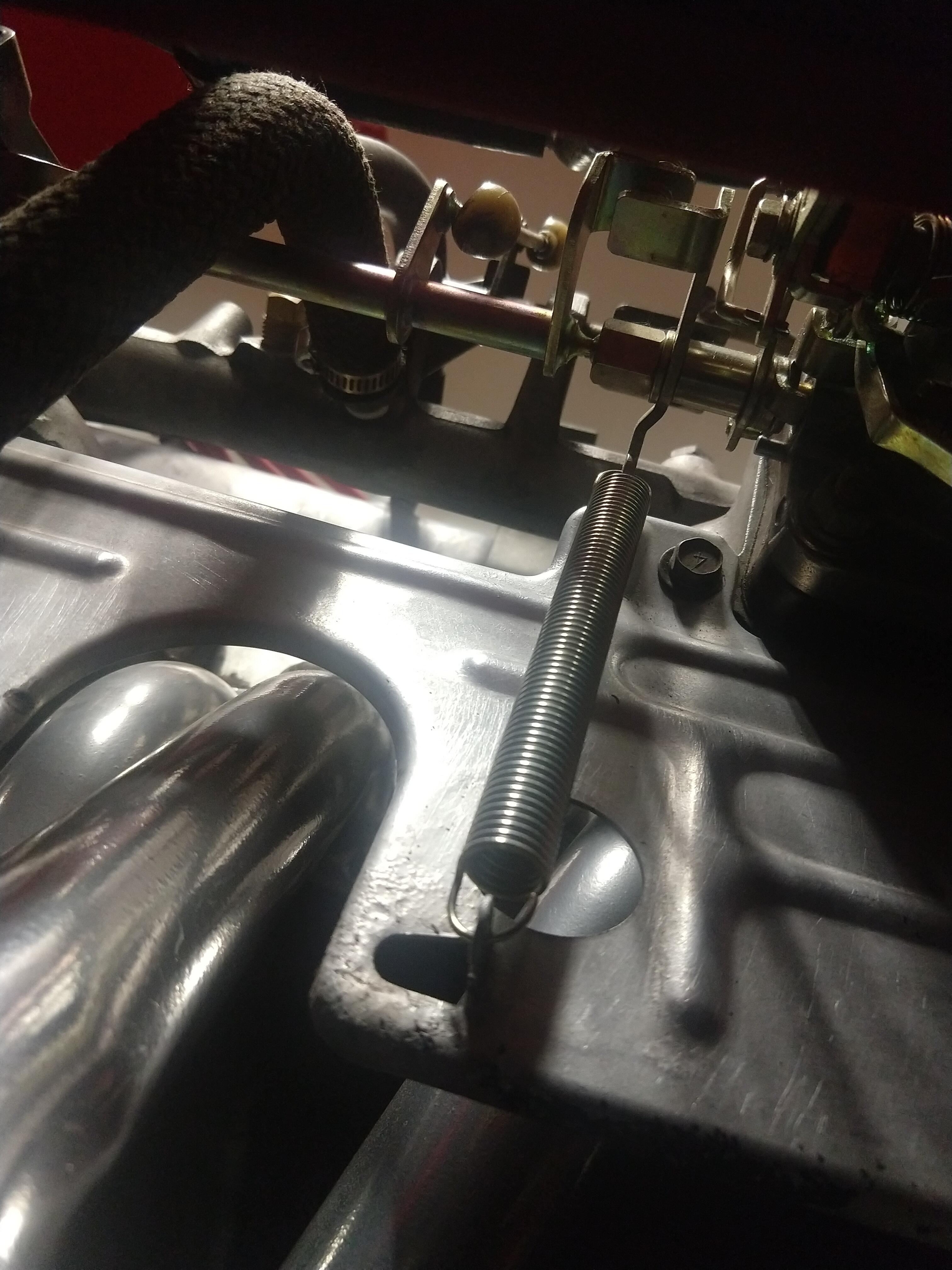

July 7, 20222 yr comment_642153 Here's how the throttle return springs should be hooked up. There's one on each carb. Link to comment https://www.classiczcars.com/forums/topic/67606-carburetor-conundrum-260z/?&page=3#findComment-642153 Share on other sites More sharing options...
July 7, 20222 yr Author comment_642154 9 minutes ago, w3wilkes said: Here's how the throttle return springs should be hooked up. There's one on each carb. Â Interesting, thank you! Link to comment https://www.classiczcars.com/forums/topic/67606-carburetor-conundrum-260z/?&page=3#findComment-642154 Share on other sites More sharing options...

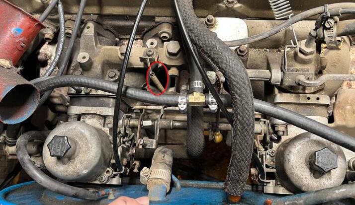

July 7, 20222 yr comment_642161 One thing I notice is this spring I've circled in red. Remove it and just let that lever thing it's attached to flop around. That lever thing is for a partial throttle opener on deceleration but the emissions part that connects to that lever has been deleted. As it is the spring would be fighting the throttle close springs on each carb. Link to comment https://www.classiczcars.com/forums/topic/67606-carburetor-conundrum-260z/?&page=3#findComment-642161 Share on other sites More sharing options...
July 7, 20222 yr comment_642162 9 minutes ago, w3wilkes said: One thing I notice is this spring I've circled in red. Remove it and just let that lever thing it's attached to flop around. Yup. That's the one I referred to as "the top front return spring kludge".    Much easier to identify with your annotation on the pic. The way is right now, it's pulling the throttle ON instead of pulling the linkage off. Link to comment https://www.classiczcars.com/forums/topic/67606-carburetor-conundrum-260z/?&page=3#findComment-642162 Share on other sites More sharing options...

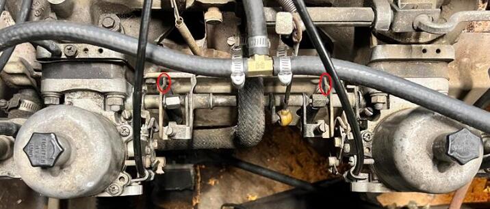

July 7, 20222 yr comment_642163 Still looking at your pics and want to verify that you have throttle return springs attached to the 2 circled levers and go down and attach to the heat shield between the intake and exhaust manifolds. Link to comment https://www.classiczcars.com/forums/topic/67606-carburetor-conundrum-260z/?&page=3#findComment-642163 Share on other sites More sharing options...
July 7, 20222 yr Author comment_642164 2 minutes ago, w3wilkes said: Still looking at your pics and want to verify that you have throttle return springs attached to the 2 circled levers and go down and attach to the heat shield between the intake and exhaust manifolds. Â There are. Link to comment https://www.classiczcars.com/forums/topic/67606-carburetor-conundrum-260z/?&page=3#findComment-642164 Share on other sites More sharing options...
