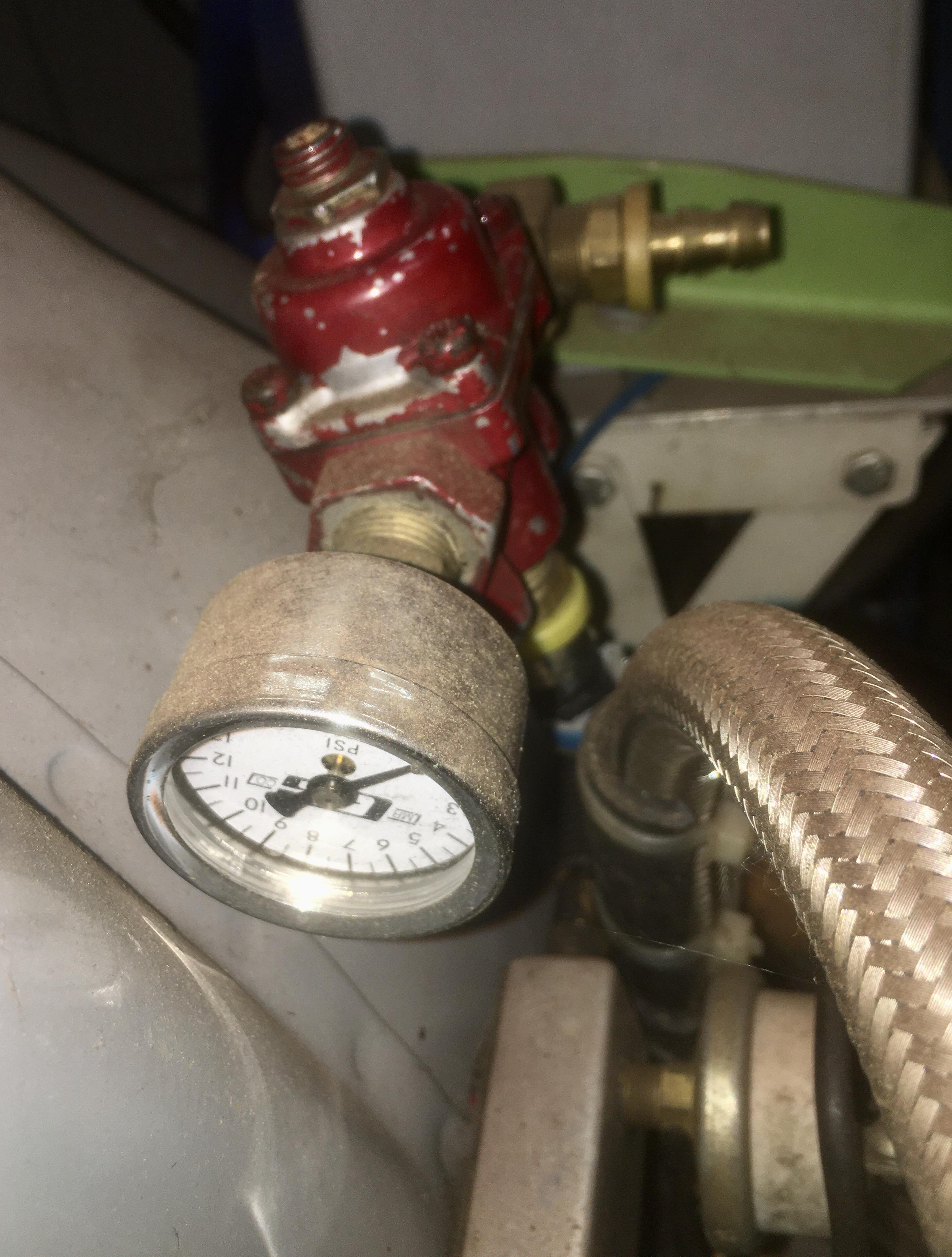

August 6, 20222 yr comment_643397 On 7/7/2022 at 10:45 AM, DadAndLadZ said:I have not actually checked the fuel pressure and not sure how to do that? Sorry, I meant to comment on this earlier. A good quality gauge and a proper fuel pressure regulator. The red Holley fuel pressure regulator works well, and has two outlets, or to go to the carbs, the other where a gauge can be connected. The SU carbs don’t require much fuel pressure, under 4psi if memory serves me. A picture of the setup on my race Z: Link to comment https://www.classiczcars.com/forums/topic/67606-carburetor-conundrum-260z/?&page=9#findComment-643397 Share on other sites More sharing options...
