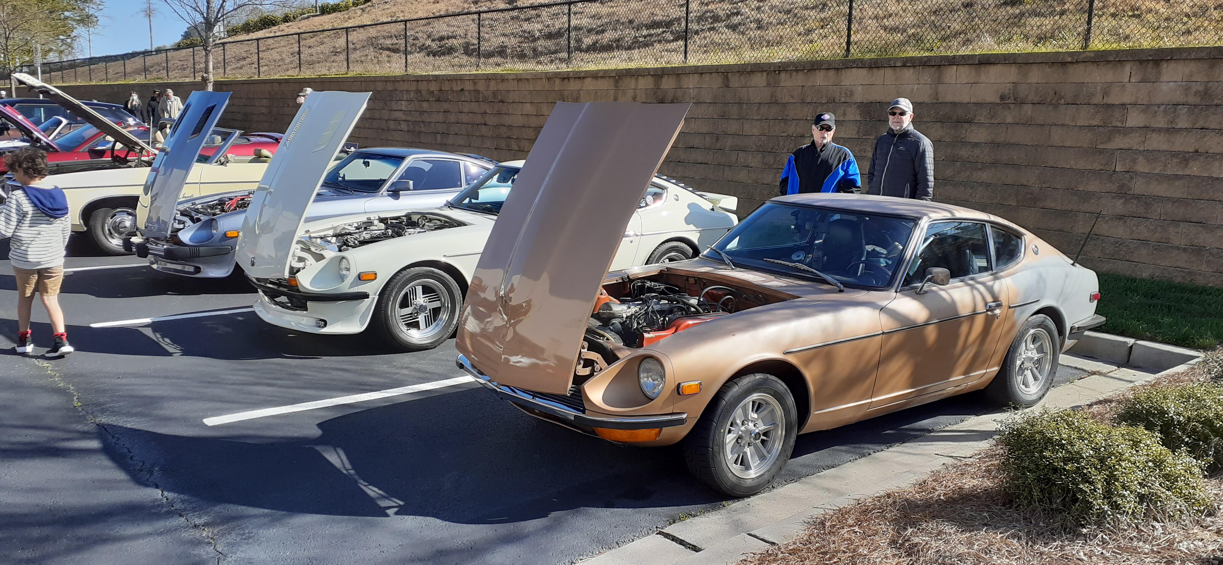

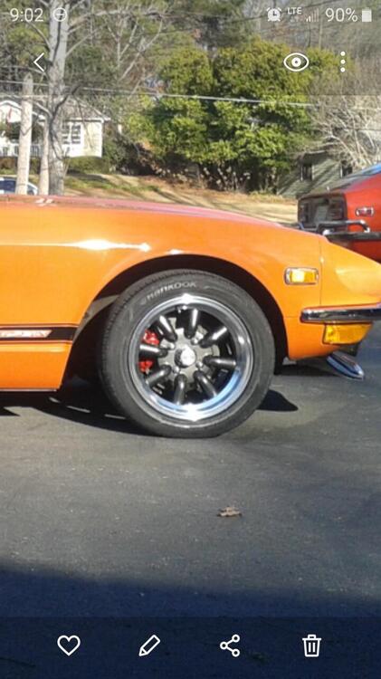

July 7, 20222 yr comment_642115 I have 195/60 R14 in the Falkens. That would be close to the same size as the 205/50 R15. My car is on the left. It has stock springs and very old struts. Here is more of a side view. Last photo While the gap may seem big, the traction is very good. Link to comment https://www.classiczcars.com/forums/topic/67615-15-tire-recommendations-for-2022/#findComment-642115 Share on other sites More sharing options...

July 7, 20222 yr Author comment_642142 On 7/7/2022 at 12:47 AM, SteveJ said: I have 195/60 R14 in the Falkens. That would be close to the same size as the 205/50 R15. My car is on the left. It has stock springs and very old struts. Here is more of a side view. Last photo While the gap may seem big, the traction is very good. Thanks for the pics, they are very helpful. Link to comment https://www.classiczcars.com/forums/topic/67615-15-tire-recommendations-for-2022/#findComment-642142 Share on other sites More sharing options...

July 7, 20222 yr comment_642144 On 7/7/2022 at 5:11 PM, Marty Rogan said: I just noticed a typo. I meant to say I was concerned with the gap on a 50 series tire. We knew what you meant. I knew the Falkens were smaller than the Radial TAs I pulled off the wheels, and the visual did surprise me at first. However, when I'm behind the wheel with tires that grip well, I don't worry about it in the least. 🙂 Link to comment https://www.classiczcars.com/forums/topic/67615-15-tire-recommendations-for-2022/#findComment-642144 Share on other sites More sharing options...
