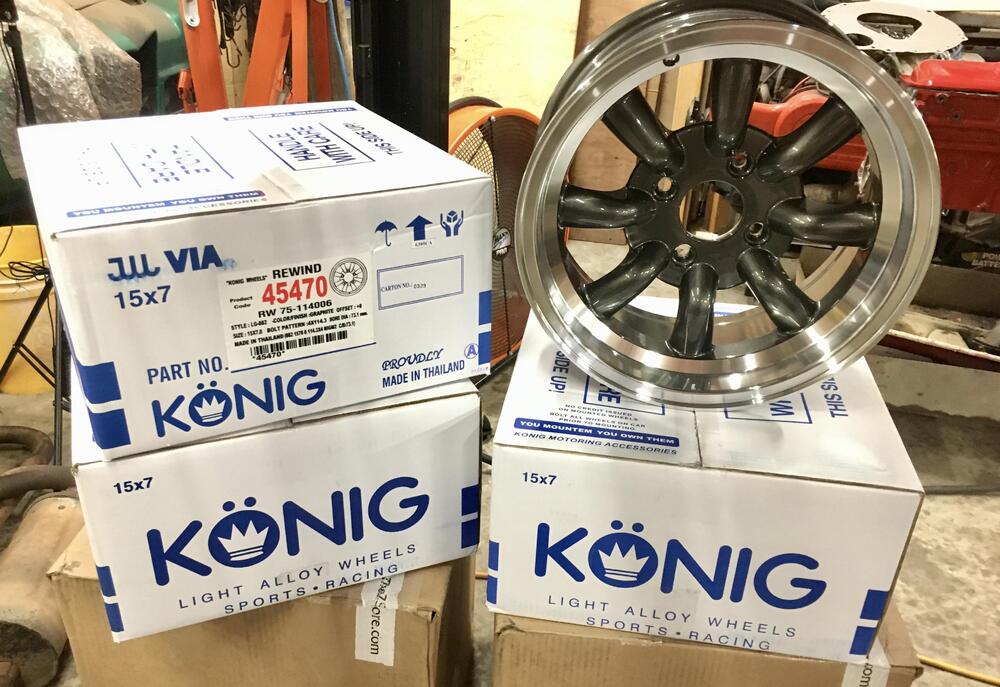

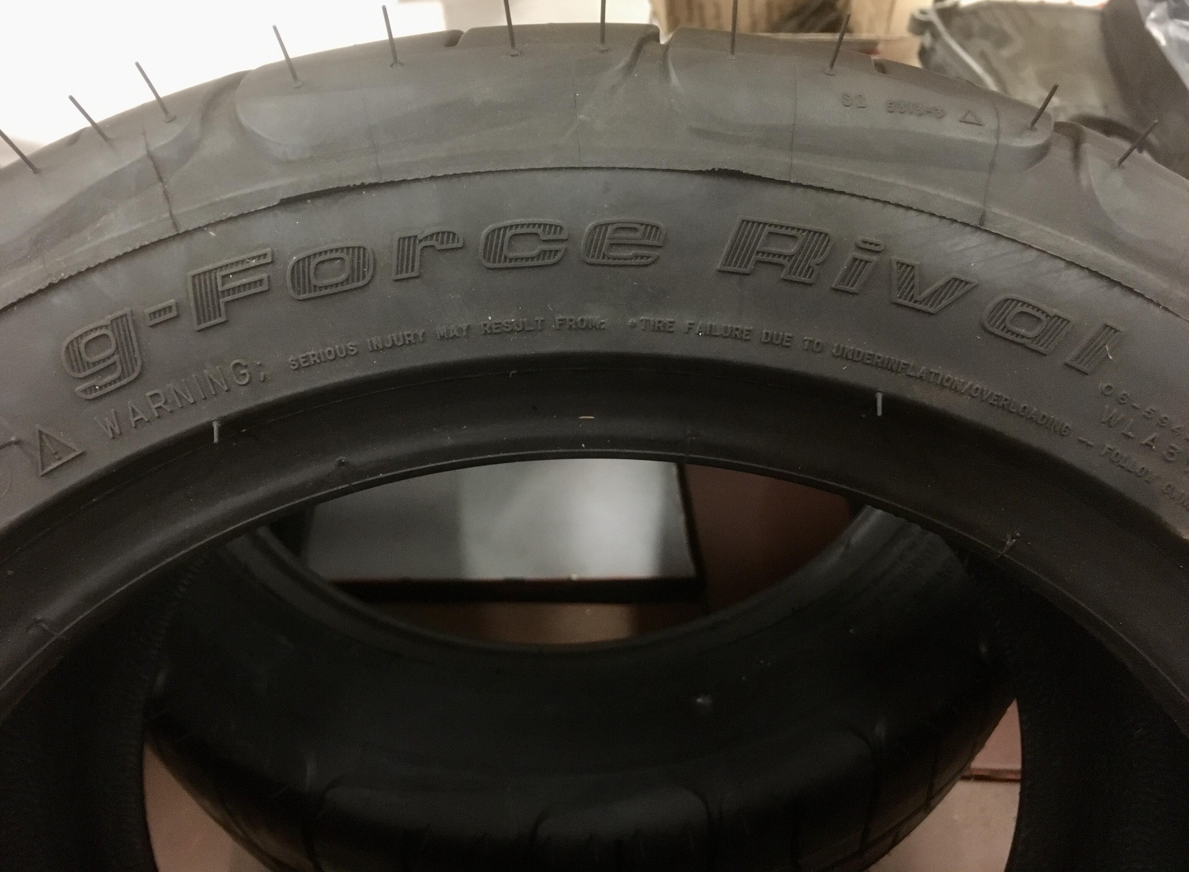

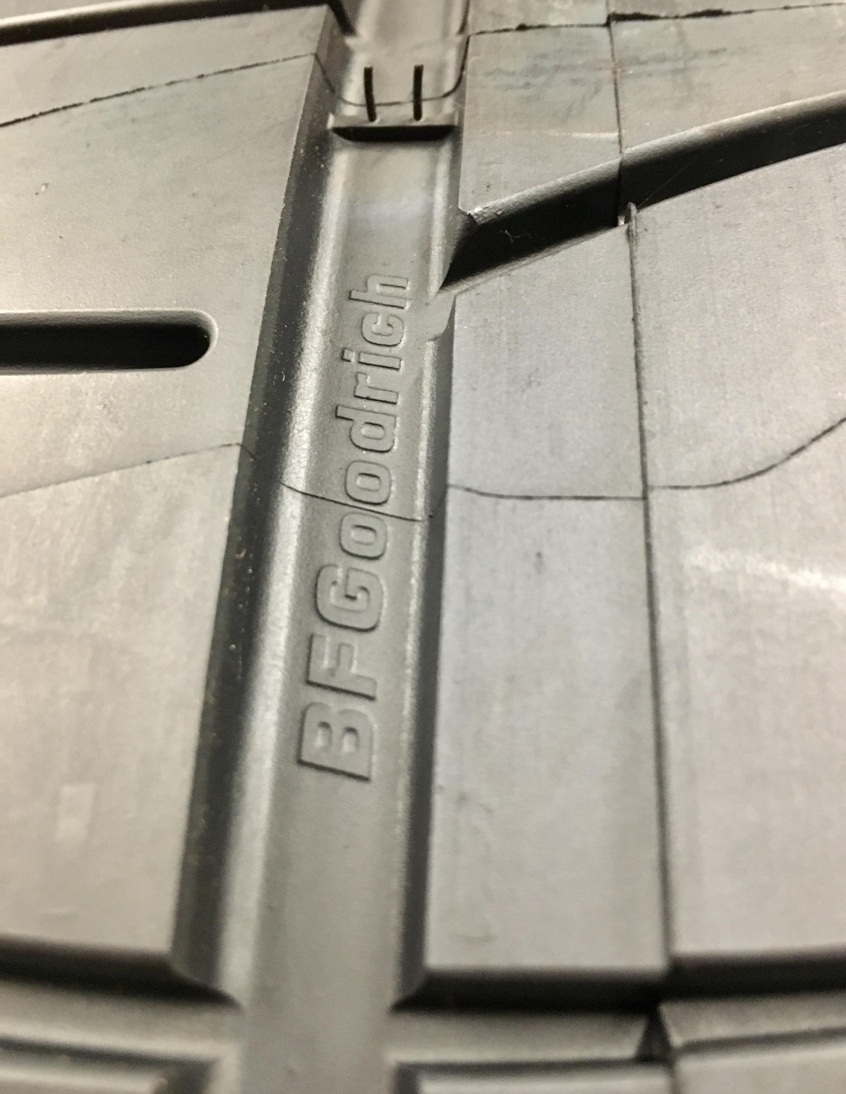

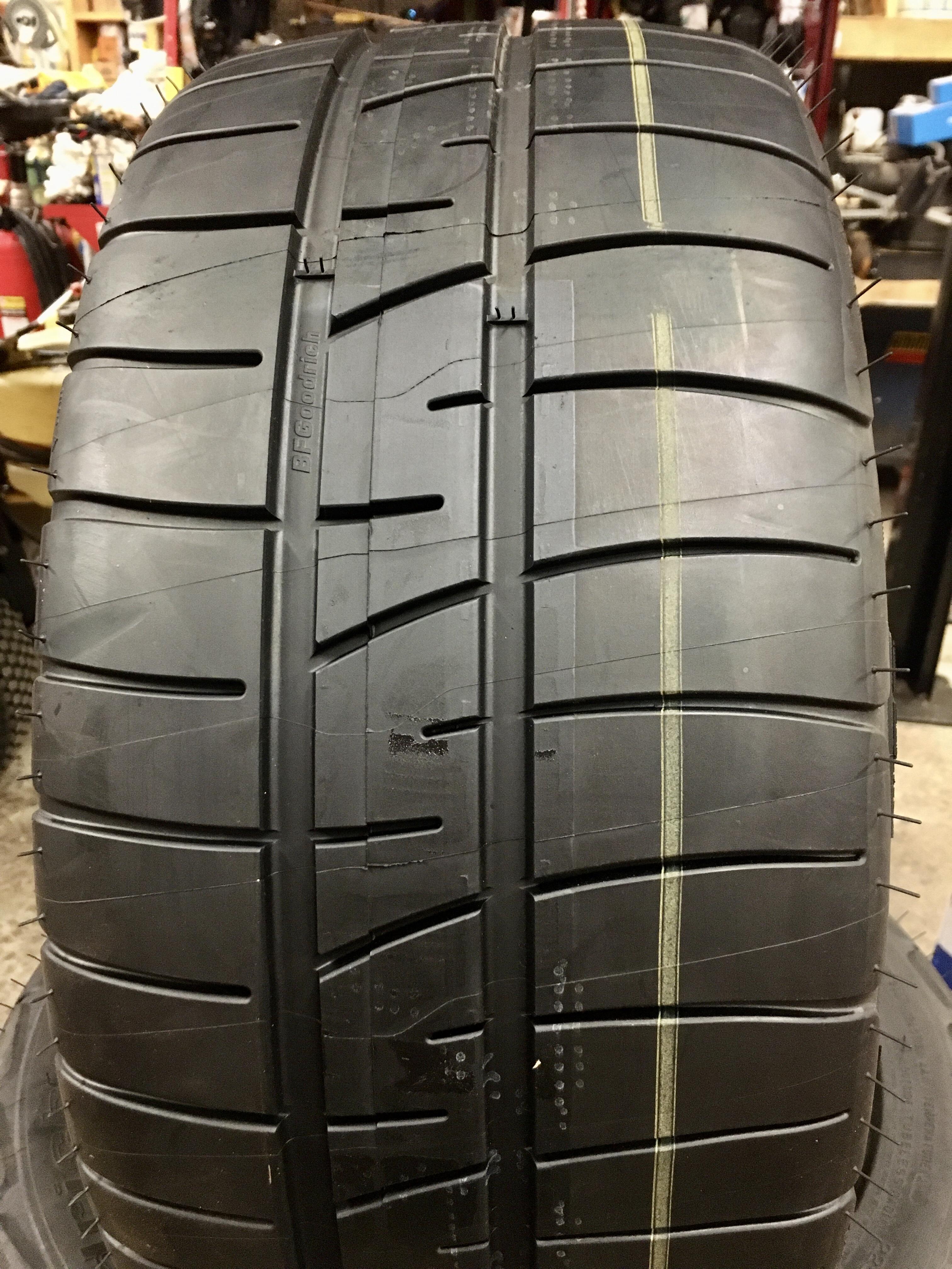

I don’t have them mounted yet, but I picked up a set of BF Goodrich tires recently for one of my Z cars. I also picked up a set of Konig Rewind wheels. I’m thinking it will be a perfect combination for my  Z.

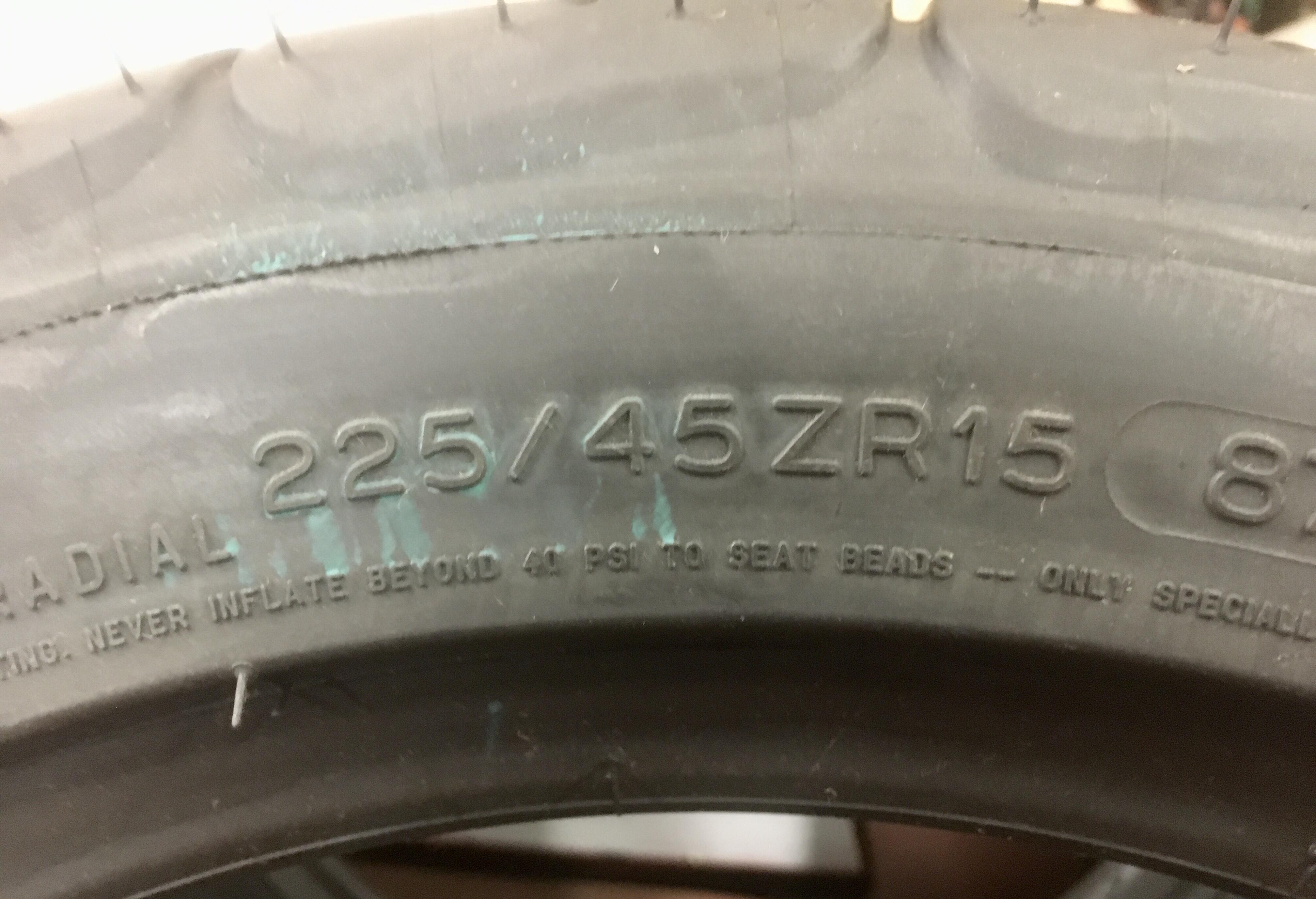

On 7/7/2022 at 2:51 PM, Patcon said:
What size are your BFG's?
225/45ZR15.
They are close to the same overall diameter as the Hoosier tires I run on the race Z, and about the same width.
