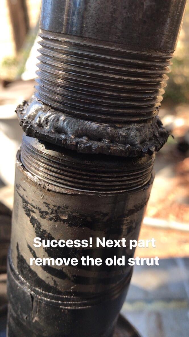

I welded another pipe to the top of the gland nut, then used a pipe wrench on the welded pipe, the heat from welding helped.
The gland nut does not have much surface area to put the torque down...
New struts should have new gland nuts.
