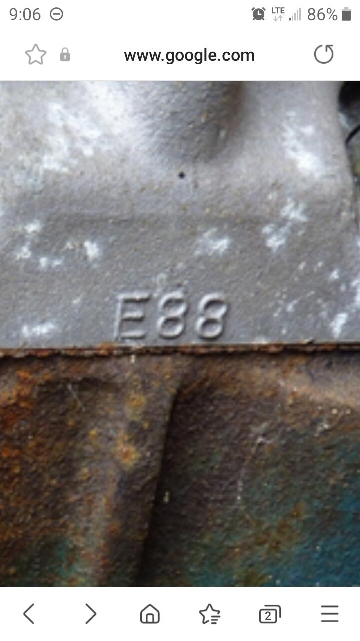

I have an E88 with no camshaft installed.

I have absolutely NO idea what the difference in the heads are other than the P90 I think is used for Turbo setup which this IS NOT.
