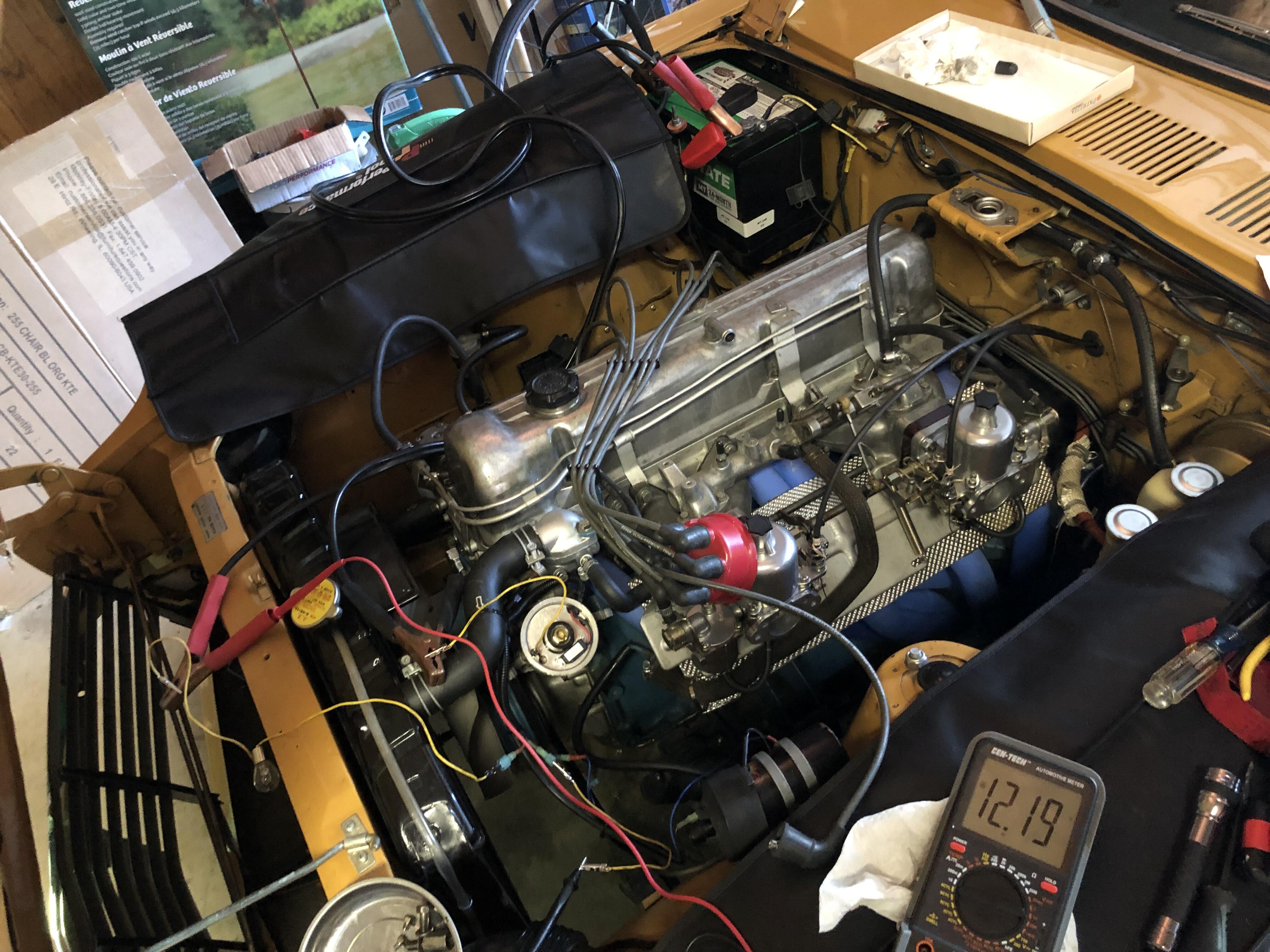

July 17, 20222 yr comment_642536 I found a test method for the module itself on Summit Racing's site. Worth reading... https://static.summitracing.com/global/images/instructions/pnx ignitor i tests.pdf Link to comment https://www.classiczcars.com/forums/topic/67640-timing-off-runs-bad/?&page=4#findComment-642536 Share on other sites More sharing options...

July 17, 20222 yr comment_642538 You can see by their diagram that the module grounds through the distributor body and the mounting screws to get to the engine block and complete the circuit . Might be that by loosening all of the various mounting bolts you lost your ground. Attach a wire directly from the distributor body if you want to be sure the module has a good ground. It's actually the most important one for spark strength. Link to comment https://www.classiczcars.com/forums/topic/67640-timing-off-runs-bad/?&page=4#findComment-642538 Share on other sites More sharing options...
July 17, 20222 yr Author comment_642539 Zed Head: Thank you for the testing information. Performed the test and power is constant. Also did the test with the cap on, with same results. So it looks like the module has quit. The photo shows my rigged up test and meter reading. I can think of two instances where it may have been damaged. 1. I did a test drive to adjust timing with the new carbs. I pulled to the road side and turned on my flashers, which caused my amp meter to go wild. It then blew the 20 amp fuse. 2. After the flashers quit, I drove home and used the right turn signal, which caused the engine to die. Got it restarted, but had no gauges or brake lights on the drive home. Another 20 amp fuse blew. Never had fuse problems before. After replacing the fuses, the flashers and turn signals work fine. FYI, I have cleaned up all my switches in the past couple years (2K miles), so they should be fine. So where does this leave me? 1. Purchase another Pertronix version 1 or, 2. Purchase stock 240Z distributor and install Pertronix or, 3. Purchase a stock 280ZX distributor, which includes electronic ignition. Part stores have rebuilt units for about $160. I guess I can do more research, but these are some questions I would need to answer too: Will my current rotor and cap fit these different distributors? My current Pertronix set-up bypasses the ballast resistor and uses a 3 Ohm coil. Will I need to install a stock coil and hook up the ballast resistor? Link to comment https://www.classiczcars.com/forums/topic/67640-timing-off-runs-bad/?&page=4#findComment-642539 Share on other sites More sharing options...
