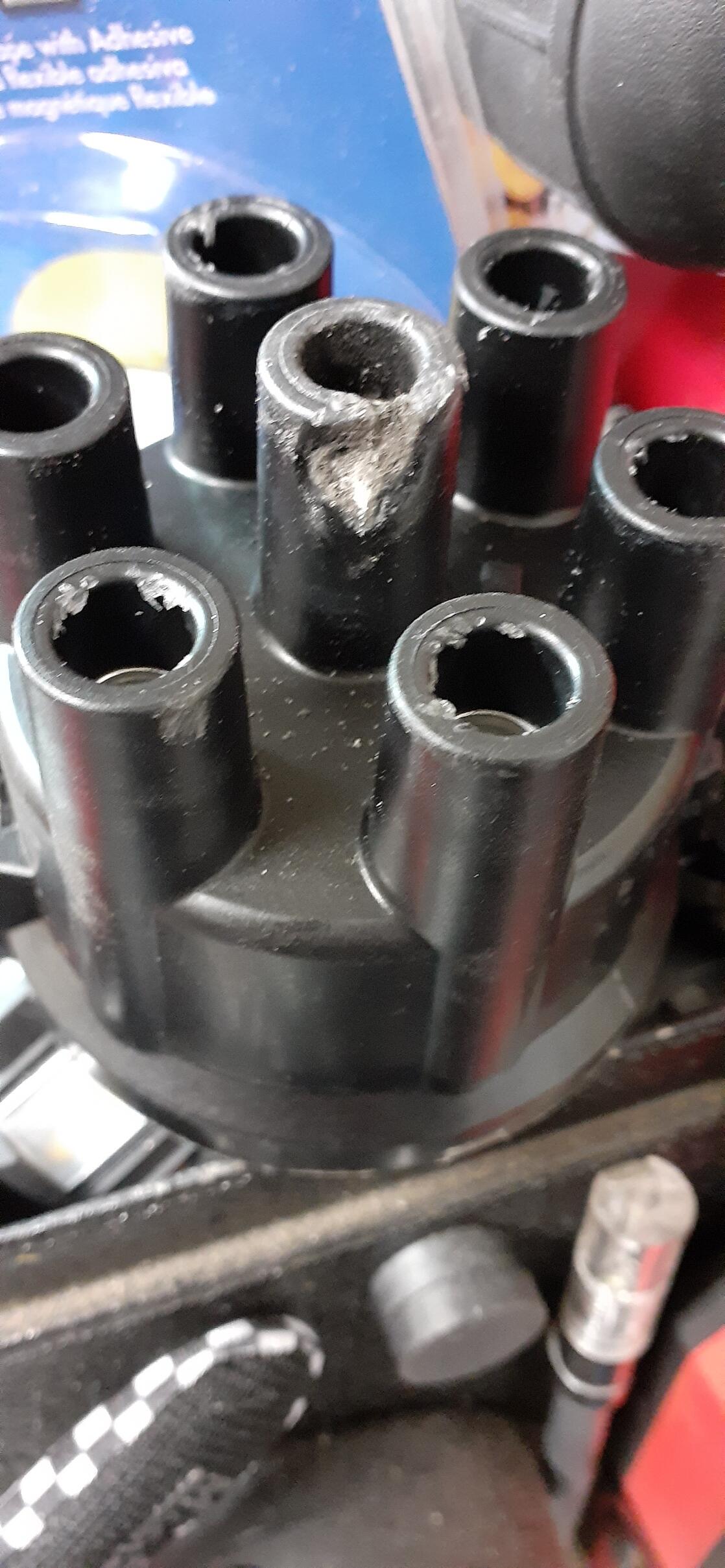

Engine ran great for 15 minutes yesterday with distributor at full retard, but today I'm experiencing the same blowback while trying to start it.
The only thing I did was switch a few plug wires because they were touching the cam/valve cover.  Had difficulty inserting the wire ends into the new distributor cap, so a couple got mangled a bit.  There appears to be a little lip between the plastic and metal inside the female insert on the cap, which catches the male wire end. I thought I fixed the wire ends pretty well, so not sure what to fix/replace now.

Make sure your plug wires are seated firmly in the cap and on the plug. If they are not pushed down far enough, you can ruin your cap. Been there, done that. (And found it in the past on my 260Z when I was buying it. Since it "wasn't running", the seller knocked off $700. I just had to replace the cap.)

My wires were Bosch 7MM that looked new when I purchased the car in 2019 (3500 miles ago). Have upgraded/fixed everything else, so I should have replaced the wires earlier.  By surprise, the Bosch wire ends separated from the boot as I removed them from the Mallory cap and transferred them to the OEM cap, which did not go well.

Installed new NGK plug wires, OEM cap and NGK plugs, but I’m still noticing “kickback”.  More kickback at at Advance/Retard mid-point and less at full Retard.
