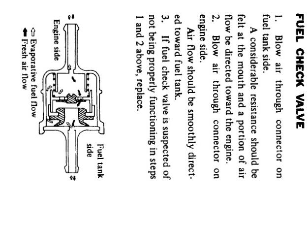

74 didn't have one of these, right?
No idea why that's sideways. It's not sideways in native format...
I skimmed through the EF section of the 74 FSM. I didn't see that valve, and it wasn't described in the theory of operation on EF-32.

I think that image is sideways to permit fuel to drain back into the tank:)
