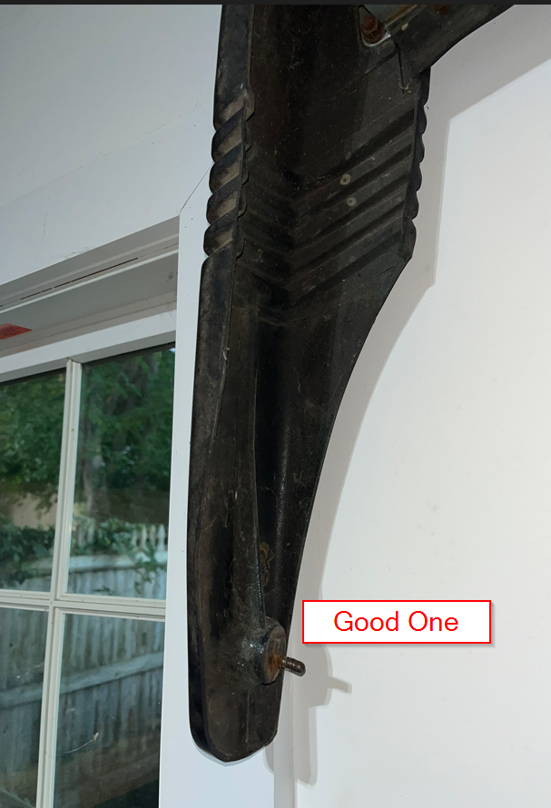

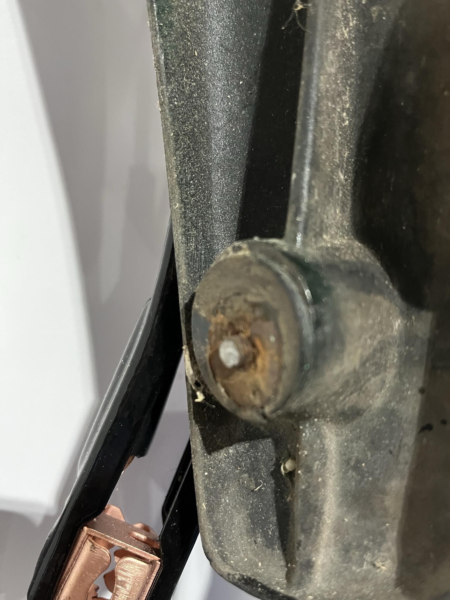

I started putting my front bumper back on the car and I noticed I have a problem with a broken bolt.  Does anyone know how I can fix this? I really do not want to have to buy a replacement.

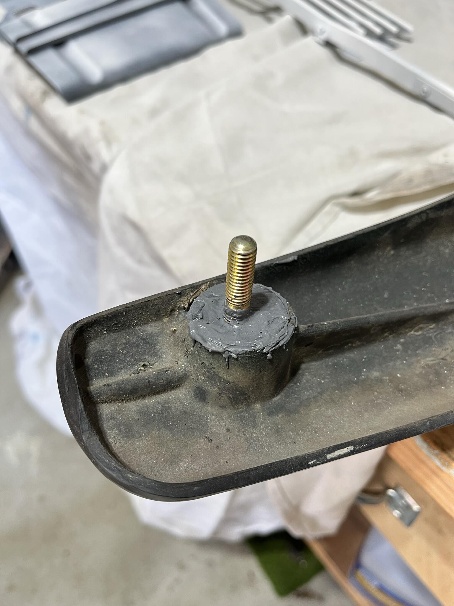

Yeah. unfortunately that stud was molded into the rubber of the bumper end when it was molded at the factory.

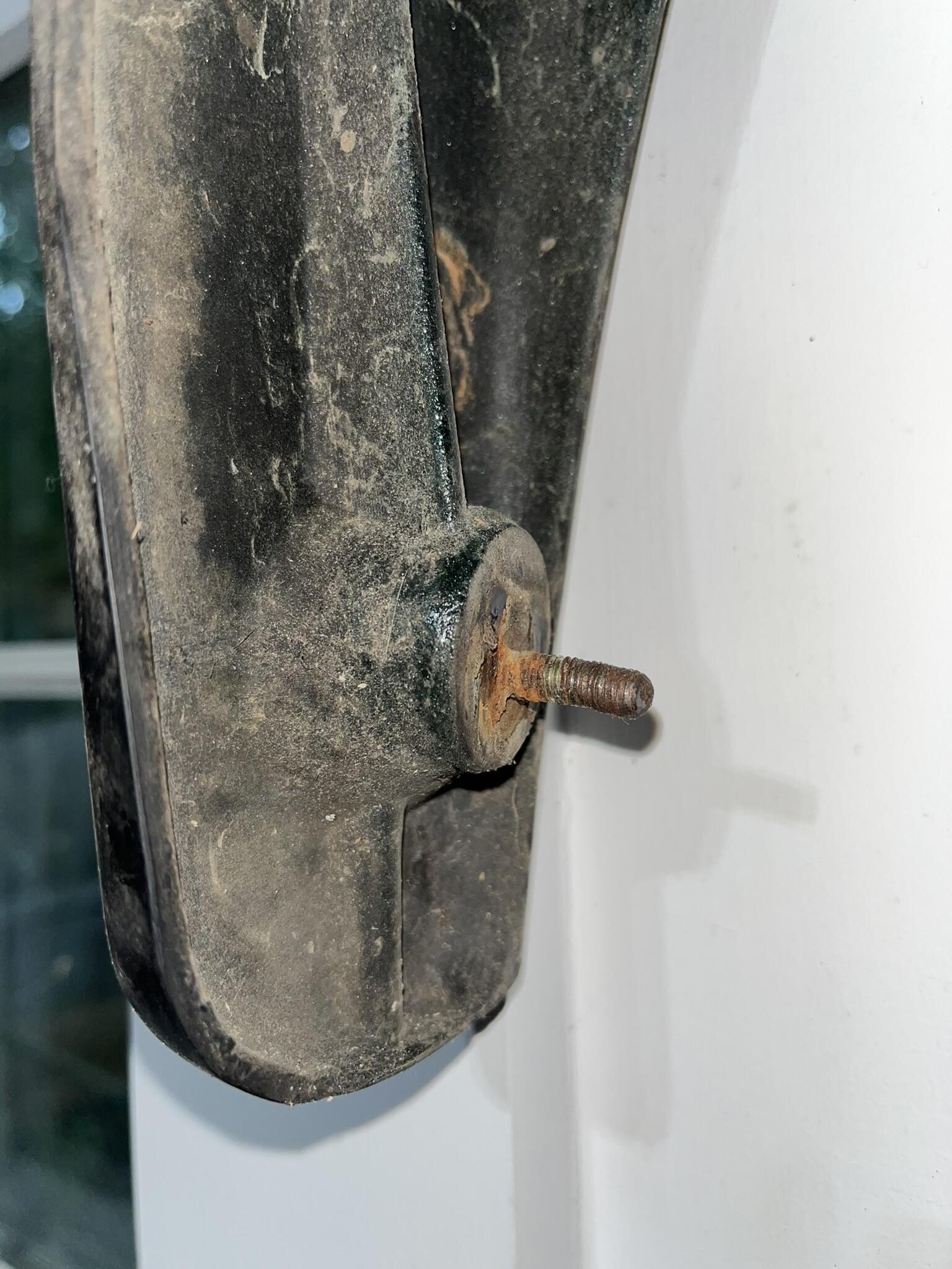

As Patcon suggested, about the only thing you could do now is grind it all out and glue something in as a replacement. And once you've gotten good at it by practicing on your bad one, I'd do your "good one" too, cause it looks like it's not long for this world either.   :excl:
