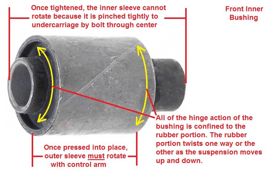

When i tighten the bolt for the lower control arm it pinches the bushing preventing it to move. It needs to move, preventing the rubber from tearing.

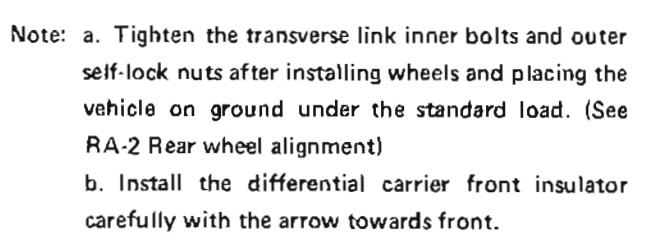

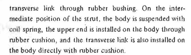

The Nissan bushing does not move/spin.  It flexes.  That's why you're supposed to tighten the bolt with the car on the ground.
Ok you tighten on the ground, then it goes on a lift with wheel hanging or lots of suspension travel. I dont think the rubber was designed for torsion, was made for radial load.
