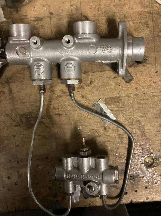

Seem to be having an issue with brakes getting too hot, on my 12/70 Z.  This occurs when barely using them. The front rotors get very hot, so much that the wheel hub is almost to hot to touch. While the rear drums get a bit warm. This happens after a short drive, 10-15 miles. Car will easily roll without resistance.
I have the early style original Tokico m/c (recently installed) and Nabco differential brake switch. Car previously had a Sanyco m/c, which I swapped out for the original.
So is it normal for brakes to be hot, when not using them?

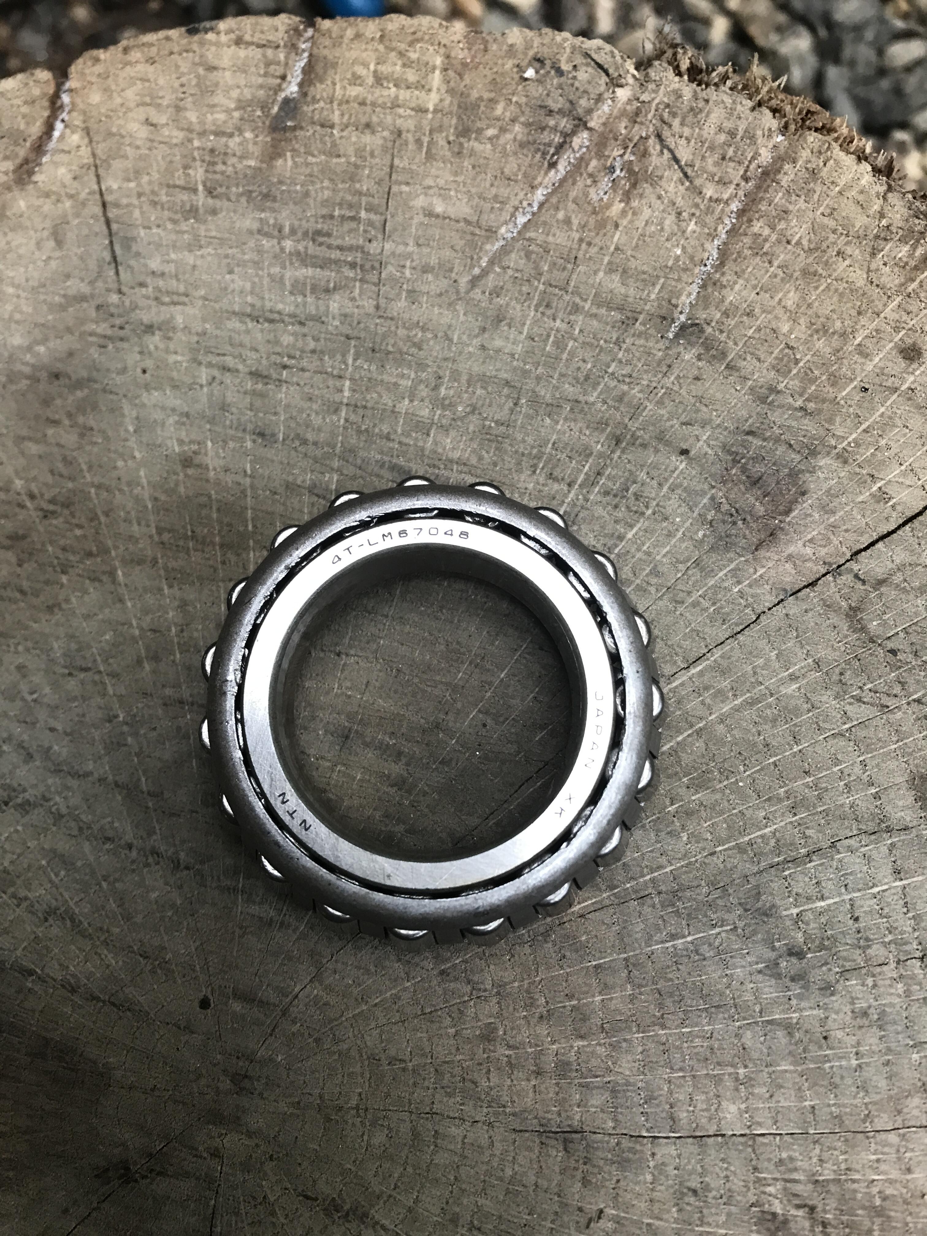

 That's quite a bit of wheel rotation for the problem to be the brakes. I'd jack up a front corner, grab the the top and bottom of the tire and push on the top while pulling out the bottom, then reverse the direction several times. If you can feel any looseness take a look at the wheel bearing and check to see if it's just loose or trashed.

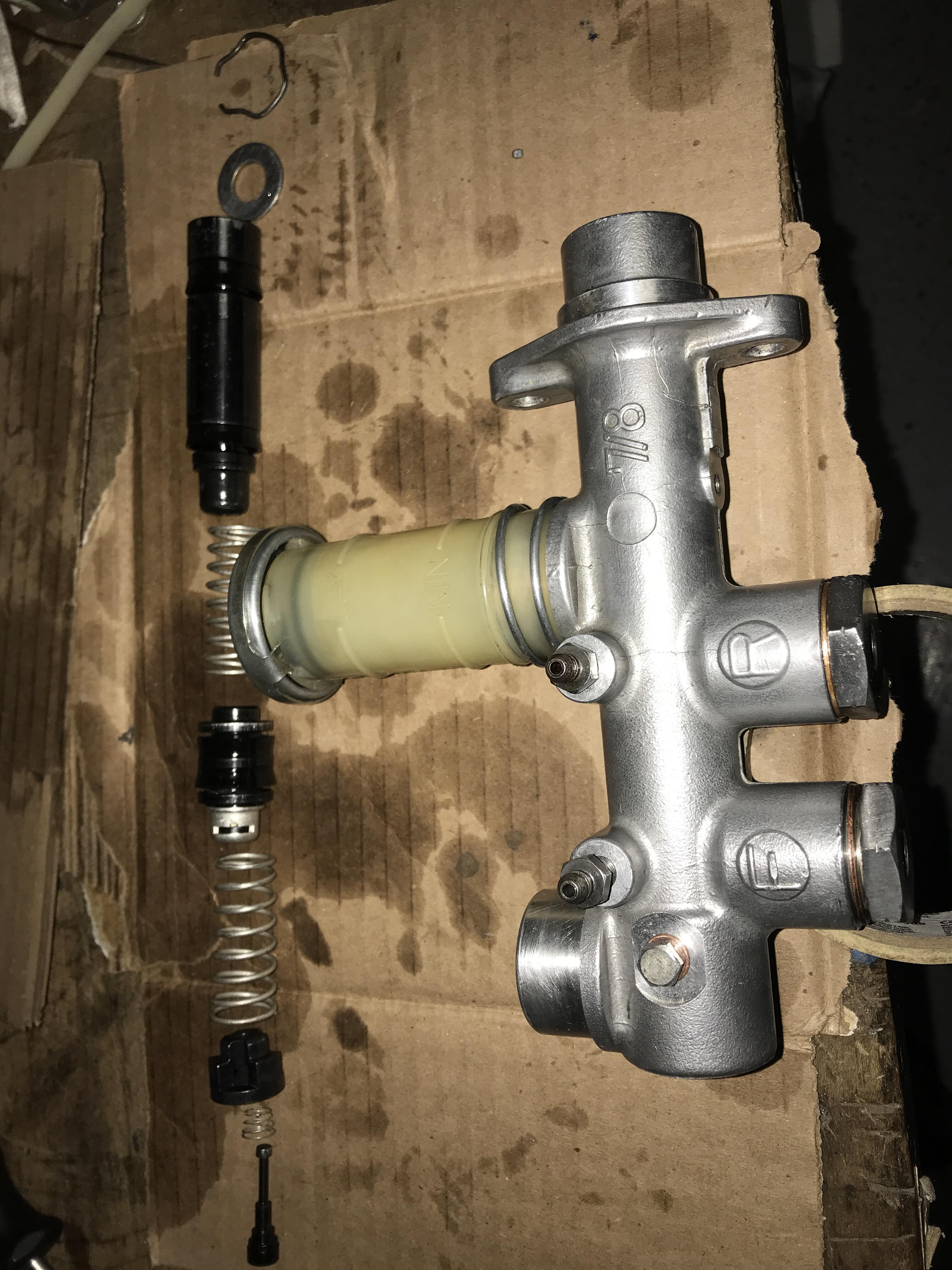

You said you recently changed the master cylinder.

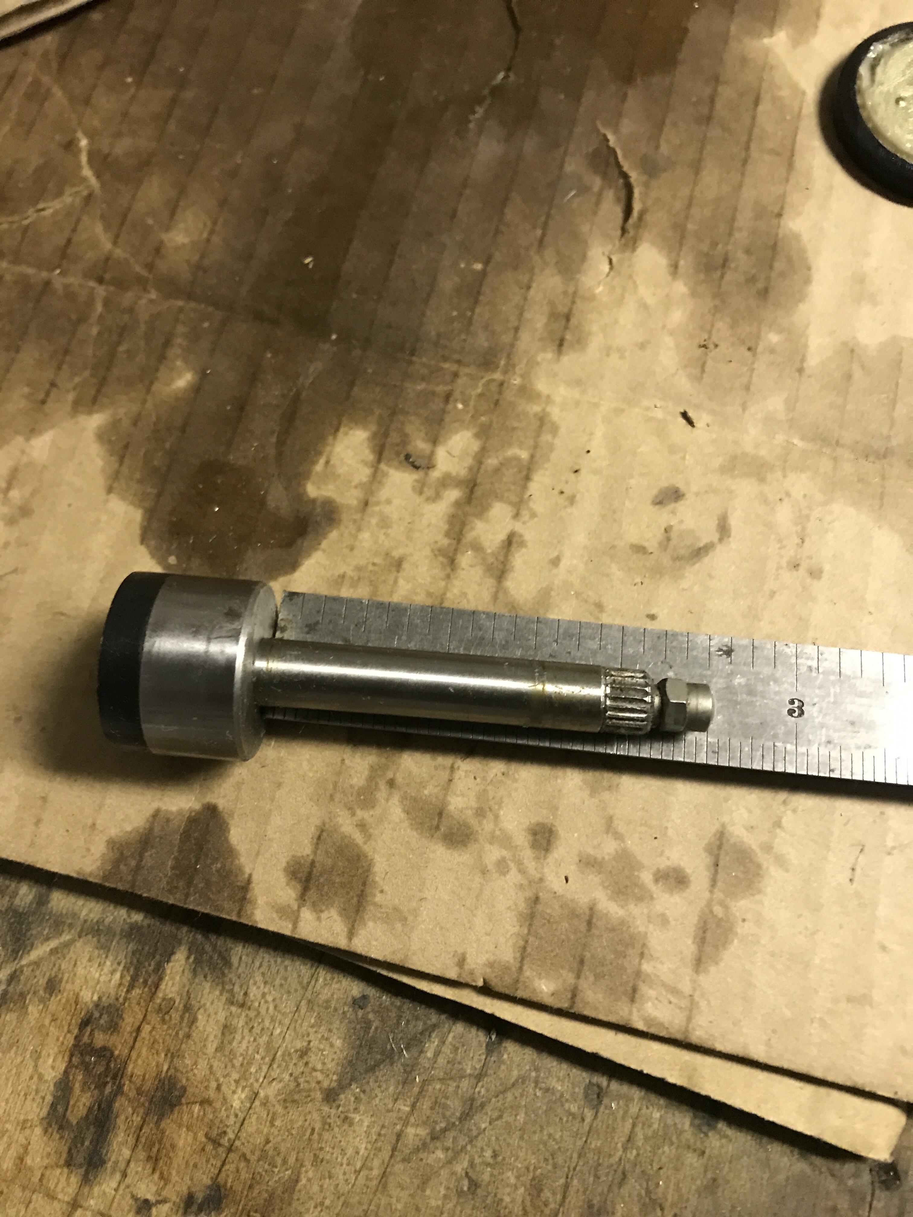

Did you check and adjust the vacuum booster pushrod? There needs to be about 0.020” clearance between the booster pushrod and the cup inside the master cylinder piston.
If the gap is too large, there will be excessive pedal travel and the brakes will feel soft.
Not enough gap, and the vacuum booster will be partially applying the brakes, causing them to drag, and heat up.

Yes, as stated above push rod was set at 3.5mm (within factory spec).  Am using a thinner reaction disk.  OEM was about 1/4” thick, made one 1/8”, pedal travel is ok.
