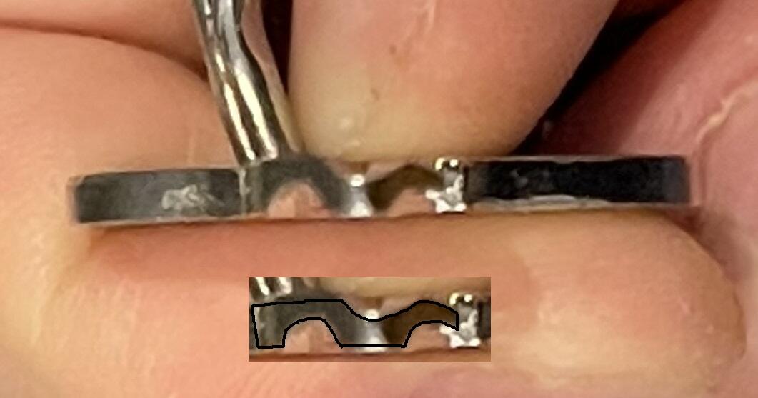

Wondering if any folks knew the codes associated with the blanks for this common, not original ignition switch replacement . Keys are labeled car show with a unique identifier C23425? I noticed there are a lot of custom key blanks for the originals, but I wasn’t able to dig up if these are made for a bluebird or a 510 . ( note there is no door alarm functionality in this unit ). Any help is appreciated !E15ACAFD-17BE-4541-BDD0-0A0E7541C85E.jpeg

But about your key blank and trying to use one of those titanium keys... Those TI keys are all for the double sided cut and there's no way they will fit your cylinder. Regardless which blank your lock uses, it's a single side cut and those TI blanks are for the newer double side cut.
When they describe blanks, they look at the cross section profile from the part you hold in your fingers (they call it the "bow"). And if I modify your pic and flip it around so you are looking at that profile from the bow, it looks like this:
And that still looks like an X1 / MZ12 or DA20 / D80K.to me.
