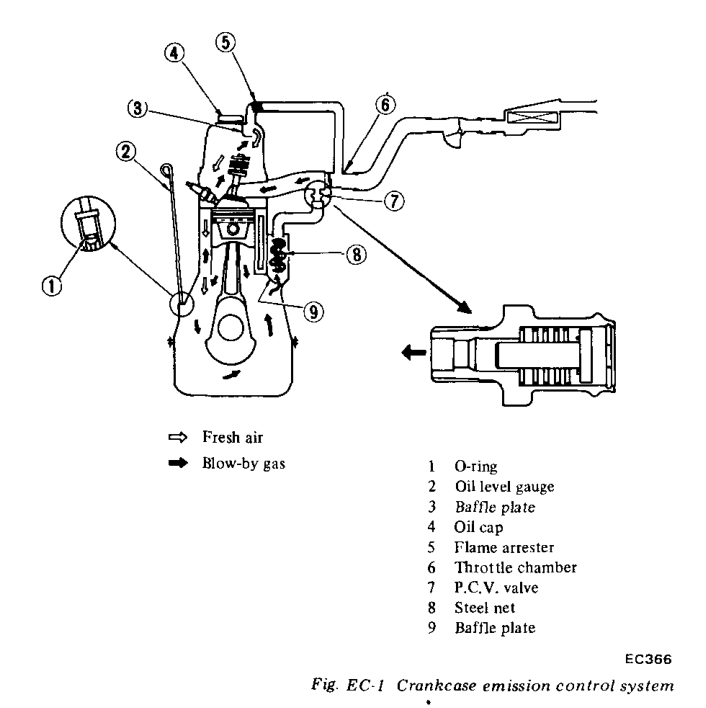

Update for you guys.  The PCV valve even though its a few weeks old very much is letting air in both directions not to mention the pcv hose is apparently split towards the top.  He's going to get a replacement valve and snip off the torn portion of the hose.
When I hear how it went I'll update you all.  Thanks so far

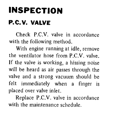

I spoke with him and he bought a brand new valve but said he could blow through both sides there too.  He read later on that blowing into these doesn't tell you anything, you have to suck on it to get an actual answer of if its bad or not - is that correct?
This is the most likely cause of the noise.  The system is not "intact".  During normal operation of an engine with normal blowby there won't be very much flow through the valve.  Just enough to clear out the gases.
