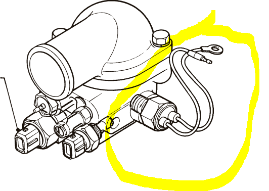

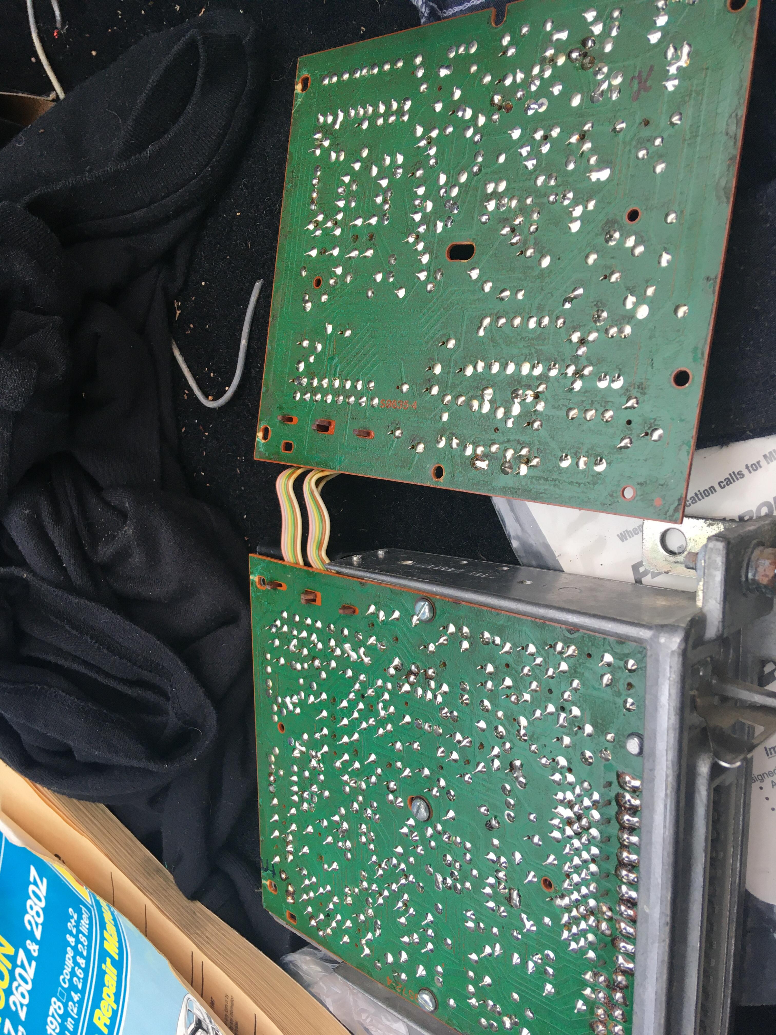

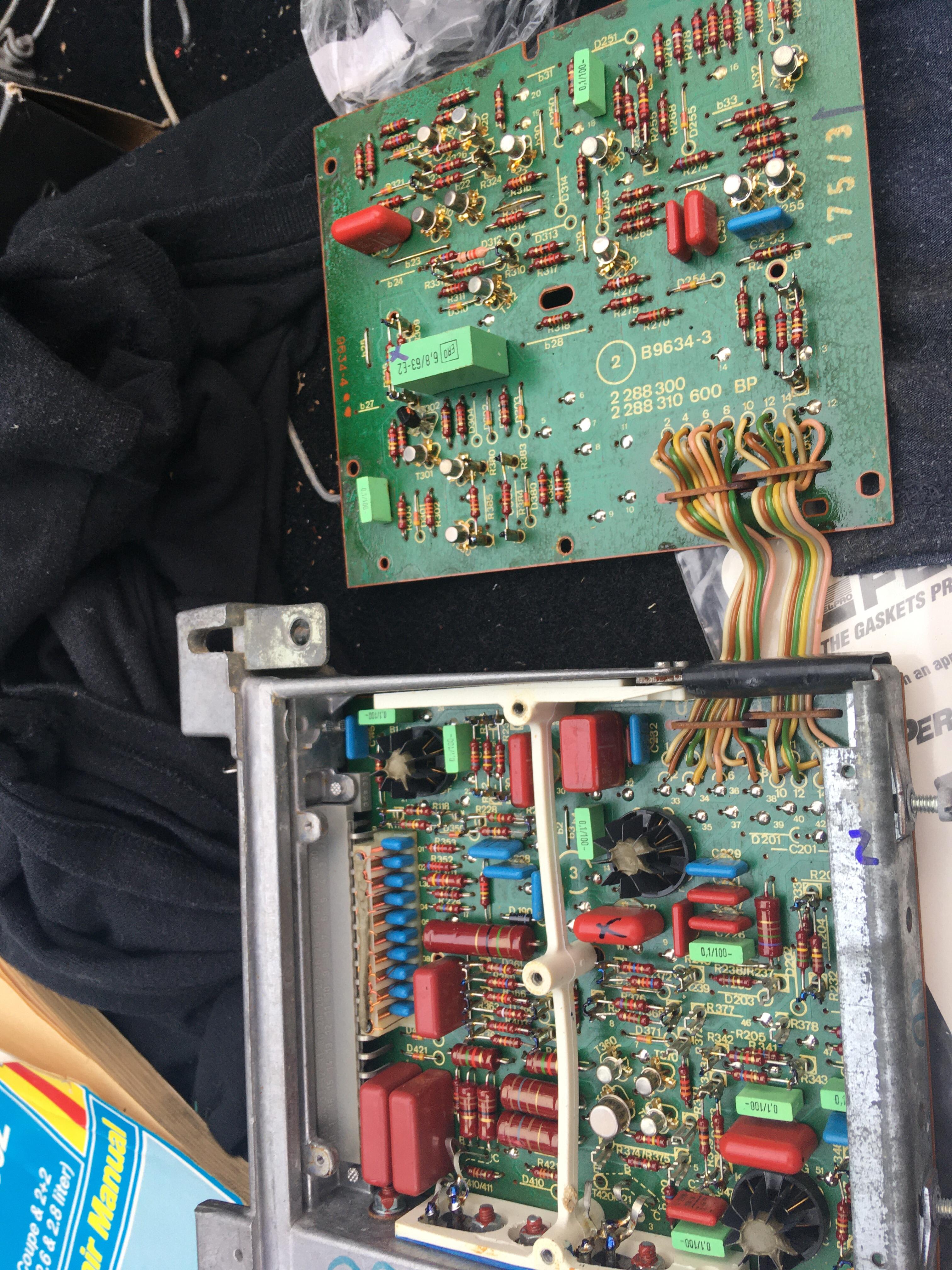

August 21, 20222 yr Author comment_644300 33 minutes ago, Zed Head said: Are you sure the AFM is plugged in? You can check at the ECU connector. That's actually the best place anyway. I'd say try the fuel tweaker but if it won't rev with no load then it's probably not seeing the AFM signal. Also, you might pop the black cover on the AFM and be sure the vane is moving when the throttle opens. Quick and easy. If the vane doesn't move the ECU doesn't add fuel. Here's the tweaker for future ref - http://www.atlanticz.ca/zclub/techtips/tempsensorpot/index.html We tried that one already and all the ECU connector tests in the fuel injection bible but everything checks out correctly. We know the AFM is working because if we turn the large gear inside the afm the air fuel gauge’s numbers change, so it is working. We did take the ecu out and it does have some brown dried liquid on it if that means anything. here are some pictures if it helps. I also attached an image of a sensor not on my 78 either just in case that has anything to do with it. It sits on the thermostat mount below the fuel rail. Link to comment https://www.classiczcars.com/forums/topic/67750-strange-intake-noise/?&page=4#findComment-644300 Share on other sites More sharing options...
August 21, 20222 yr comment_644302 Open the AFM vane before you open the throttle it should rev because of the extra fuel if it's a fuel problem. You didn't say that the vane actually moves with air flow. Maybe it moves a little and stops. Might be that the AMF is not right now. Work and work right are not the same thing. 14 minutes ago, chaseincats said: We know the AFM is working because if we turn the large gear inside the afm the air fuel gauge’s numbers change, so it is working. We did take the ecu out and it does have some brown dried liquid on it if that means anything. Link to comment https://www.classiczcars.com/forums/topic/67750-strange-intake-noise/?&page=4#findComment-644302 Share on other sites More sharing options...

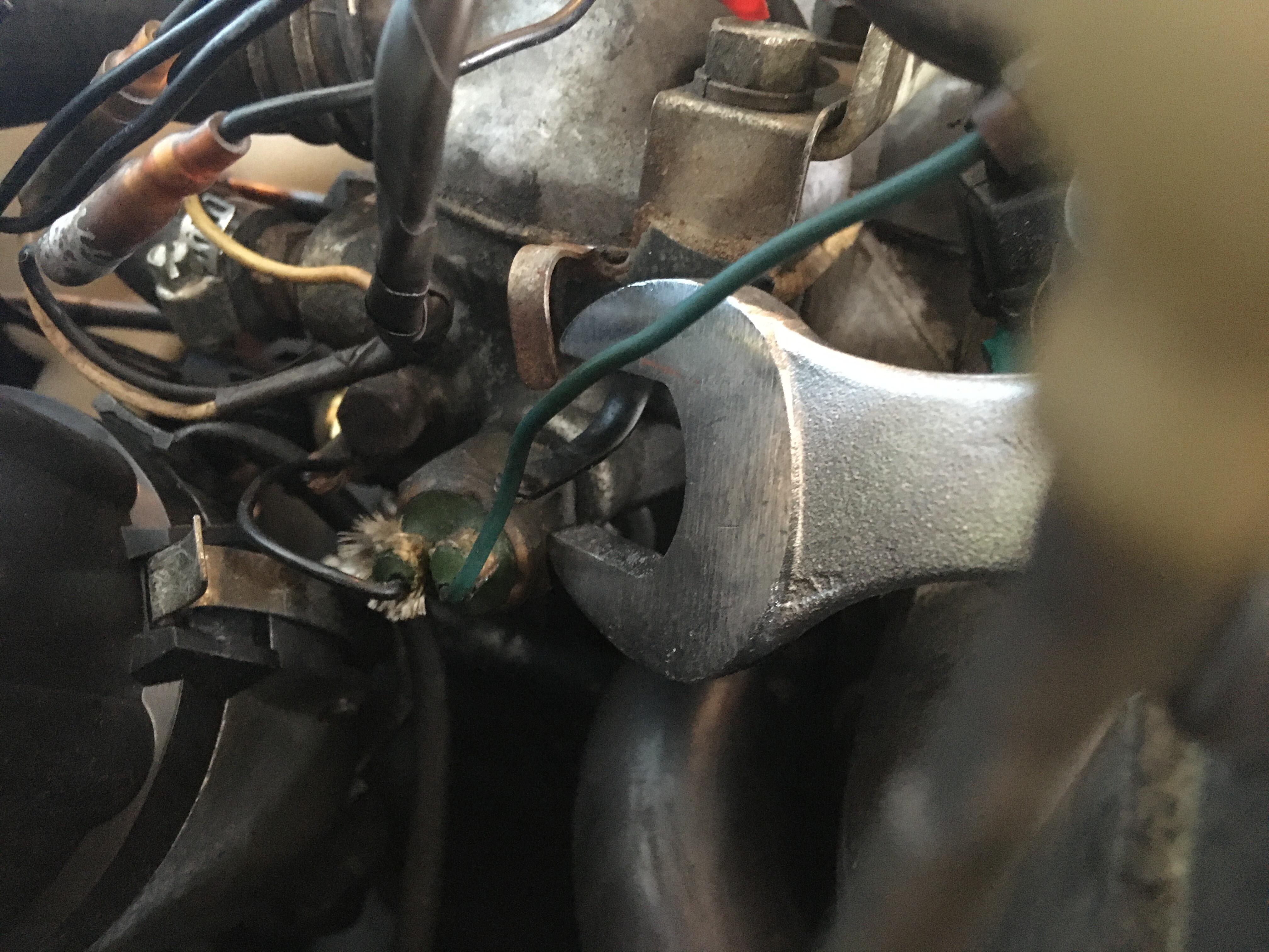

August 23, 20222 yr Author comment_644398 On 8/20/2022 at 7:43 PM, Zed Head said: Open the AFM vane before you open the throttle it should rev because of the extra fuel if it's a fuel problem. You didn't say that the vane actually moves with air flow. Maybe it moves a little and stops. Might be that the AMF is not right now. Work and work right are not the same thing. We noticed the water temp switch was unplugged, and when plugged in the car ran way better. He is not using the transistor ignition module, so why would the car run differently with this hooked up as I thought that was only tied to the stock ignition system. Any ideas? Edited August 23, 20222 yr by chaseincats Link to comment https://www.classiczcars.com/forums/topic/67750-strange-intake-noise/?&page=4#findComment-644398 Share on other sites More sharing options...
August 23, 20222 yr comment_644404 3 hours ago, chaseincats said: We noticed the water temp switch was unplugged, and when plugged in the car ran way better. He is not using the transistor ignition module, so why would the car run differently with this hooked up as I thought that was only tied to the stock ignition system. Any ideas? The ignition doesn't need to know the temperature, the fuel injection system does. Cold engine, enrich the mixture. Warm engine, lean it out. Link to comment https://www.classiczcars.com/forums/topic/67750-strange-intake-noise/?&page=4#findComment-644404 Share on other sites More sharing options...
August 23, 20222 yr comment_644414 11 hours ago, chaseincats said: We noticed the water temp switch was unplugged, and when plugged in the car ran way better. Any ideas? I did not pour over the 75 wiring diagram, but for other years, a temperature switch controlled things like ignition timing and EGR engagement. I understand that you're not running the original ignition module, but maybe somehow you're getting EGR pumped into the intake manifold when you shouldn't be? Just tossing out ideas. Link to comment https://www.classiczcars.com/forums/topic/67750-strange-intake-noise/?&page=4#findComment-644414 Share on other sites More sharing options...
