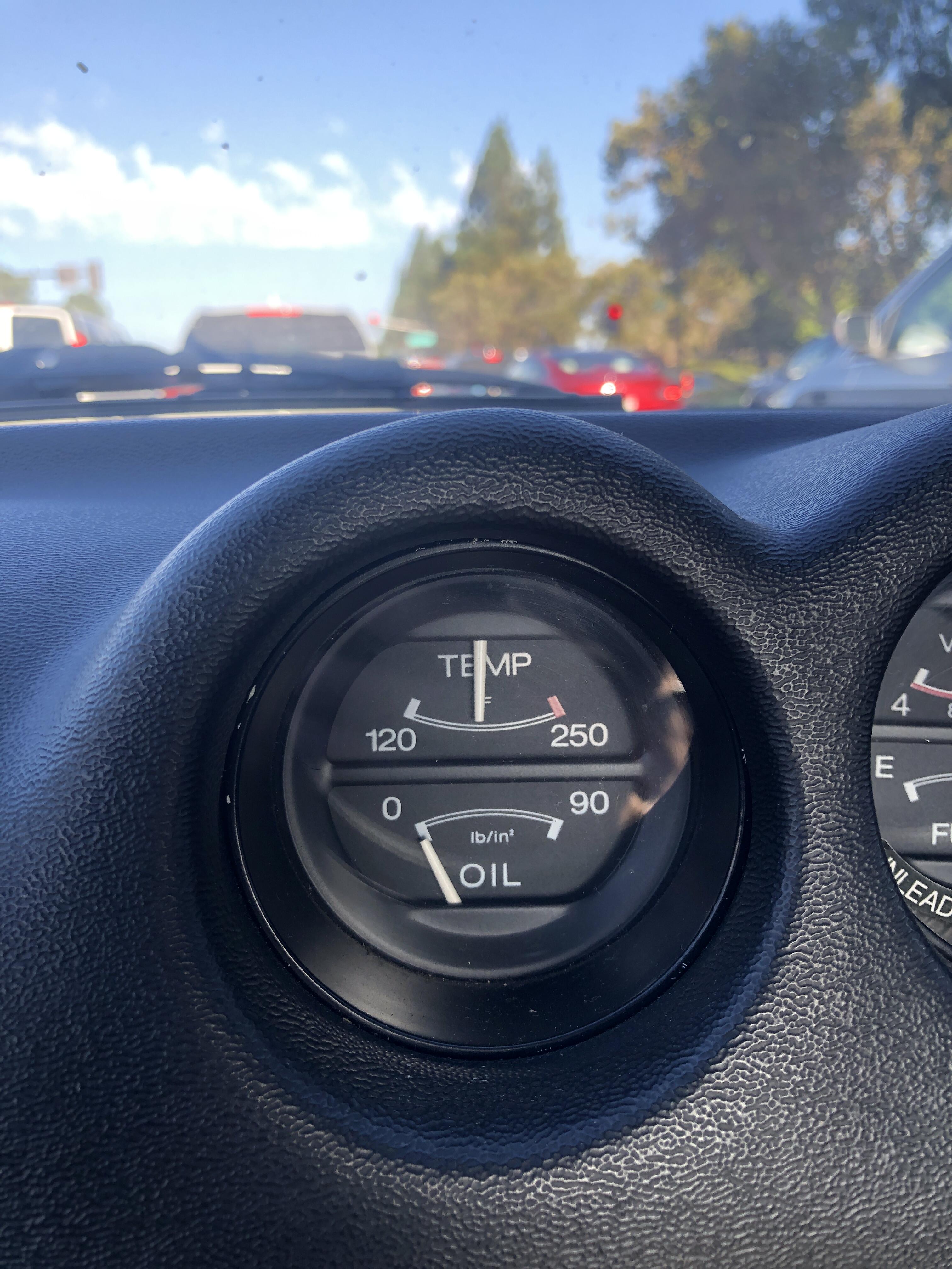

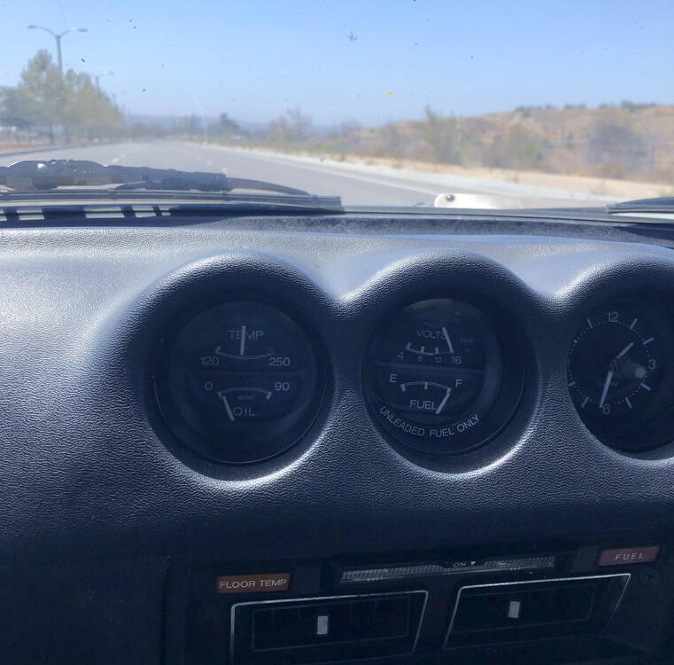

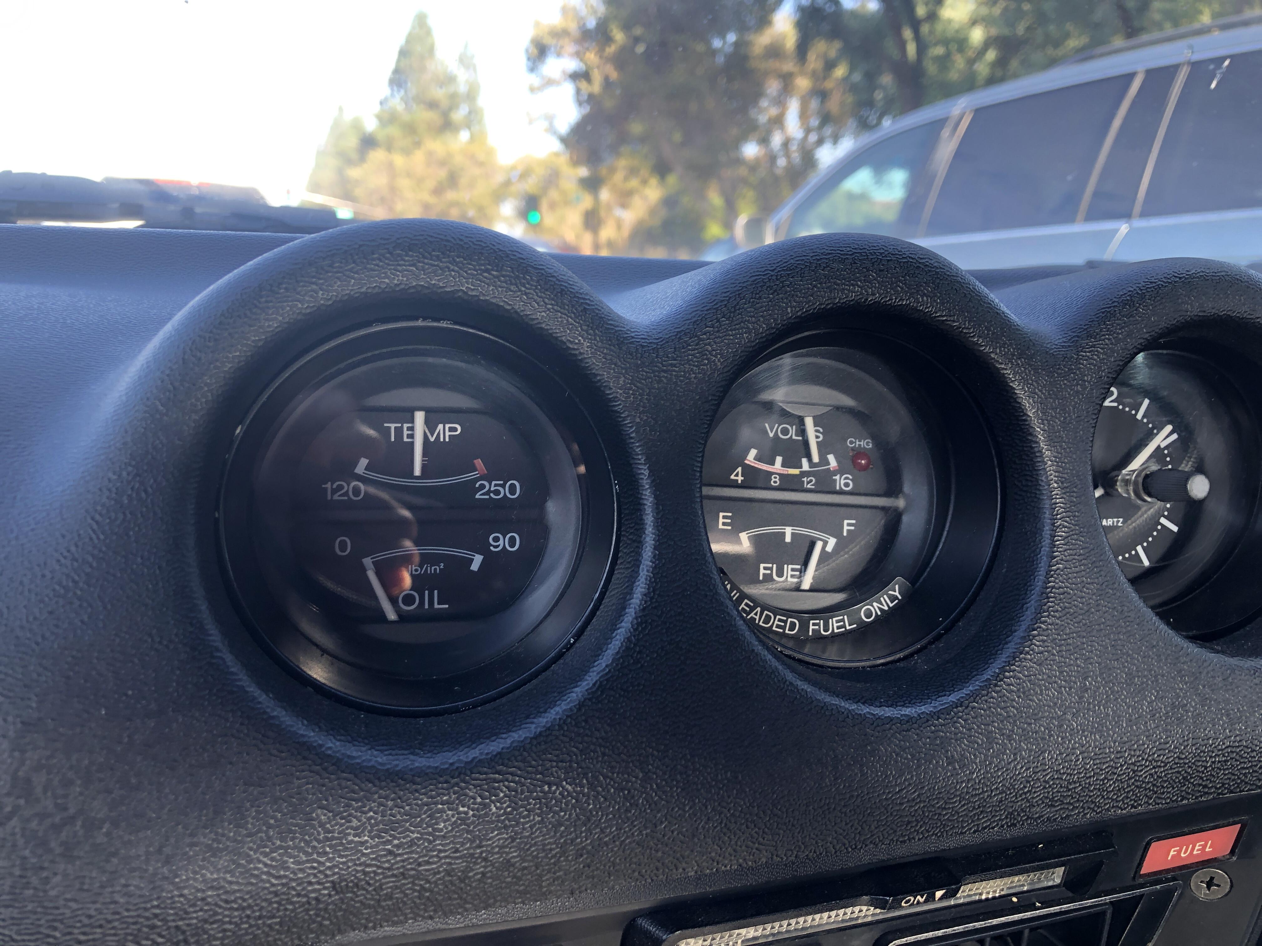

I don't have any input into your fan issue, but just wanted to ask... Are you driving on the road when you took that pic, or sitting at idle somewhere?
Reason I ask is, the oil pressure is low if you're out driving around. It would be OK for idle, but not for higher RPMs. Based on your posture on the road it looks like your RPMs should be higher than idle.
@Captain Obvious
When the car cold start, the oil pressure is about 1/3 or even close to 1/2 on the gauge at idle.  As the engine warms up, the oil pressure drops.   And while on freeway cruising 70MPH, I get a constant 1/5 or so.  I learn to live with it as at idle, I can see oil splashing on the camshaft when I open the oil cap.  Who knows, it could be one of the connector also corroded and/or greenish.  I did have brand new oil sender unit with single pin.
The picture above I took when I was in 4th gear.  Just get off of from a green light.
The voltage meter sits right between 12 and 16 volt indicator.  As I step on the accelerator pedal, it reaches close to 16 volts constantly.
As for the fan clutch, I don't think it is malfunction.  I've ran through the diagnose test such as spin the fan at cold and right after driving a car for a while and observe how it spin.  All seem to indicate it is functioning as it should be.
With my limited knowledge of how the clutch fan suppose to work ... seem that there is bimetal and/or as the oil in the clutch warms up, viscosity thins that allow the tiny balls or metal expands that allow the fan to run close to or at speed of the engine RPM.  If my memory serve me right, cruising on the freeway, I never heard the clutch kick in.  Granted lately the weather is a bit warmer, but the weather in the morning between 9-10 shouldn't change that much last couple of months.
It could be coincident is that After flushing the radiator, I used the coolant made for modern Asian cars, Zerex blue color.  I can't remember which brand I used before but it was green.  The IR temperature I got from top of the radiator was about 170F on top and 140F on bottom.  Close to the thermostat was about 180-190F.  I think the engine temperature is within optimal operation but just annoying hearing the clutch kick in too early and often.

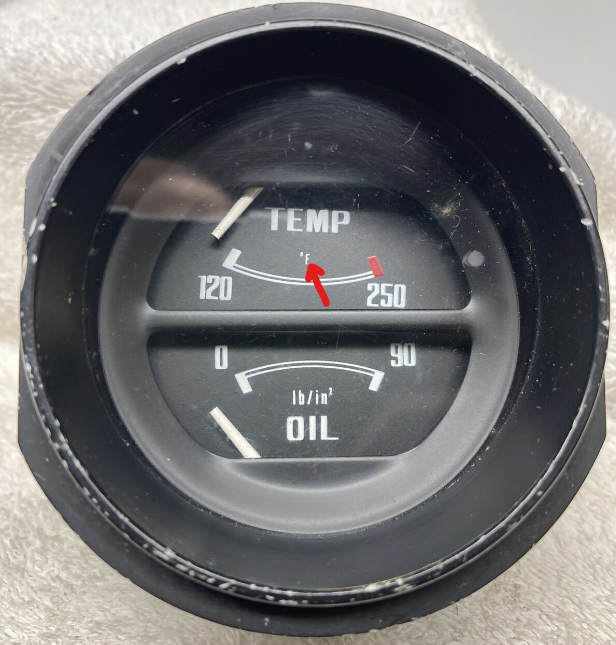

You mention the temperature gauge points to “F”. There is no  F on the temperature gauge. The picture you posted shows the temperature is in the middle of the range, so this is good.

Also, the oil pressure. The stock gauge in the Z is electric,  nothing more than an approximation. Having a good, quality mechanical gauge is the only way to know what the oil pressure is. Also, the oil pressure will change, showing a higher reading at idle when the engine is cold and getting lower as the engine reaches operating temperature. The rule of thumb is 10 pounds of pressure for every 1,000 rpm of engine speed, so 10 psi at idle is fine.
But there is an F on the temperature gauge.
Thanks Steve.
Been too long that I’ve seen one in person, and the OP’s picture isn’t good enough for me to see it.
Still, looks like the temps in his car are normal.

Agreed. Assuming a linear response in the gauge, I wouldn't worry unless the needle was clearly to the right of F and staying there.
As for the oil pressure, I know I've linked the parts a couple of times now for putting an adapter and mechanical pressure gauge on the engine to allow both gauges to function.

take a look at the photos below.  This is at idle at red light after 15 minutes of driving in the morning.  Around 8:10am.  The outside temperature was in the low 70F.
as I stepped on the gas pedal from the red light, the clutch fan engaged, around 3rd gear, then disengaged after couple of seconds.

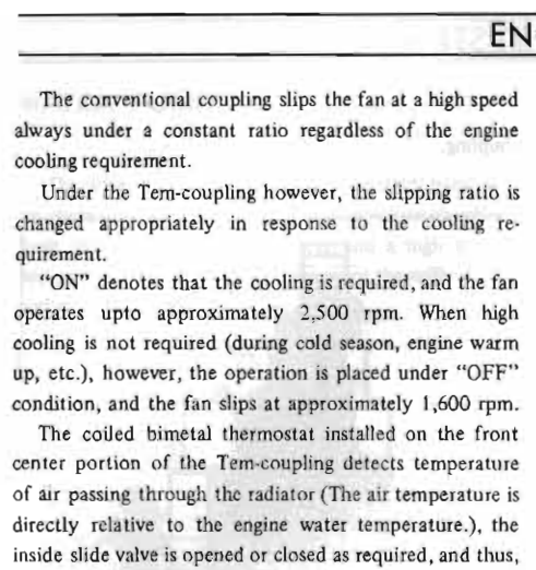

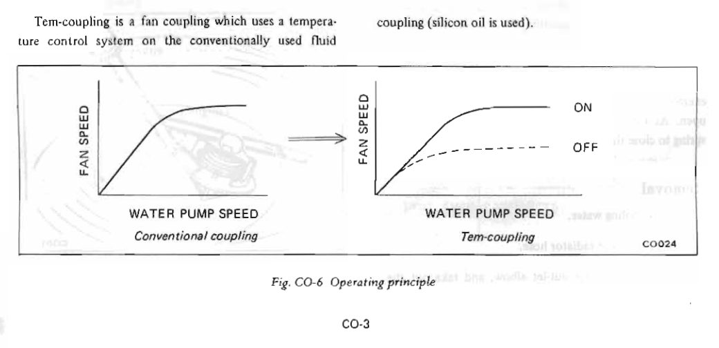

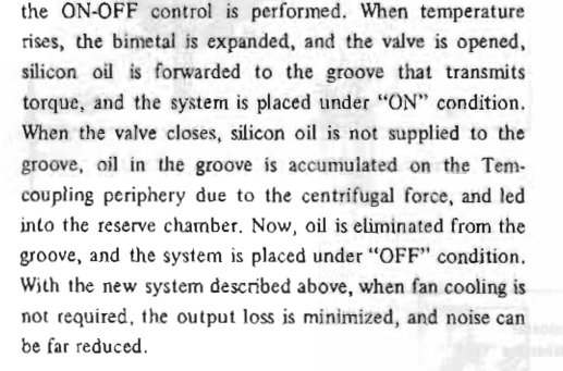

This thread is a bit bizzaro.  I did learn something about the fan clutch though.  Didn't realize that Nissan had designed an RPM set point into it.  Off? at 1600 or?  to? 2500 RPM.  Not really clear how solid the limits are.  Pretty interesting.  Introduced in 1973 apparently.  Not clear what year you're working on though.
I think that your biggest concern might be your overcharging.  That will boil your battery and overheat numerous electrical components.  Your voltage regulator is not regulating.
