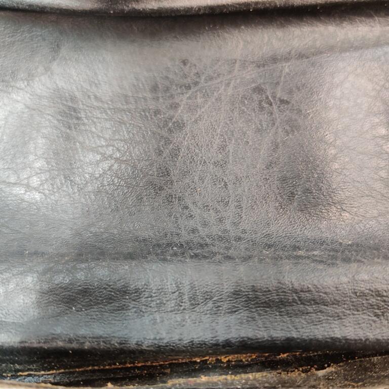

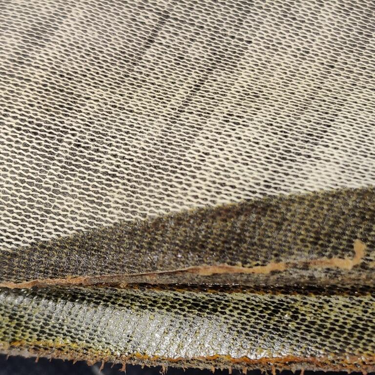

Pics for reference:

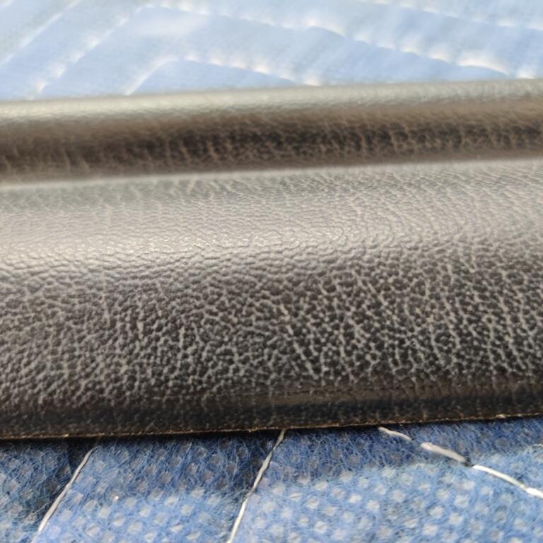

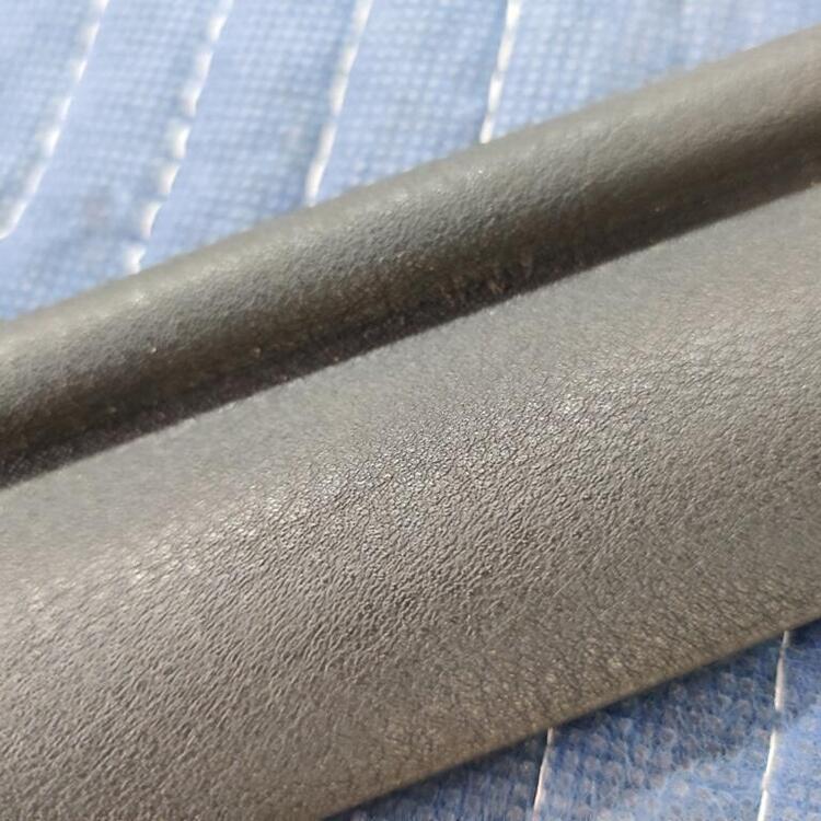

A-Pillar trim (has backing):

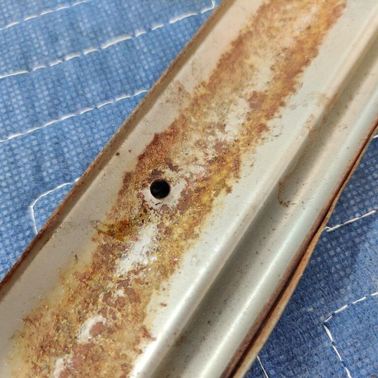

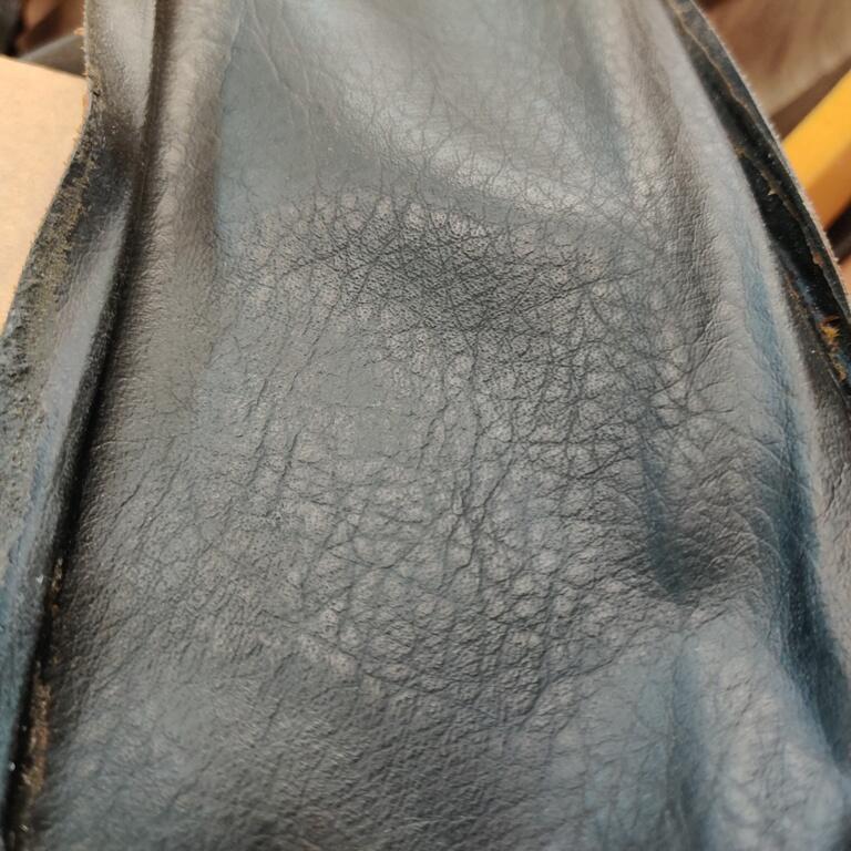

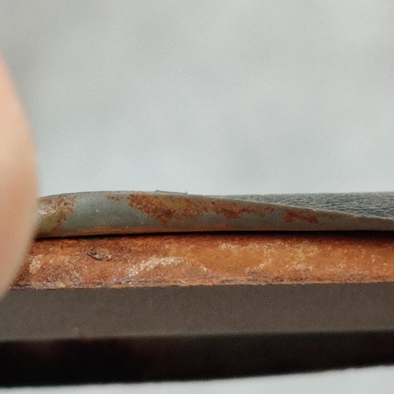

Rocker threshold - Early type with vinyl covering (non-backed) - also interesting that the underside is bare metal - no paint or primer and very susceptible to rust:

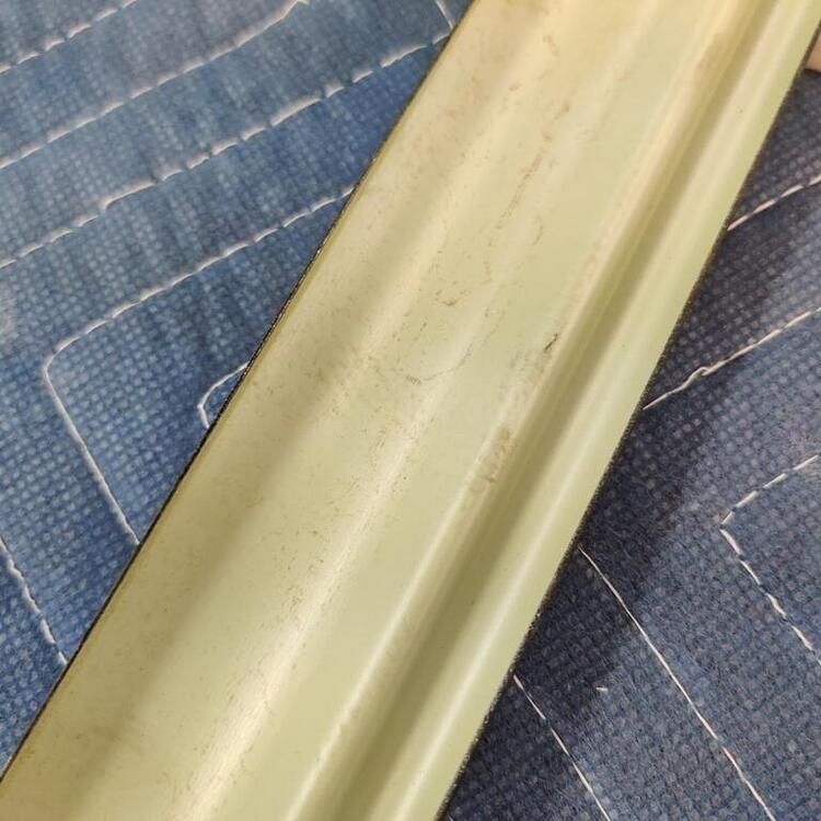

Rocker threshold - Late type with crinkle paint - note: primer/paint on the under surface:

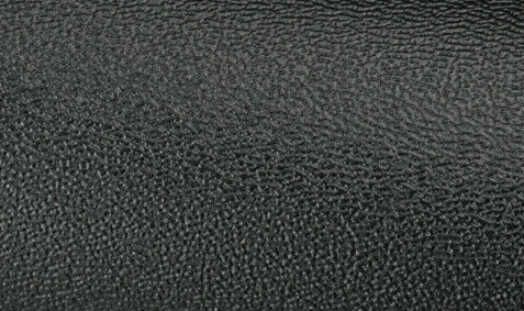

I've been searching on and off again over the last few days to try to find suitable vinyl replacements for the areas mentioned above.  Tonight, I came across a vinyl that looks similar to the original vinyl glued onto the scuff plates.  It took me a while to realize that I needed to search for "vinyl wrap".  I kept searching for non-backed vinyl and was coming up with nothing.
Ebay auction
It is cheap enough ($10 including shipping), so I think it is worth a try.  I haven't yet found an A pillar trim that looks like the original material.  I have found some that are nice.  My trim pillar trim was carefully removed and is reusable.  I may go that route.

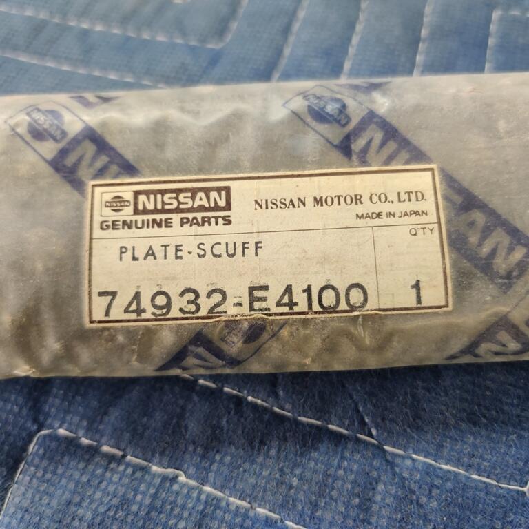

Here is a close up picture showing the difference in texture and color of the old and new scuff plates. I purchased the old vinyl wrapped one in 1984 and got the newer texture painted one in 2015, neither one has been used.
Another interesting fact about the early ones is that they first came with a five hole pattern, and the holes are dimpled. I still have a rough five hole one that I saved when I put on a replacement in 1984. The inner rockers on my car, both have five holes to match.
For reference here is my collection. The two with pink tags have been on my 7/70 car from 1979 and 1984 respectively, until I removed them for my current restoration.

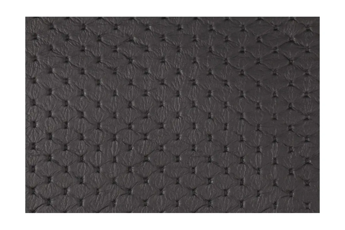

Another material I have been looking for is a vinyl for the tool storage compartments.  I have had sourcing some used ones on my list for a very long time, but haven't been able to find anything.
I am contemplating using a cloth material - gluing it to a 1/8" foam backing to "semi" replicate the original look.  Here is a cloth I found:
https://www.decorativefabricsdirect.com/MORSE-BLACK-Diamond-Fabric-p/7036211.htm
This vinyl would probably be more durable, but looks considerably different:
https://www.fabricguru.com/marine-vinyl/marine-vinyl-diamond-outdoor-fabric-black.html?gclid=CjwKCAjw6raYBhB7EiwABge5Kl3cwLQmn_bZARZ-xjpzzLBqujGFLs8qjcoWdEbapQ8zzvbzNIH3HBoCCCwQAvD_BwE
