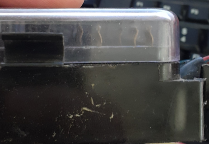

I would be shocked if it did. There is only about 3 or 4 mm clearance above the fuses in the fusebox.
Did anyone ever figure out if these will fit under the fuse cover?  I've got the MSA blade $etup laying around, but it's a shame they didn't make it smaller and fit the stock fuse cover.  Also searched and can't find the ones mentioned in the pinned thread above.
I'm sure the cover is not gonna fit..

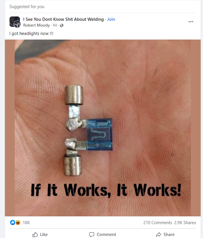

If i had no fuses anymore i would simply solder a new one (spade) onto the old broken fuse..  (maybe take a bit off of the fuse spades first..)
:pow:
So don't throw those old fuses away, they make a perfect platform to solder the new fuse to.  (And no one else thought about this.. hihi.. 🙊)

Interesting! If the plastic ATO fuse body survives the soldering heat as well as the internal fusible metal, then this is actually not a bad idea! I will get my soldering iron out today for sure.
Imagine the fun of intentionally shorting a 12v battery across a bunch of AGC fuses to blow them up for use! Zap Zap!

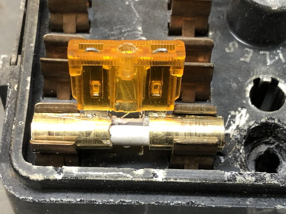

And the verdict is in. Yes you “Can”, but “Should you?”
First attempt, not very neat, managed to break the glass, which should be left intact for structural integrity.
The need to add a wire to bridge the distance gap is the biggest weakness of this approach.
And yes you have to be careful with the heat on the plastic ATO fuse.
And it was fun zapping the AGC fuse on a battery first. Does get hot, watch delicate pinkies

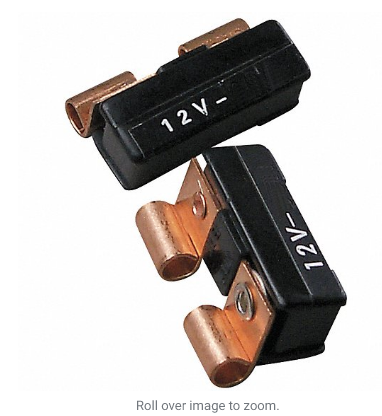

The idea is out there.  Here's a variation.  Bulky but it might offer some ideas.
Seems like you might have better luck converting the positions in the fuse box than converting the individual fuses.  The holders in the fuse box are the springy part.
https://www.grainger.com/product/6AYJ0?gucid=N:N:PS:Paid:GGL:CSM-2295:4P7A1P:20501231&gclid=CjwKCAiA9qKbBhAzEiwAS4yeDQqc4F5Bya6JJlINW2P3G8rLEGyJOnfxtQIBQnXVY2zk-TjujkuiohoC4iIQAvD_BwE&gclsrc=aw.ds

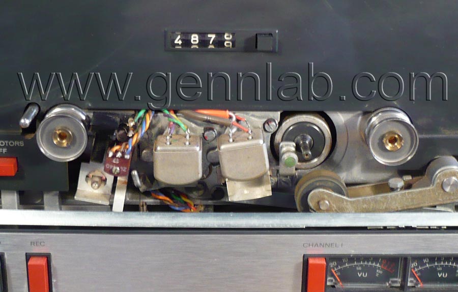

In the 1980's i had to learn soldering some wires to ReVox A77 and B77 taperecorder heads..  just enough heat to make a perfect connection.. i soldered A LOT  but those were the most problematic.. But after a few ones i got the OK from my colleges.
plukked from the internet.. 😉   The wires need to have a nice blob of shiny tin on them..
A little to much heat and your really are F---ed!  🤬
