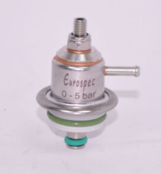

On 4/14/2023 at 9:40 PM, Zed Head said:
The print on the actual part says 0 - 5.   But the eBay text does say 3 - 5.  Who knows.
I have that one in use on my Volvo 740 (first pic). I don't recall being able to drop it below 3bar. I'll have to try it at some point to verify.

Coming back to this for a minute - since 2.5bar FPR are not easy to come by, what about using a 3bar regulator & going with newer (lower rated) injectors that don't require the ballast?
As far as I can determine stock 280Z injectors are 188c/min or 17.9lb/hr @ 2.5bar - most if not all injectors are sold rated at 3bar values. Can't find a calc right now that will provide a calculation to determine what value injector will run 17.9lb/hr @ 3bar....
There are a lot of web sites that proclaim to have flow rate calculators to predict the change in flow with respect to a change in fuel pressure. I haven't dug deep into any of them, but for example....   >> https://injector-rehab.com/knowledge-base/flow-rates/
And related to the topic, I recently tested a batch of injectors and got about 160-190 cc/min (using a stock FPR). So assuming the injectors I was checking were close to "as designed", then I can corroborate the 188 cc/min belief.
Since I need to pull the rail to replace seeping fuel hose, I'm thinking I'll just switch to the 3bar FPR (Volvo/VAG style) and keep the current injectors. It's "only" a 2psi difference, assuming mine are even flowing the spec 17.9lb/188cc. I need to revise the delivery to the rail in prep for the V6 conversion anyway.
