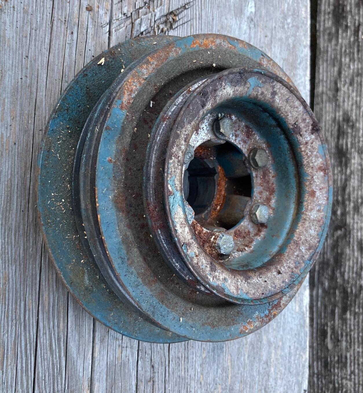

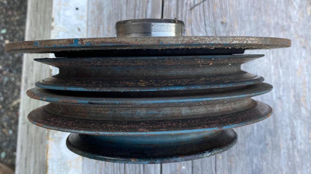

August 30, 20222 yr comment_644691 59 minutes ago, Zed Head said: That's a bummer. @Terrapin Z has many parts. Maybe he has a two row damper. Good luck. I have a loose 280 2 pulley one off the engine it looks like the eBay one, smaller back ring size. The one in the OP first pic looks like the ZX one with a third pulley. I have one of those off the engine as well. Link to comment https://www.classiczcars.com/forums/topic/67794-harmonic-balancer-broken/?&page=2#findComment-644691 Share on other sites More sharing options...
August 30, 20222 yr Author comment_644694 23 minutes ago, Terrapin Z said: The one in the OP first pic looks like the ZX one with a third pulley. I have one of those off the engine as well. Hey, glad to hear from you… I will take more pics and measurements if it helps. Link to comment https://www.classiczcars.com/forums/topic/67794-harmonic-balancer-broken/?&page=2#findComment-644694 Share on other sites More sharing options...

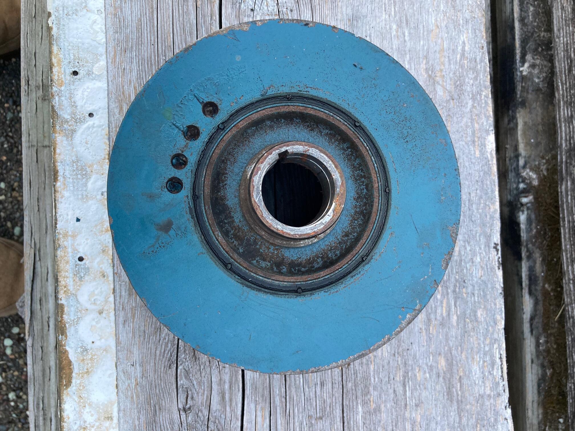

August 30, 20222 yr comment_644697 Also.. when i look at the ebay pulley.. how well would an old part like that "balance"? In the last pic of that old balancer you can see the "goo" come out of it and that should work after 40+ years... i have my doubts.. better buy a new one? They are around.. How important is a good balancer anyway? comes to mind... why are they so expensive? Link to comment https://www.classiczcars.com/forums/topic/67794-harmonic-balancer-broken/?&page=2#findComment-644697 Share on other sites More sharing options...
August 30, 20222 yr comment_644701 8 hours ago, DadAndLadZ said: Hey, glad to hear from you… I will take more pics and measurements if it helps. I think it resembles this one. It is a two pulley that was for the ZX with power steering. The third pulley is a bolt on for the A/C. IIRC. Link to comment https://www.classiczcars.com/forums/topic/67794-harmonic-balancer-broken/?&page=2#findComment-644701 Share on other sites More sharing options...
August 30, 20222 yr comment_644709 4 hours ago, Terrapin Z said: I think it resembles this one. It is a two pulley that was for the ZX with power steering. The third pulley is a bolt on for the A/C. IIRC. I've never had a ZX, but wouldn't the bolt-on pulley be for power steering and the middle one be for A/C since the A/C sheave is the same for S30 and S130? Link to comment https://www.classiczcars.com/forums/topic/67794-harmonic-balancer-broken/?&page=2#findComment-644709 Share on other sites More sharing options...

August 30, 20222 yr comment_644717 7 hours ago, Jeff G 78 said: I've never had a ZX, but wouldn't the bolt-on pulley be for power steering and the middle one be for A/C since the A/C sheave is the same for S30 and S130? That is quite possible I have only had 1 ZX and I sold the power steering off it a while ago. I do remember some where that the 79-80 had manual steering and the 81-83 had the power option. Thus the add on pulley would make more sense. This pulley came in a batch of parts I bought off a racer that was moving, so I do not know the full set up or year. Link to comment https://www.classiczcars.com/forums/topic/67794-harmonic-balancer-broken/?&page=2#findComment-644717 Share on other sites More sharing options...
