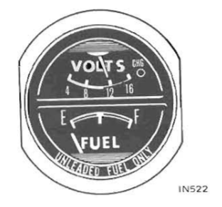

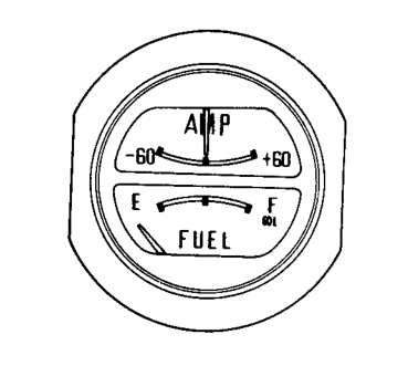

In your first post you were talking about volts but as I noted you should have an ammeter in your car, if it's a 1975.  Are you sure it's not a 76?  The build date can be in 75 for a 76 model.  The voltmeter came in 1976.
Do you have a hand held meter?  Volts and resistance?  If not you should get one.  There are good options available for about $30.  You need it if you're going to diagnose electrical problems.
Here's an ammeter and a voltmeter.  Not sure what you're working with.

I used a volt meter hand held to give y’all the volts rather than the amps. I have an amp meter in the car.
