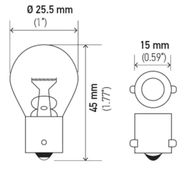

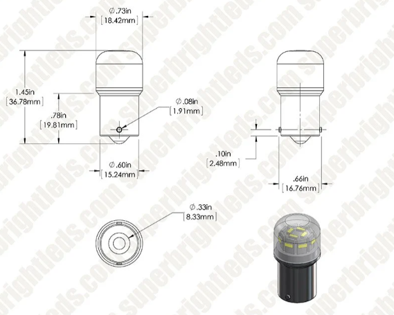

October 27, 20231 yr Author comment_658714 1156 dimensions: 67 bulb dimensions: The ones I put for side markers have a dome that has similar dimensions to the 67 bulb even though they are described as 1156. All of the bulbs listed are in use in my cars except for the gauge bulbs. That part number was provided by another member here. They allow for reverse polarity which is important due to a design quirk in the 260Z/280Z gauge light wiring. Link to comment https://www.classiczcars.com/forums/topic/67804-koito-h4-headlight-housings/?&page=3#findComment-658714 Share on other sites More sharing options...
