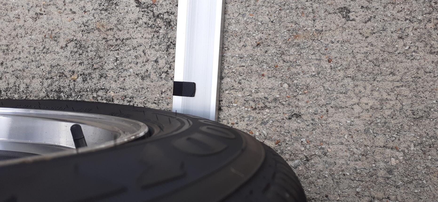

September 6, 20222 yr Author comment_645006 I tried to post from my phone, but apparently it didn't go through. I backed the car out of the garage. It was only about 15 feet, but with the step between the driveway and the garage, I think it was enough to get the car to settle. Fortunately I still had the tape marks on the straight edge from a while back. The tires are new, but the width shouldn't differ too much. I put the straight edge up against the tires. Yes, @Captain Obvious, I know that isn't the right spot, but it is consistent with my prior measurements. The new bushings made a significant difference. The straight edge isn't exactly in the same place relative to the car as before, but this still gives a good idea of the improvement. Link to comment https://www.classiczcars.com/forums/topic/67810-time-to-replace-the-rear-suspension-bushings-in-the-260z/?&page=2#findComment-645006 Share on other sites More sharing options...
September 7, 20222 yr comment_645020 So you have like three quarters of an inch less toe just by changing the inner bushings? Am I interpreting that right? If so... Wow. Can you take some more pics of the bushings you took out. Shadows in the pic you posted above are making it look like there's some real weird stuff going on with them. Might just be light, or might help explain what was going on? And lastly... You did remember to leave the big bushing bolts loose until the suspension was loaded, didn't you? Link to comment https://www.classiczcars.com/forums/topic/67810-time-to-replace-the-rear-suspension-bushings-in-the-260z/?&page=2#findComment-645020 Share on other sites More sharing options...
September 7, 20222 yr Author comment_645024 30 minutes ago, Captain Obvious said: So you have like three quarters of an inch less toe just by changing the inner bushings? Am I interpreting that right? If so... Wow. Can you take some more pics of the bushings you took out. Shadows in the pic you posted above are making it look like there's some real weird stuff going on with them. Might just be light, or might help explain what was going on? And lastly... You did remember to leave the big bushing bolts loose until the suspension was loaded, didn't you? I tossed the old bushings, but they were pretty distorted. No, I didn't remember to leave the big bushing bolts loose until the suspension was loaded. I guess I need to put the car back up in the air the morning, loosen the bolts and load the suspension. Link to comment https://www.classiczcars.com/forums/topic/67810-time-to-replace-the-rear-suspension-bushings-in-the-260z/?&page=2#findComment-645024 Share on other sites More sharing options...
