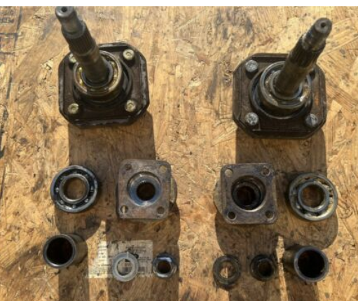

Zed Head Posted September 8, 2022 Share #13 Posted September 8, 2022 (edited) Probably easier to tell if the axle and flange are off the car. I did a quick Google and these popped up. You can see that the guy is sliding the flange on and off the axle by hand. Has to be for the pictures. Type "Datsun 280z 27 Spline Stub Axles W/Companion Flange " in to eBay and they should pop up. $350 for the set. (eBay tags so much stuff on to their web page links that I'm afraid to share the link. Who knows what all of that extra stuff means). Edited September 8, 2022 by Zed Head -y Link to comment Share on other sites More sharing options...
Zed Head Posted September 8, 2022 Share #14 Posted September 8, 2022 p.s. ritrebor is the seller. He's a member here. @ritrebor Link to comment Share on other sites More sharing options...
ckurtz2 Posted September 8, 2022 Author Share #15 Posted September 8, 2022 10 minutes ago, Zed Head said: p.s. ritrebor is the seller. He's a member here. @ritrebor Thank you, I’ll reach out if I end up wanting them. The price is a little steep for me and I only need one side. Link to comment Share on other sites More sharing options...

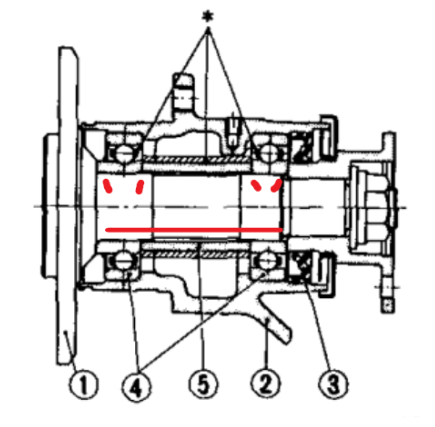

Zed Head Posted September 8, 2022 Share #21 Posted September 8, 2022 (edited) Your description sounds more like the bearing is not seating properly in the strut casting. The bearing is cokced. Or the "distance piece" is distorted which also would cause a cokced bearing. There are several surfaces you can examine and measure to find out what's not right. You'll have to take it apart though. When those 5 parts clamp together they basically form a solid tube though the hub. The two inner bearing races and the distance piece are the tube, and the flanges are the clamping surfaces. The outer races get pulled along by the balls and inner race. Edited September 8, 2022 by Zed Head 1 Link to comment Share on other sites More sharing options...

Zed Head Posted September 8, 2022 Share #23 Posted September 8, 2022 By your description you think that one of the flanges has excessive runout. You said that you think something bent when installing new bearings. The only force that could put a side load on the shaft or the flanges is the nut and washer pressing on the inner flange, pulling the parts together. The only thing resisting the force is the bearing. If you put the nut on when the parts are out of the casting it should spin right on. I'm just proposing ideas about what would cause a bend of any of those parts. Here's other thoughts though - the half-shaft is not properly seated on the centering ring. Or the half-shaft itself is bent or binding. Or the differential is damaged. There are a lot of moving parts back there. Can't really tell because all you have are impressions from driving. Sometimes it helps to just lift the car, throw a cushion under it, crawl under there, and take a good look at things as you spin them. Grab things and shake them, see if anything is loose. Link to comment Share on other sites More sharing options...
