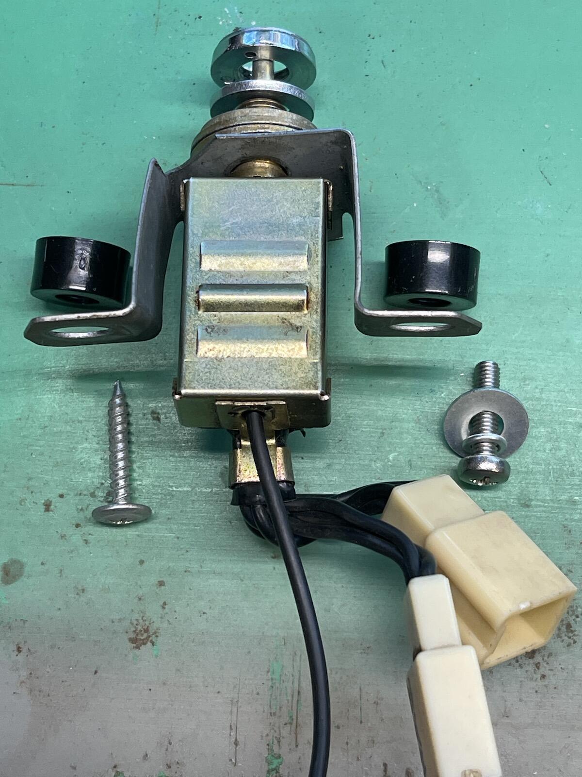

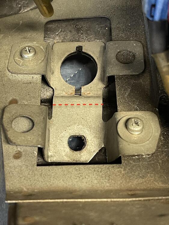

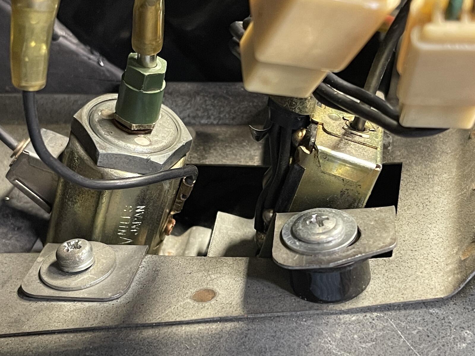

October 5, 20222 yr Author comment_646087 While waiting for a few small parts, I decided to redo the Lighter and Hazard Switch mounting. The rear mounting bracket made the hazard switch stick out about 3/8" of an inch too much, showing a lot of the brass threaded stem above the spanner nut. The lighter socket fits fine, but the switch bracket needs to be pulled back away from the dash to have a solid flusher mount. I saw this link which talks about the same problem and fix. First, I cut the bracket with some tinsnips, and after drilling a new hole for a sheet metal screw, and bolted the lighter half back in place and mounted the lighter socket. I rounded up some spacers for underneath the bracket, add added some washers to the stem so it seats against the back of the dash. I also added a washer beneath the spanner nut so it doesn't twist directly against the new dash material when tightening. Not sure if the factory had one there, and mine was missing, but it seemed like a good idea. Used my snap ring pliers for the spanner nut, not the best tool to use, but it worked. Got a longer M5 screw and drilled another hole for the sheet metal screw. Mounted back in place. It does feel more solid too. Link to comment https://www.classiczcars.com/forums/topic/67851-73-dash-replacement-project/?&page=4#findComment-646087 Share on other sites More sharing options...
