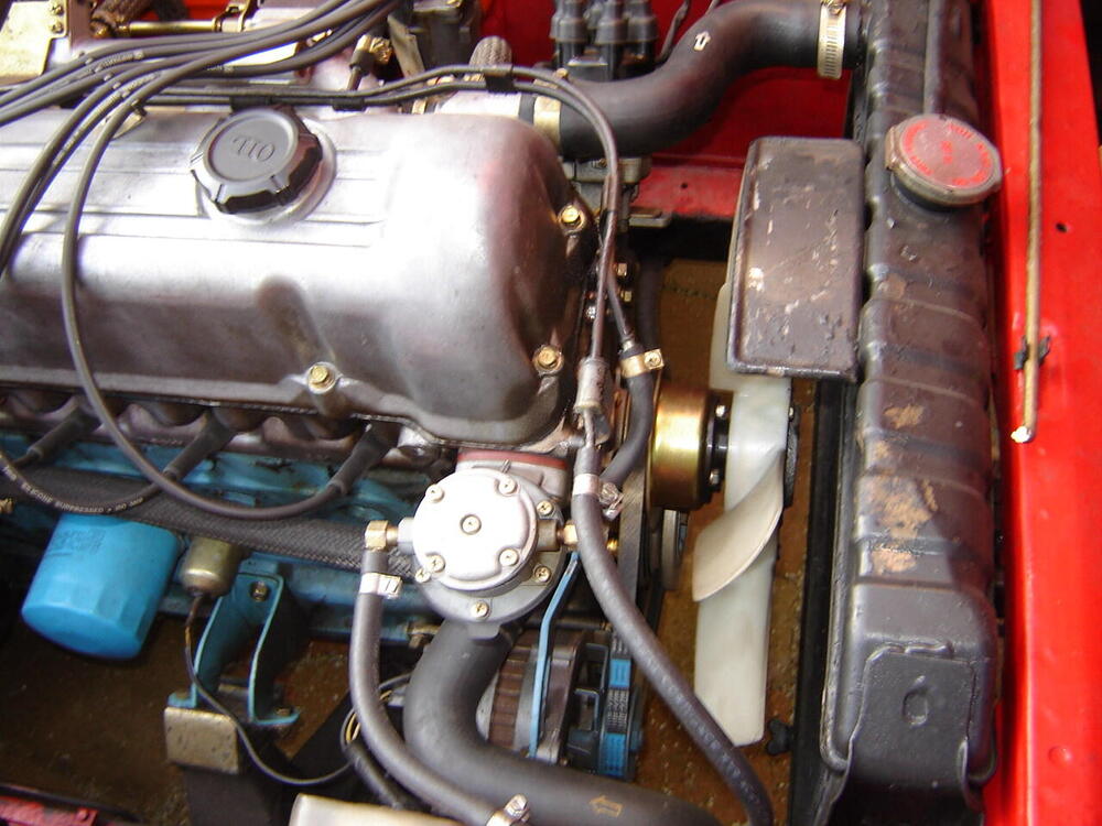

October 5, 20222 yr comment_646099 Here is a photo of my 5/72 low miles, very original 240z...prior to starting my refresh project. Link to comment https://www.classiczcars.com/forums/topic/67886-two-wire-hose-clamps/#findComment-646099 Share on other sites More sharing options...

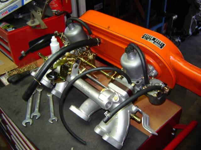

October 5, 20222 yr comment_646114 Here is my recent post on this topic, all new braided cover fuel hoses and valve cover breather hose - all from Belmetric. And yes... twin wire hose clamps were used for all the fuel lines. Agree, the very small ones are hard to find. Link to comment https://www.classiczcars.com/forums/topic/67886-two-wire-hose-clamps/#findComment-646114 Share on other sites More sharing options...
