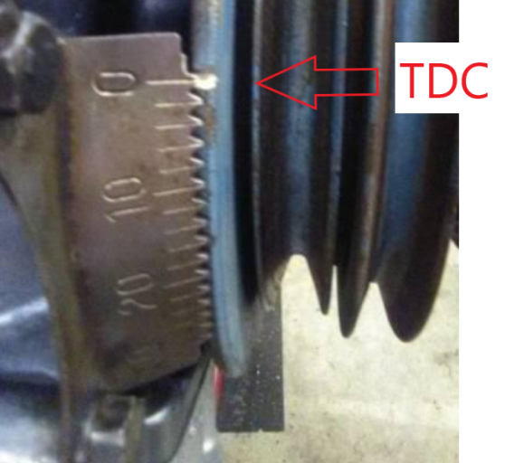

Reptoid showed how a normal timing tab and damper pulley work together in post #11.  You have to be able to eyeball where the mark is when your timing light flashes.
Unless you put up a new video nobody knows what the actual noise is that you're hearing when the engine is running.  Your video was the wrench on the camshaft sprocket.
Here's Reptoid's picture and yours.  All I'm saying is know what you're working with.  We're at post #42 and there's still no reliable way to check ignition or cam timing.  Engines are all about timing.

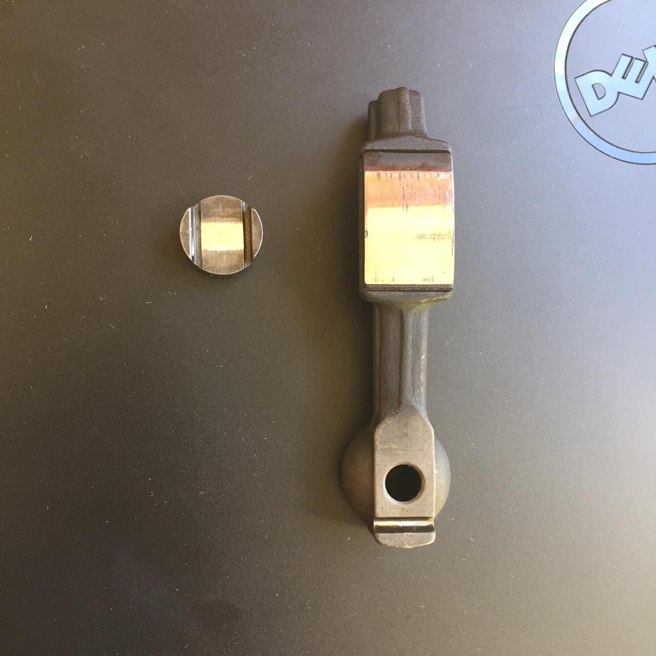

You might take a close look at the wear pattern on the rocker arm pads.  Kind of sounds like valve train noise on one or two cam lobes.  Just a guess.  With an aftermarket cam the right lash pads might not have been used.  Definitely sounds like it needs fixing.  The engine sounds pretty good overall but the noise is bad.
19 hours ago, RMin280 said:
What should the wear pattern look like if it is correct?
Sort of like this, but centered on the pad.
The pattern is too close to the pivot.
The pattern on the lash pad looks OK.
The cam followers have three wear points, where the follower sits on the pivot ball, where the cam lobe rides on the middle of the follower, and where the follower rides on the lash pad (which sits on the valve stem).
Look for a clean, smooth pattern, no grooves or excessive wear, and it should be centered on the pad.
