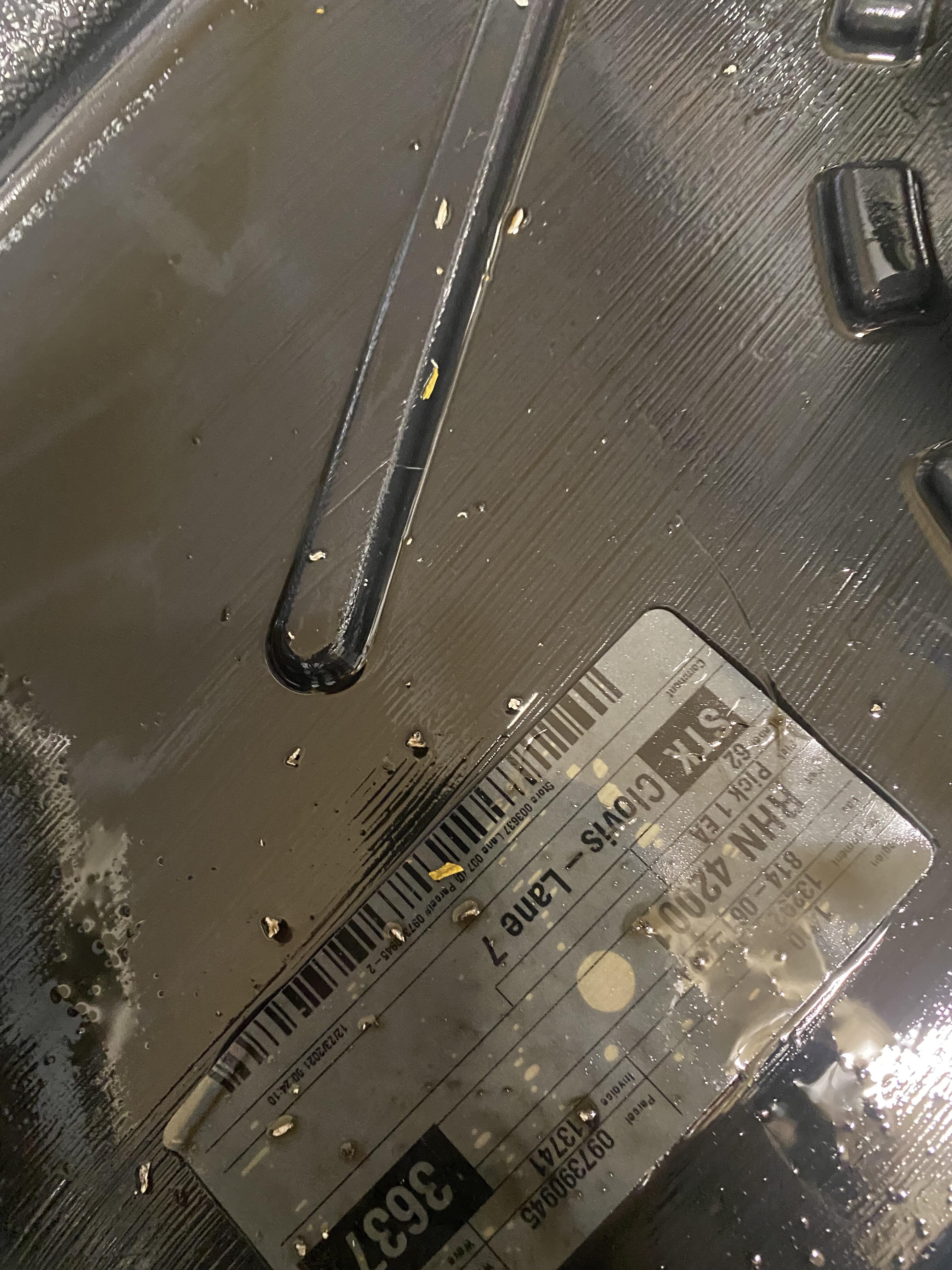

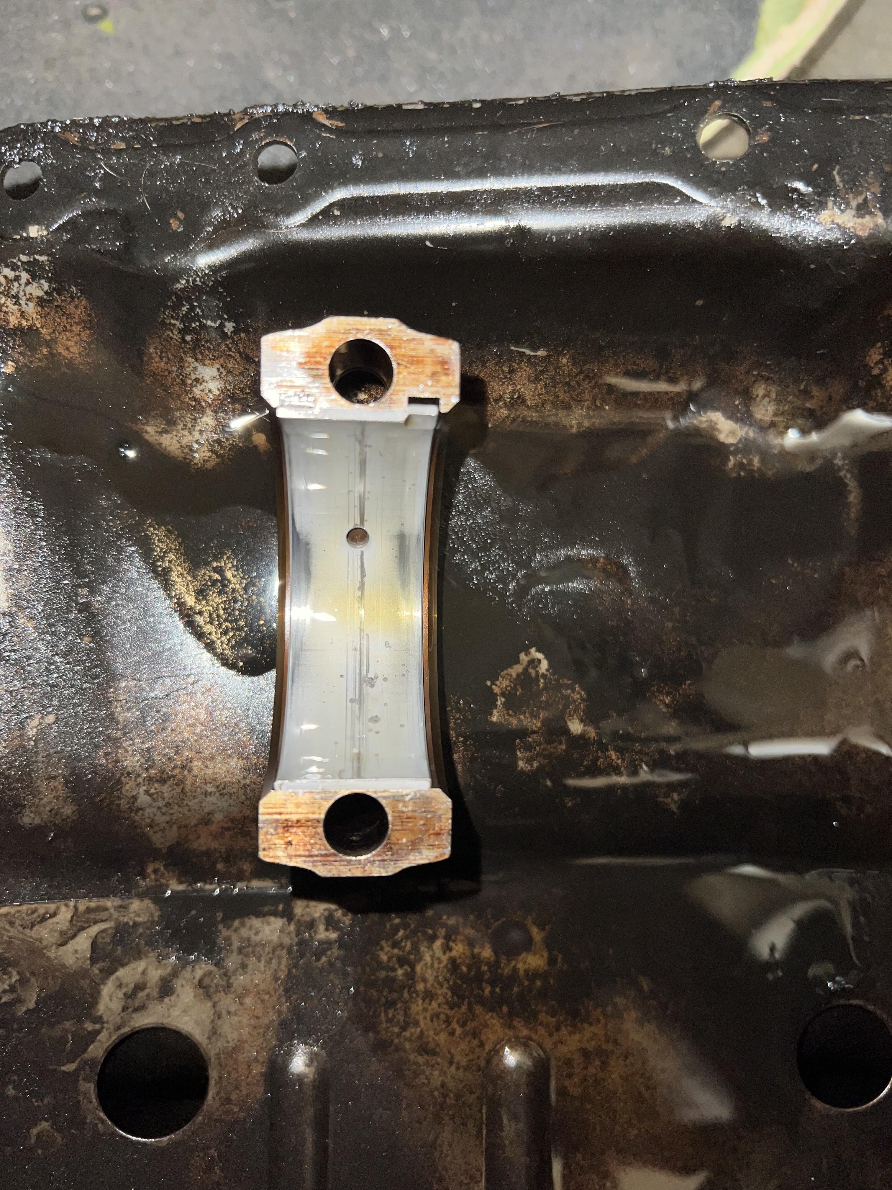

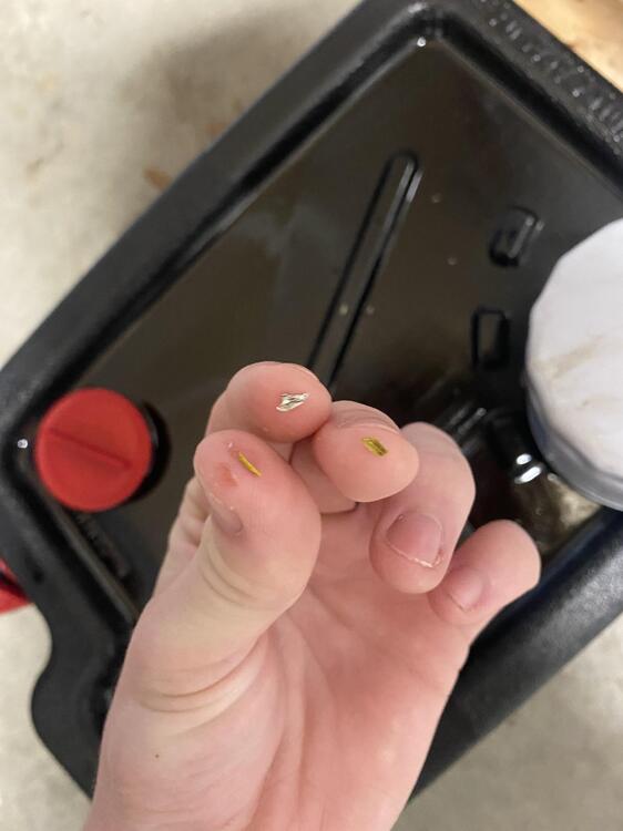

Posted October 13, 20222 yr comment_646354 Hey guys, im currently in the middle of taking out my rod bearings after finding some non-magnetic metal shavings in my oil (i believe them to be copper). I have pulled 2 rod caps, and the bearings both looked like this. This looks like particulate wear to me, and the shavings I saw i feel were much to big to be from these bearings. i havent pulled all of them yet, but i figured i would just ask what you guys thought. I had no rod knock or anything, but my instinct told me it must be bearings. Was I wrong? I have attached a picture of the bearing, as well as two pictures of the shavings. Thanks in advance! Link to comment https://www.classiczcars.com/forums/topic/67907-rod-bearing-wear-pattern-1975-280z/ Share on other sites More sharing options...
October 14, 20222 yr comment_646367 That bearing looks fine to me What do the timing chain guides look like? What is that draining out of the oil filter? Link to comment https://www.classiczcars.com/forums/topic/67907-rod-bearing-wear-pattern-1975-280z/#findComment-646367 Share on other sites More sharing options...
October 14, 20222 yr comment_646371 Yeah, I agree with that. If someone told me my rod bearings looked like that, I would not even take the caps off. Link to comment https://www.classiczcars.com/forums/topic/67907-rod-bearing-wear-pattern-1975-280z/#findComment-646371 Share on other sites More sharing options...

October 14, 20222 yr comment_646410 I suspect the debris could be coming off the chain guides. I don't know what else could shed like that inside the engine unless its been rebuilt in the past Link to comment https://www.classiczcars.com/forums/topic/67907-rod-bearing-wear-pattern-1975-280z/#findComment-646410 Share on other sites More sharing options...

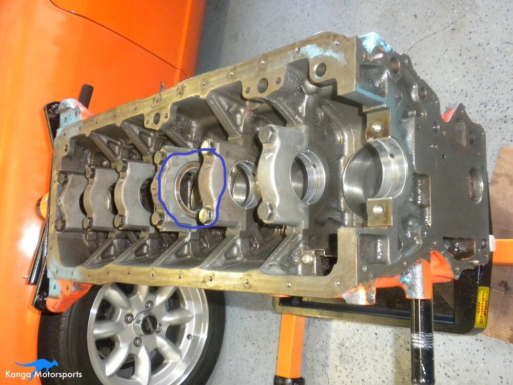

October 15, 20222 yr comment_646420 Looks like brass/copper and aluminum. Pull the thrust bearing main cap and check it. It should be the 4th main cap counting from the front. I can't think of anything else that has brass or copper inside the engine. You can see the thrust bearing circled in blue in this photo Link to comment https://www.classiczcars.com/forums/topic/67907-rod-bearing-wear-pattern-1975-280z/#findComment-646420 Share on other sites More sharing options...
October 15, 20222 yr comment_646429 The yellow stuff might be the stuff used to bond the baffle into the cam cover. what does the inside of the cam cover look like? Link to comment https://www.classiczcars.com/forums/topic/67907-rod-bearing-wear-pattern-1975-280z/#findComment-646429 Share on other sites More sharing options...

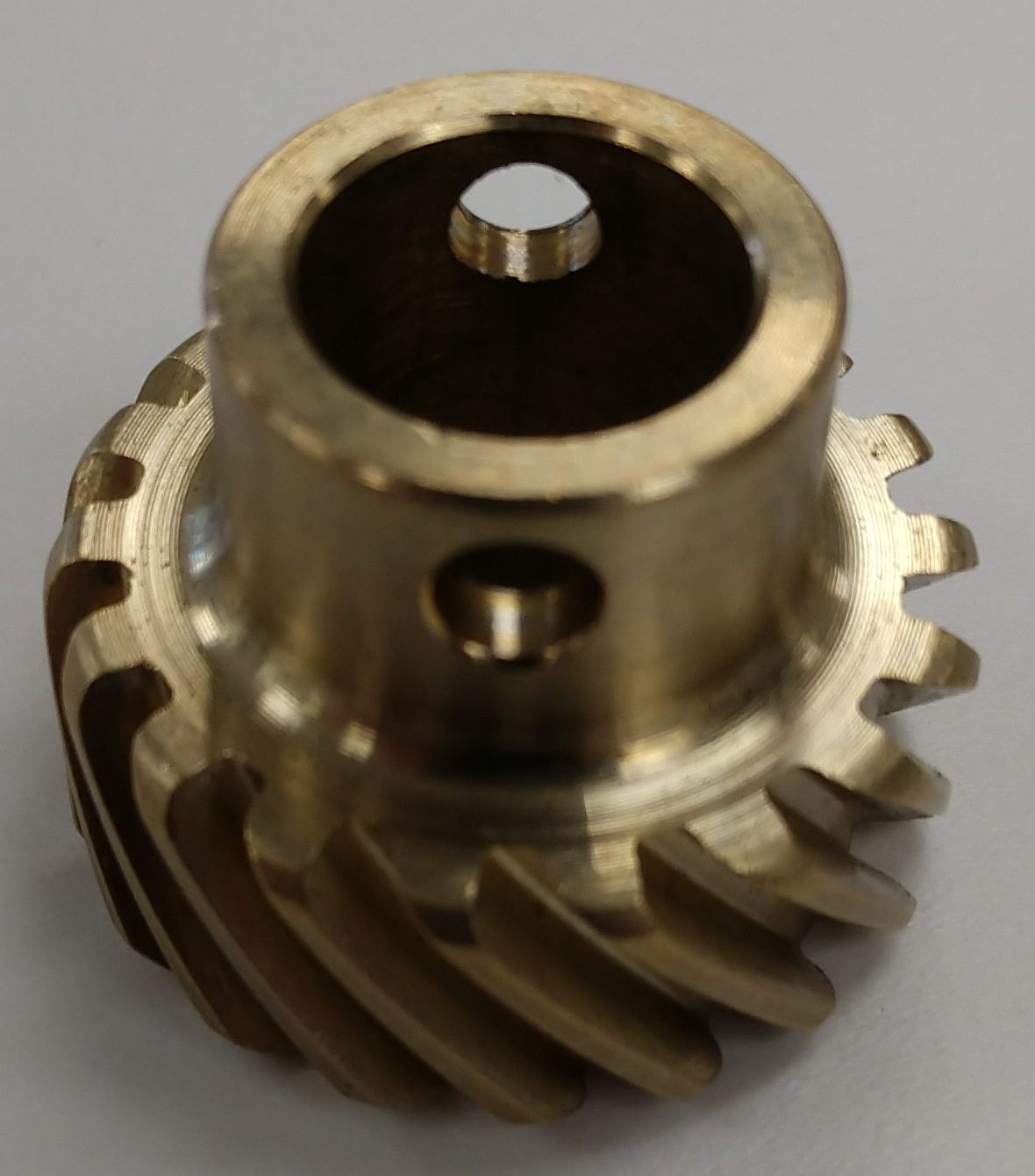

October 15, 20222 yr comment_646433 What about the oil pump/distributor drive spindle? I've seen the teeth shear off before, and found bits of metal that size. There are bronze gears available, and the pieces do look a little like bronze. Edited October 15, 20222 yr by Racer X Link to comment https://www.classiczcars.com/forums/topic/67907-rod-bearing-wear-pattern-1975-280z/#findComment-646433 Share on other sites More sharing options...
October 15, 20222 yr Author comment_646452 20 hours ago, kickstand80 said: Looks like brass/copper and aluminum. Pull the thrust bearing main cap and check it. It should be the 4th main cap counting from the front. I can't think of anything else that has brass or copper inside the engine. You can see the thrust bearing circled in blue in this photo Thank you, I've actually just come down with some sort of flu/cold, but once I'm over it i will be sure to check that and update. Link to comment https://www.classiczcars.com/forums/topic/67907-rod-bearing-wear-pattern-1975-280z/#findComment-646452 Share on other sites More sharing options...
October 17, 20222 yr comment_646484 I guess I have a different take on the bearing. I see that some foriegn material has been fed through the oiling hole that has scratched the surface of the bearing at its midline - not terribly, just notably. The filter should have snagged that but either didn't get the chance or it occurred during a bypass event. Also, it looks like the bearing has spent some time without an oil film between it and the crank, hence the polishing/removal of the bearing liner material. Oddly though, only the bearing edges are worn - not the middle and the wear area seems narrow. I would expect to see that wear pattern uniformly across the bearing surface and involve more of the circumferential area. I like @Racer X's suggestion of either bronze gear failing. Edited October 17, 20222 yr by ETI4K Typo repair Link to comment https://www.classiczcars.com/forums/topic/67907-rod-bearing-wear-pattern-1975-280z/#findComment-646484 Share on other sites More sharing options...

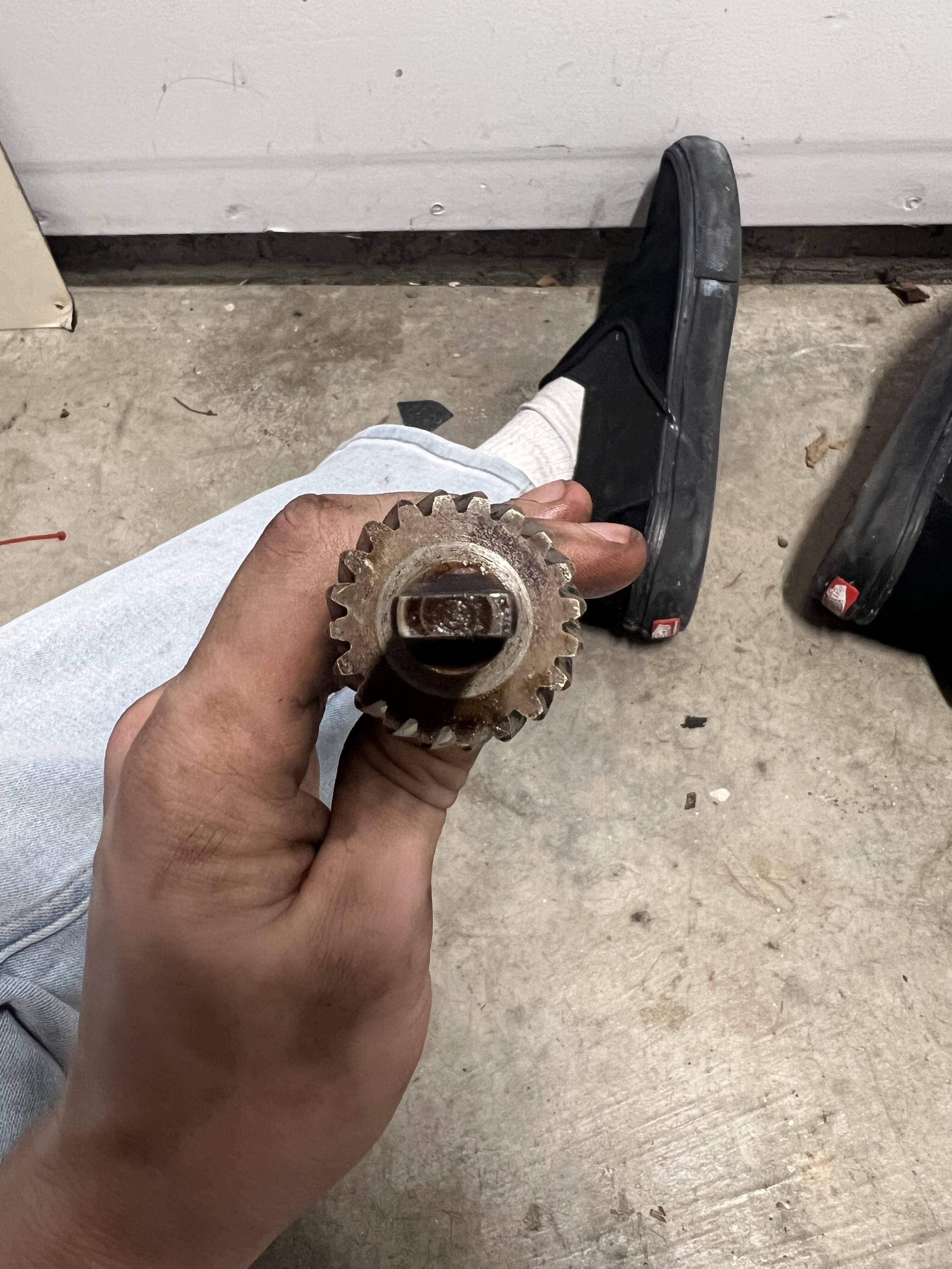

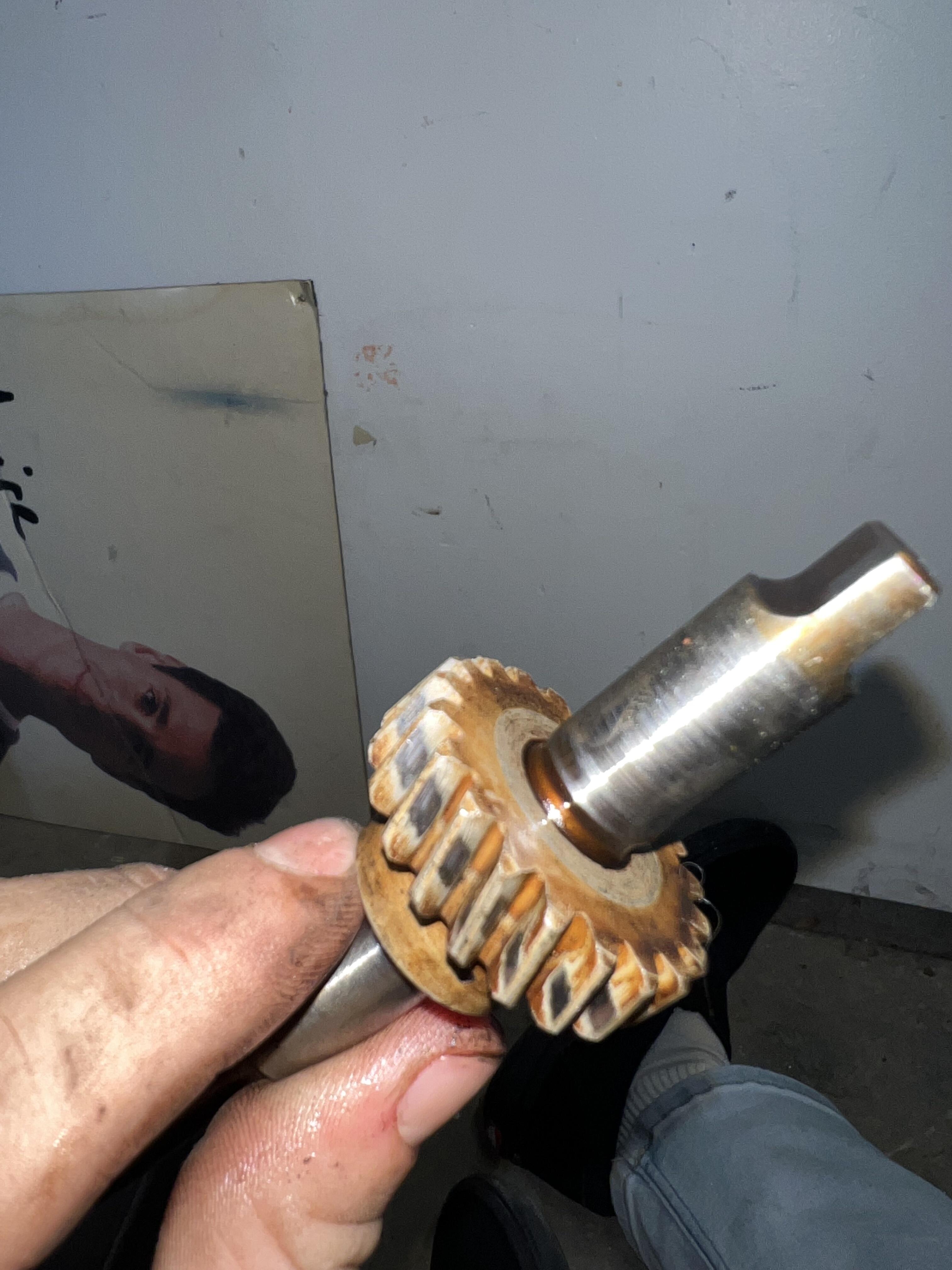

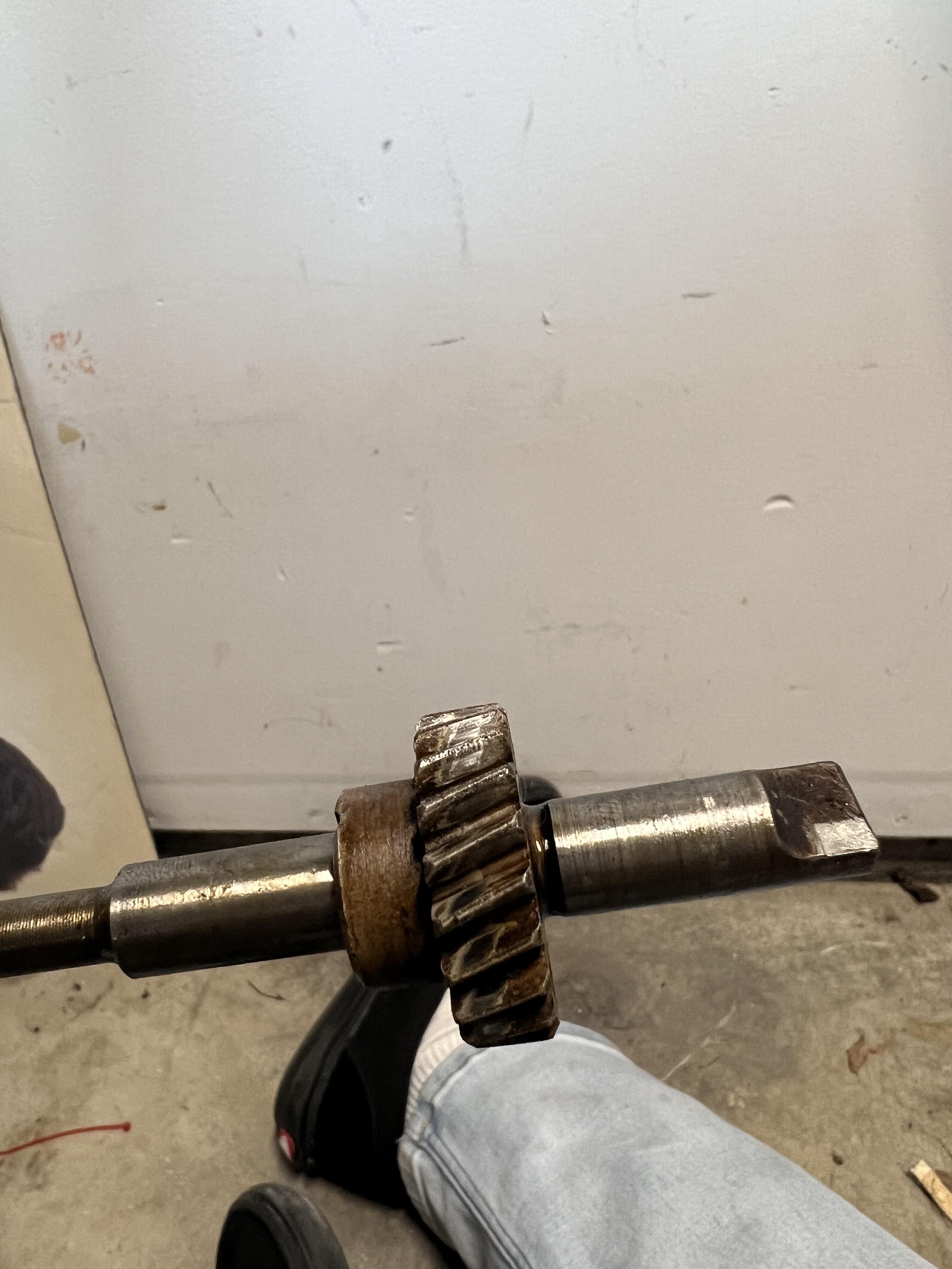

October 28, 20222 yr Author comment_646810 On 10/15/2022 at 4:23 AM, Racer X said: What about the oil pump/distributor drive spindle? I've seen the teeth shear off before, and found bits of metal that size. There are bronze gears available, and the pieces do look a little like bronze. What do you think? looks fine to me personally. I was really hoping it was this to be honest, cause it seemed like an easy fix. Link to comment https://www.classiczcars.com/forums/topic/67907-rod-bearing-wear-pattern-1975-280z/#findComment-646810 Share on other sites More sharing options...
October 28, 20222 yr comment_646826 What is the history of the engine? It might just be old stuff from a PO. It might not be from the engine. Take a closeup look at the pieces. https://www.grainger.com/product/2NTH8?gucid=N:N:PS:Paid:GGL:CSM-2295:4P7A1P:20501231&gclid=Cj0KCQjw--2aBhD5ARIsALiRlwDogoTfMTMx_RTHvhnWZddPF8nFLTPLLMiR1zXuhgAOdJewK_mnQXcaAqNhEALw_wcB&gclsrc=aw.ds Link to comment https://www.classiczcars.com/forums/topic/67907-rod-bearing-wear-pattern-1975-280z/#findComment-646826 Share on other sites More sharing options...
