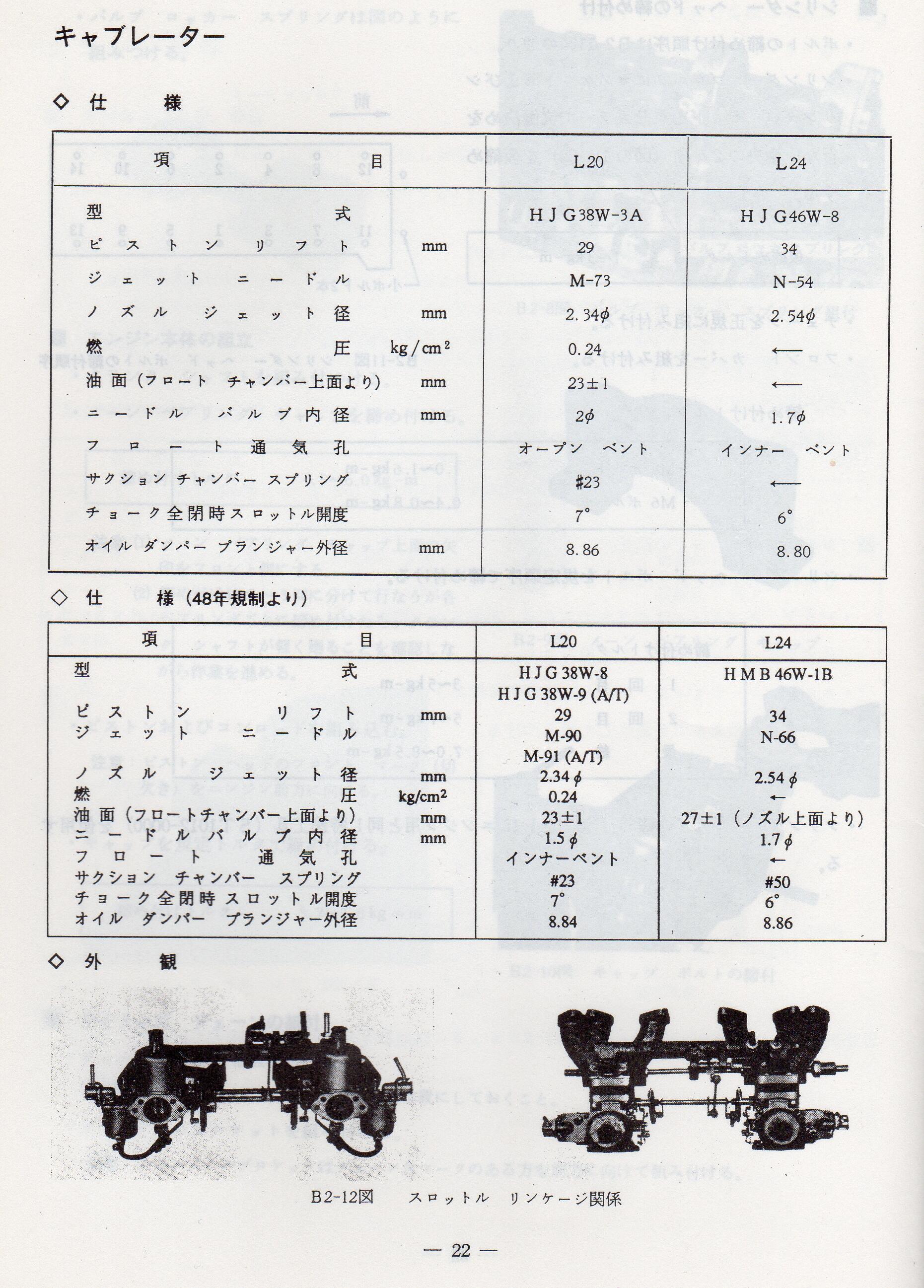

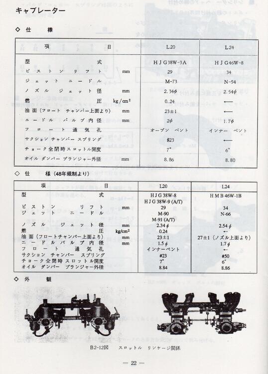

  On 10/26/2022 at 6:36 PM, RIP260Z said:
I am unsure if any JDM market had the HMB46W fitted (HS30-H?), apart from their recalled Fairlady Z with the 2.6L fitted.
Hi Ian,
Very late 1972 and then 1973 year L24-engined Fairlady 240Z, Fairlady 240Z-L and Fairlady 240ZG got the HMB46W-1Bs as part of Nissan's drive towards reducing emissions. Specs here, in bottom right box:
...which says the jet needles were 'N-66'.
Thanks Alan,
So, slightly off topic, but connected, the "flat top carb" HJG38W in your JDM scan also has the suffix, -3A in the top, with -8 and -9 (A/T), which would help support the theory of slight changes due to models/engines, where the HJG36W I have is -11. Certainly confirms different needles in the JDM Fairlady 2.4L and the European L26 (which would be the case). I take it the top box is the earlier model, the 48 year (in kanji) is later models? So, a needle change from N-54 to N-66. Therefore do Nissan's needle series go by letter, M the N...?
That seems likely, and logical, to me. I have no idea what these minor differences were, and Nissan doesn't seem to have been too forthcoming with data to explain them either (possibly in line with their 'Do Not Fiddle!' stance?). That difference of '-8' suffix on manual trans '73 L20 and '-9' suffix for the Auto trans version does indeed seem to point to differences being minor.
Yes. Pretty much. The top boxes are up to very late '72 whilst the bottom two are the 'Showa 48' (1973) versions.
