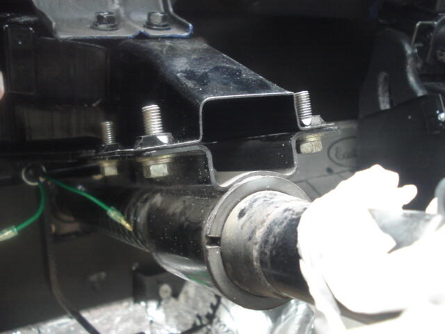

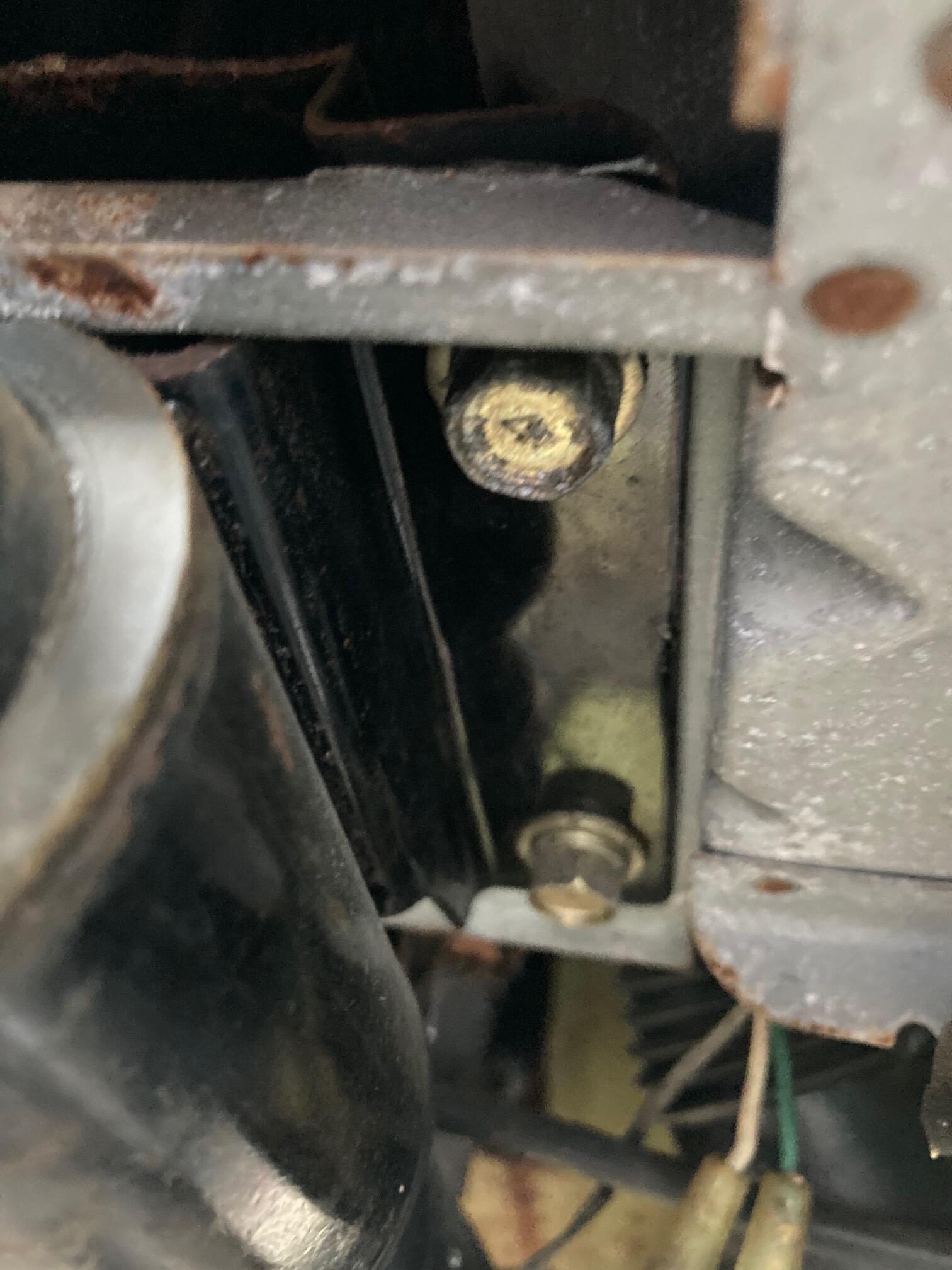

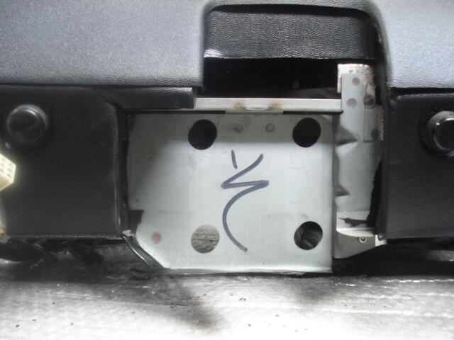

Posted October 18, 20222 yr comment_646547 So it's been a while since I removed the dash on my 73 240Z restoration. Since I'm getting old I don't remember things as well. I'm getting ready to re install the dash and could use some help jogging my memory. On the bottom of the dash on the left side there is a bare piece of metal with 4 holes in it. I can't remember if this part of the dash just rests on top of the steering column bracket or if I have to remove the steering column mounting bracket bolts and sandwich the dash plate between the upper and lower halves of the column, then reinstall the bolts. I've included a few pics to illustrate what I'm talking about. Any help greatly appreciated. Paul (zebeemer) Link to comment https://www.classiczcars.com/forums/topic/67917-re-installing-dash-73-240z/ Share on other sites More sharing options...
October 18, 20222 yr comment_646550 My 72 says sandwich. Link to comment https://www.classiczcars.com/forums/topic/67917-re-installing-dash-73-240z/#findComment-646550 Share on other sites More sharing options...
October 18, 20222 yr comment_646551 My '70 is the same as @Terrapin Z. Also there is a good picture in the steering section of the FSM. 1970 thru 1973 FSM's all use the same set of pictures. Or I should say was before I took it apart for my resto... Edited October 18, 20222 yr by CanTechZ Link to comment https://www.classiczcars.com/forums/topic/67917-re-installing-dash-73-240z/#findComment-646551 Share on other sites More sharing options...
October 19, 20222 yr Author comment_646557 Great. Thanks for the help. I have the FSM but was looking in the body section not the steering section. I'll check it out. Link to comment https://www.classiczcars.com/forums/topic/67917-re-installing-dash-73-240z/#findComment-646557 Share on other sites More sharing options...
