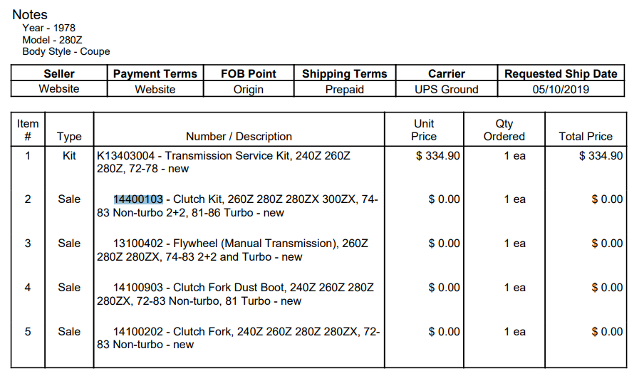

Posted October 23, 20222 yr comment_646659 I have a 1978 280z 5 speed. I installed a transmission service kit from Z Car Source of Arizona a while ago. Attached is the order form. Yesterday was the first time I was able to take the car for a long drive. When I get to 2500rpm the clutch slips in 2nd and 3rd gear and I can get no more power until I change gears. Has anyone had issues with this kit. I am a novice in working on cars so any advice on troubleshooting would be greatly appreciated. SO-100005509.pdf Link to comment https://www.classiczcars.com/forums/topic/67925-new-clutch-issue-280z/ Share on other sites More sharing options...
October 23, 20222 yr comment_646660 Did it come with a new throwout bearing sleeve (aka collar)? I tried to find the list of parts in the kit but the company has shut down. Link to comment https://www.classiczcars.com/forums/topic/67925-new-clutch-issue-280z/#findComment-646660 Share on other sites More sharing options...
October 23, 20222 yr comment_646661 It's not clear what is in the "kit". Edited October 23, 20222 yr by Zed Head + i Link to comment https://www.classiczcars.com/forums/topic/67925-new-clutch-issue-280z/#findComment-646661 Share on other sites More sharing options...

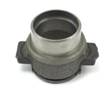

October 23, 20222 yr comment_646662 The throwout bearing sleeve looks like this. The bearing presses on to it. https://www.thezstore.com/product/2158/factory-clutch-collar-75-83-z-zx-2-2-82-83-280zx-turbo-84-89-300zx-non-turbo Link to comment https://www.classiczcars.com/forums/topic/67925-new-clutch-issue-280z/#findComment-646662 Share on other sites More sharing options...
