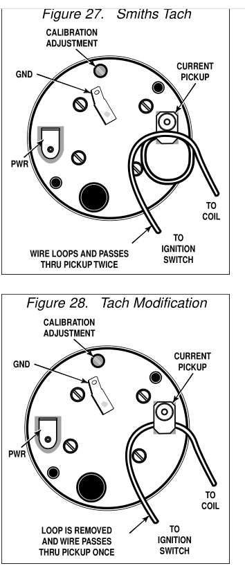

Near the end of the Crane XR700 / XR3000 instructions there is a section on modifying Smiths type tachs, which is what you have.  Looks like they're reducing the power/size of the magnetic field by removing a loop of the sensing wire.
Here's a link to the downloads area, might be worth reading.  Page 16.
