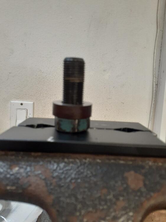

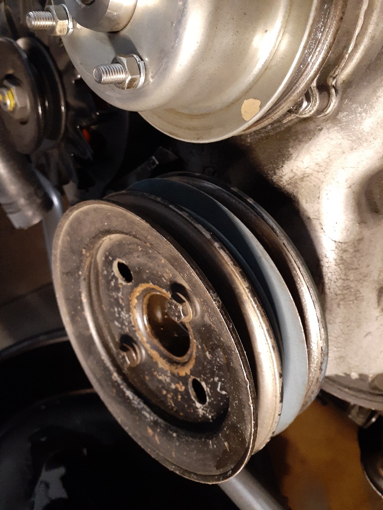

Posted October 31, 20222 yr comment_646915 Hi All, Another general maintenance question. The engine developed the dreaded crank seal leak, fling oil all round the engine bay, good times. Question: The current crank pully is a triple pully (see pic). Removed the smog pump, removed the air conditioner, running a single belt on the balancer. So can I remove the outer two pullies? Will I need a different length crank bolt to reinstall a single pully? See pics of the current bolt has a thick spacer??? Link to comment https://www.classiczcars.com/forums/topic/67949-maintenance-crank-seal-service/ Share on other sites More sharing options...
November 1, 20222 yr comment_646926 Wow.. you got a big spacer on there! Normal would be a 3th of the thickness i think.. 11 hours ago, Blitzed said: So can I remove the outer two pullies? Never seen these pullies but i think it's a 2 pullie with a single one screwed to it? that one on top (on front) you probably can take off.. Then you can still use the orig. bolt to put it back on the engine, you could check the depth of the hole in the crankshaft to check if there is enough space for the bolt-length. but i guess that there would be no problem. Make sure you tighten that bolt with a torque wrench (over 200Nm? no don't know howmuch bigfootsquareinch and feets that is haha) I assume that the whole set of pullies is balanced by balancing the 2 and 1 pullie separate so that would be okay! Link to comment https://www.classiczcars.com/forums/topic/67949-maintenance-crank-seal-service/#findComment-646926 Share on other sites More sharing options...

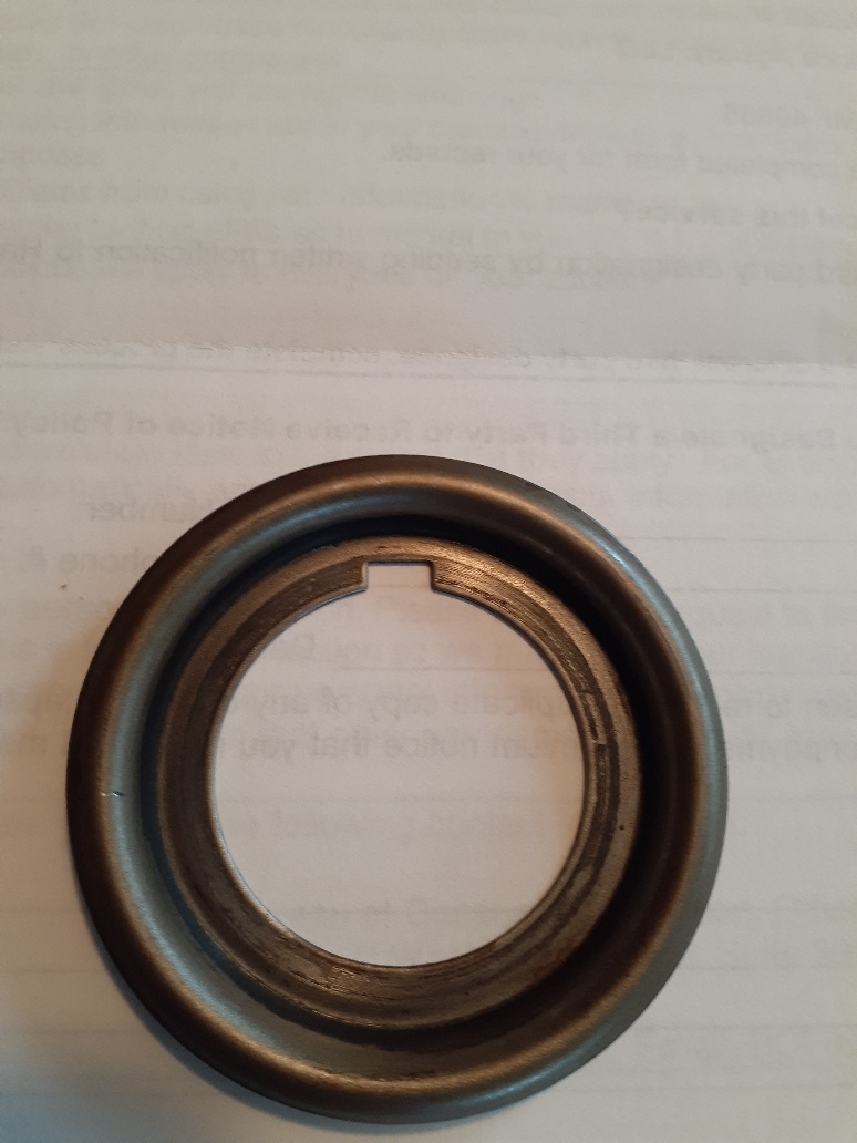

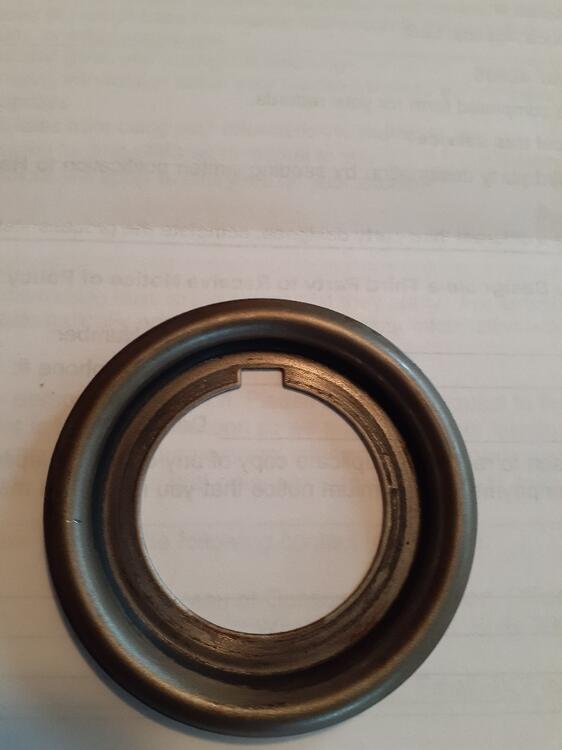

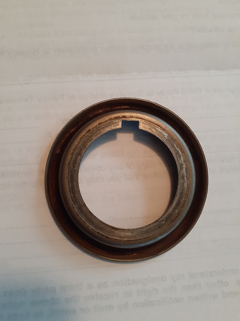

November 2, 20222 yr Author comment_646952 Hi All, Which direction does the oil thrower / slinger reinstall. Cup back or cup forward. Did not pay attention when removed. Read posts you can remove the oil thrower / slinger. What is the purpose of the part? keep oil off the seal? Link to comment https://www.classiczcars.com/forums/topic/67949-maintenance-crank-seal-service/#findComment-646952 Share on other sites More sharing options...
November 2, 20222 yr comment_646953 Your top picture. Cup against the motor. It deflects the oil backwards. Thank's @motorman7 for the picture. Edited November 2, 20222 yr by siteunseen Link to comment https://www.classiczcars.com/forums/topic/67949-maintenance-crank-seal-service/#findComment-646953 Share on other sites More sharing options...
November 2, 20222 yr comment_646954 If you put it on backward, you can't get the oil pump drive shaft to mesh with the crank gear Link to comment https://www.classiczcars.com/forums/topic/67949-maintenance-crank-seal-service/#findComment-646954 Share on other sites More sharing options...
November 2, 20222 yr comment_646955 That's what it does, keeps that worm gear lubricated that the oil pump drive and distributor drive run on. Link to comment https://www.classiczcars.com/forums/topic/67949-maintenance-crank-seal-service/#findComment-646955 Share on other sites More sharing options...

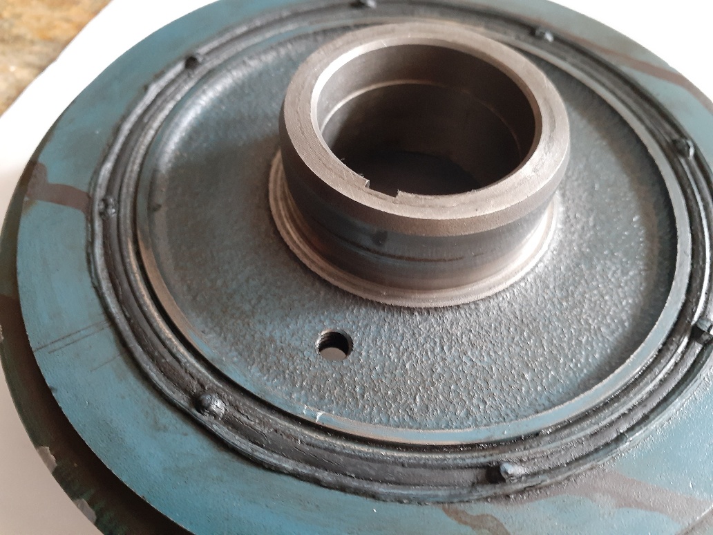

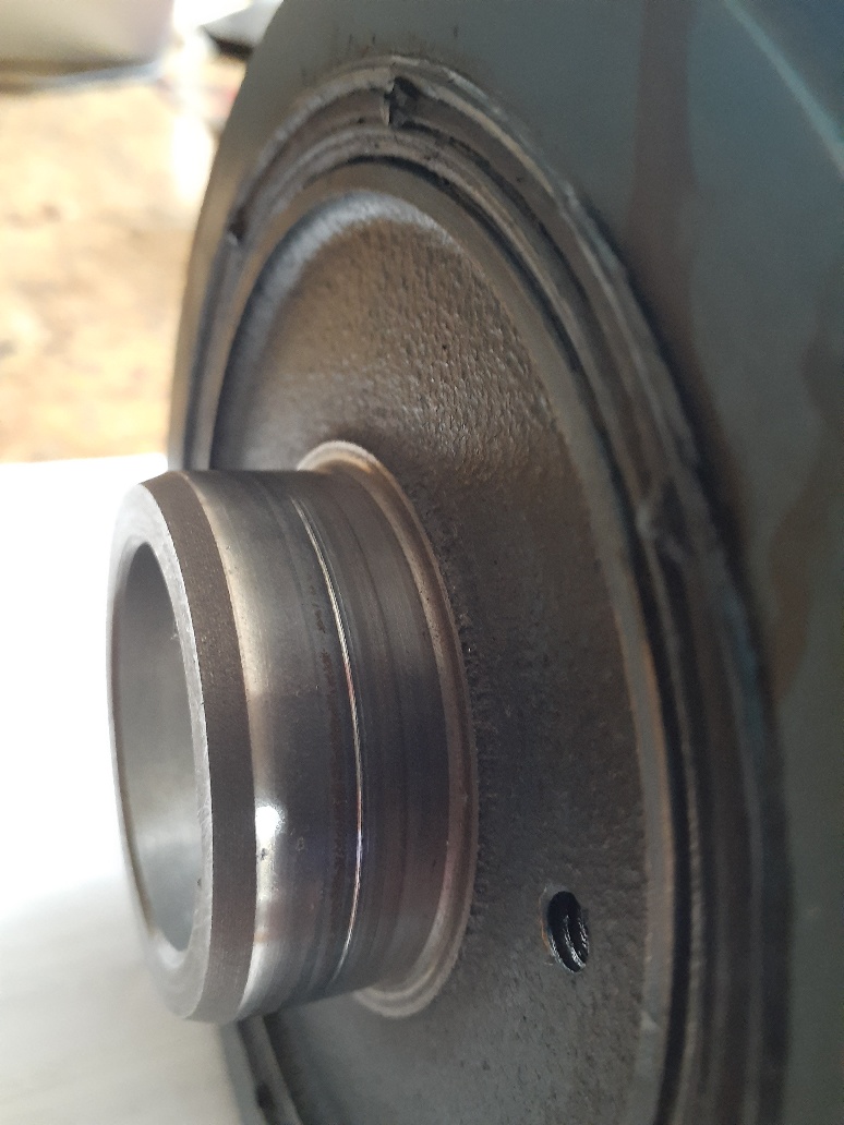

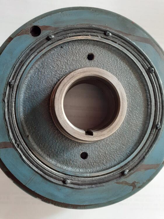

November 2, 20222 yr Author comment_646956 Thanks Siteunseen, visual is great as I'm peering through the timing cover crank hole. Got it, so important to part lubrication. The dampener looks in go shape but I wouldn't know what is damage or bad. No movement, solid. Is the groove on the back sleeve suppose to be there or is this wear? Link to comment https://www.classiczcars.com/forums/topic/67949-maintenance-crank-seal-service/#findComment-646956 Share on other sites More sharing options...
November 2, 20222 yr comment_646957 I think the front cover seal causes that wear. Maybe cheap seal or wrong size? Anyhow some people put a sleeve on. I found this, maybe helpful? Link to comment https://www.classiczcars.com/forums/topic/67949-maintenance-crank-seal-service/#findComment-646957 Share on other sites More sharing options...
November 2, 20222 yr Author comment_646958 Never easy, Thank you. With the added thickness same crank seal required? Link to comment https://www.classiczcars.com/forums/topic/67949-maintenance-crank-seal-service/#findComment-646958 Share on other sites More sharing options...
November 2, 20222 yr comment_646959 I would tag whoever in that thread and ask them. I've not had to sleeve anything on my cars, low miles. Link to comment https://www.classiczcars.com/forums/topic/67949-maintenance-crank-seal-service/#findComment-646959 Share on other sites More sharing options...
November 2, 20222 yr comment_646966 I do believe you can get a repair sleeve for that. This https://www.ebay.com/itm/385131109922?hash=item59ab9a5e22:g:dNkAAOSwuu9jLVv1&amdata=enc%3AAQAHAAAA8Mmzd8Qx%2BQgKiBCruMq60Ch39qBTre9opXhacRBBgAFVTA4WUV8n9h6E1AHSm71h9%2BzzHHKBzOSkpC3OxETALPdXZcXzTBdUNWYoSuaWQdpiJKPY0QpAvLNNHW7Q%2Fs2fe82M6Y76I3PvmnDrSK4Hk87FrDreNeq2vphqHrt87AXOITO7FFQthAEWned0fpKN5omlIQ5nfNIGK%2BVwA%2FXJoy9q4xwZ6uY3L1bks7RjyCUceDxM1KmgWkoKB9kZPA97q%2FK07Ky%2Ba1X%2Bd8GMQWYQ5fwGy%2BERSyij%2Bo4Vpkgzg2tQICwWIjkVeFU9gt5nyfTX%2Bg%3D%3D|tkp%3ABFBMzPLGqIdh I have used these with great results Link to comment https://www.classiczcars.com/forums/topic/67949-maintenance-crank-seal-service/#findComment-646966 Share on other sites More sharing options...
