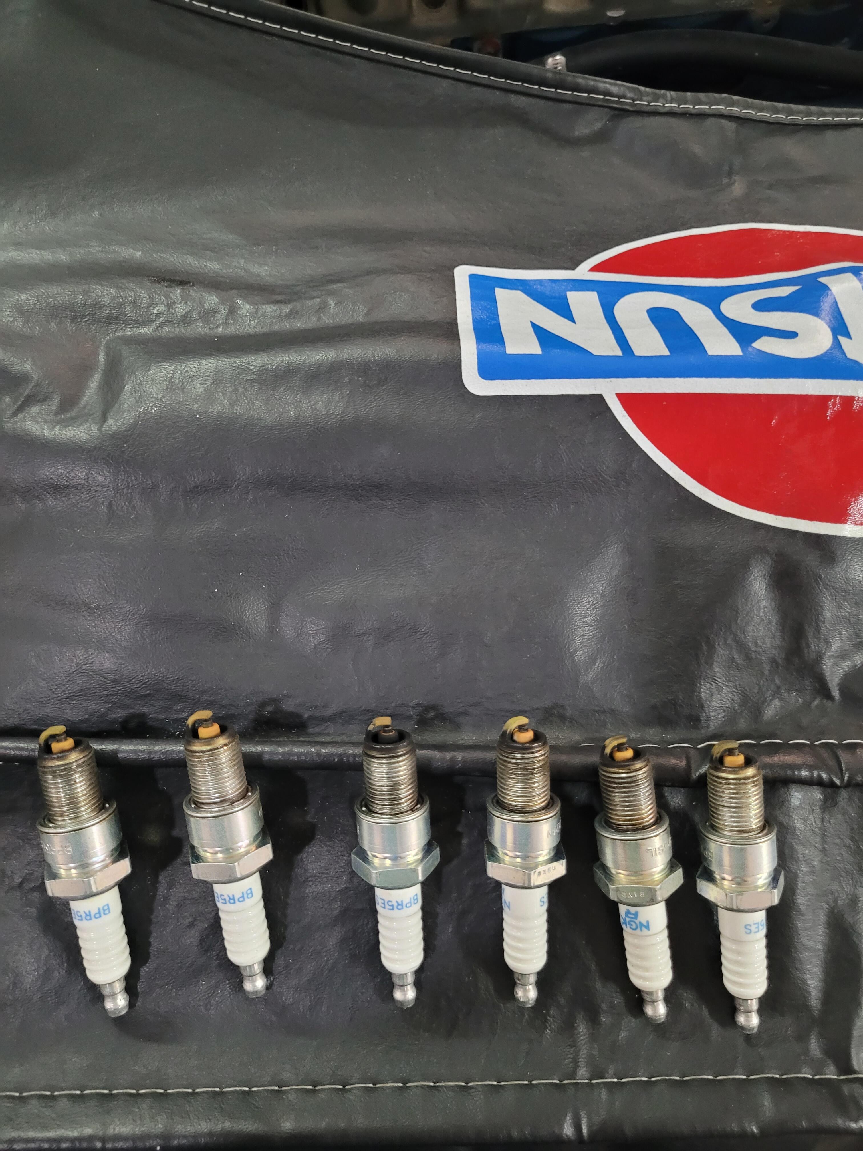

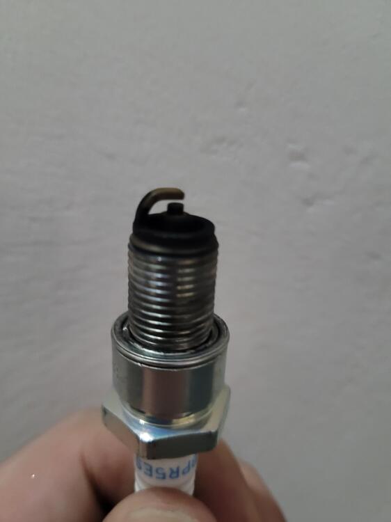

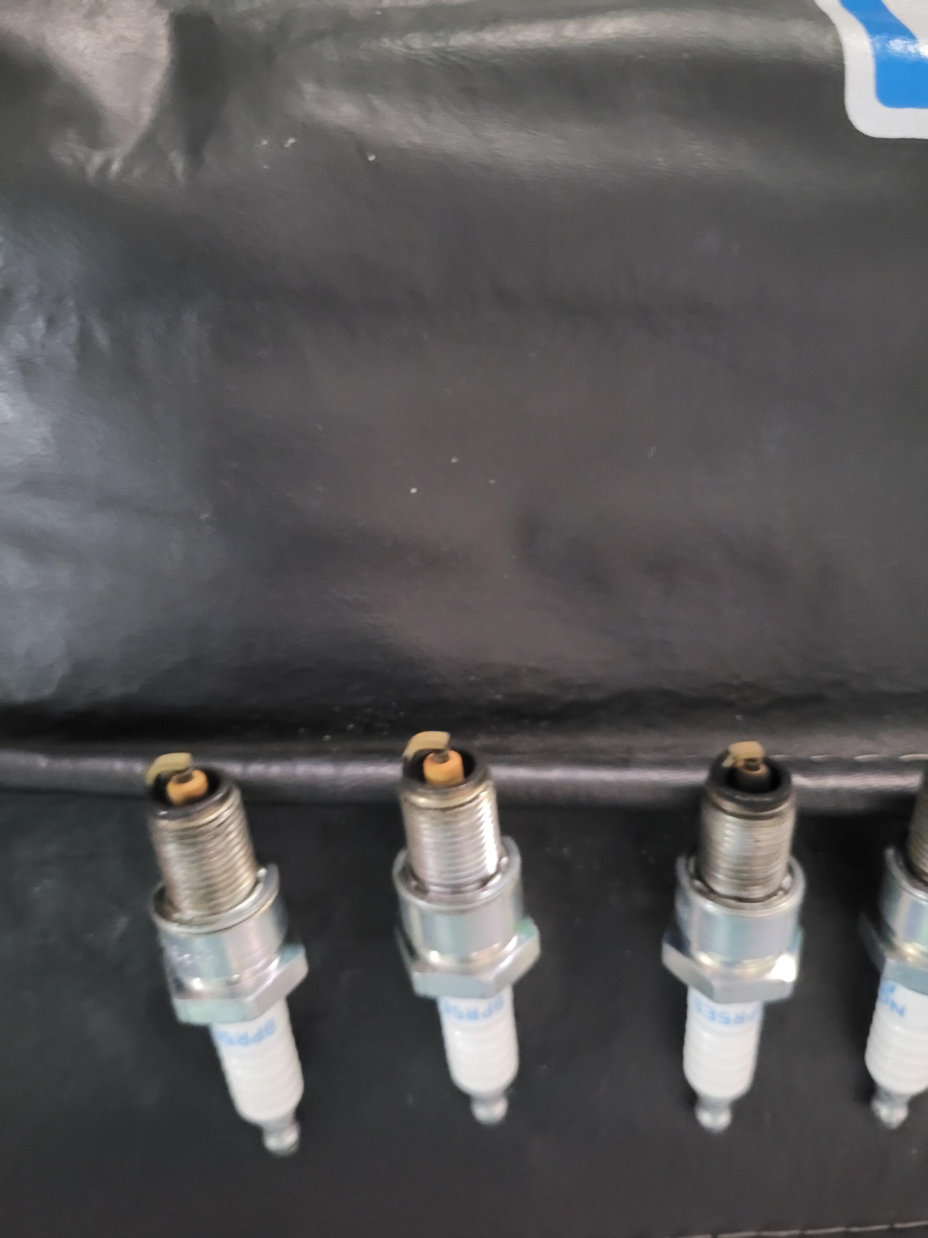

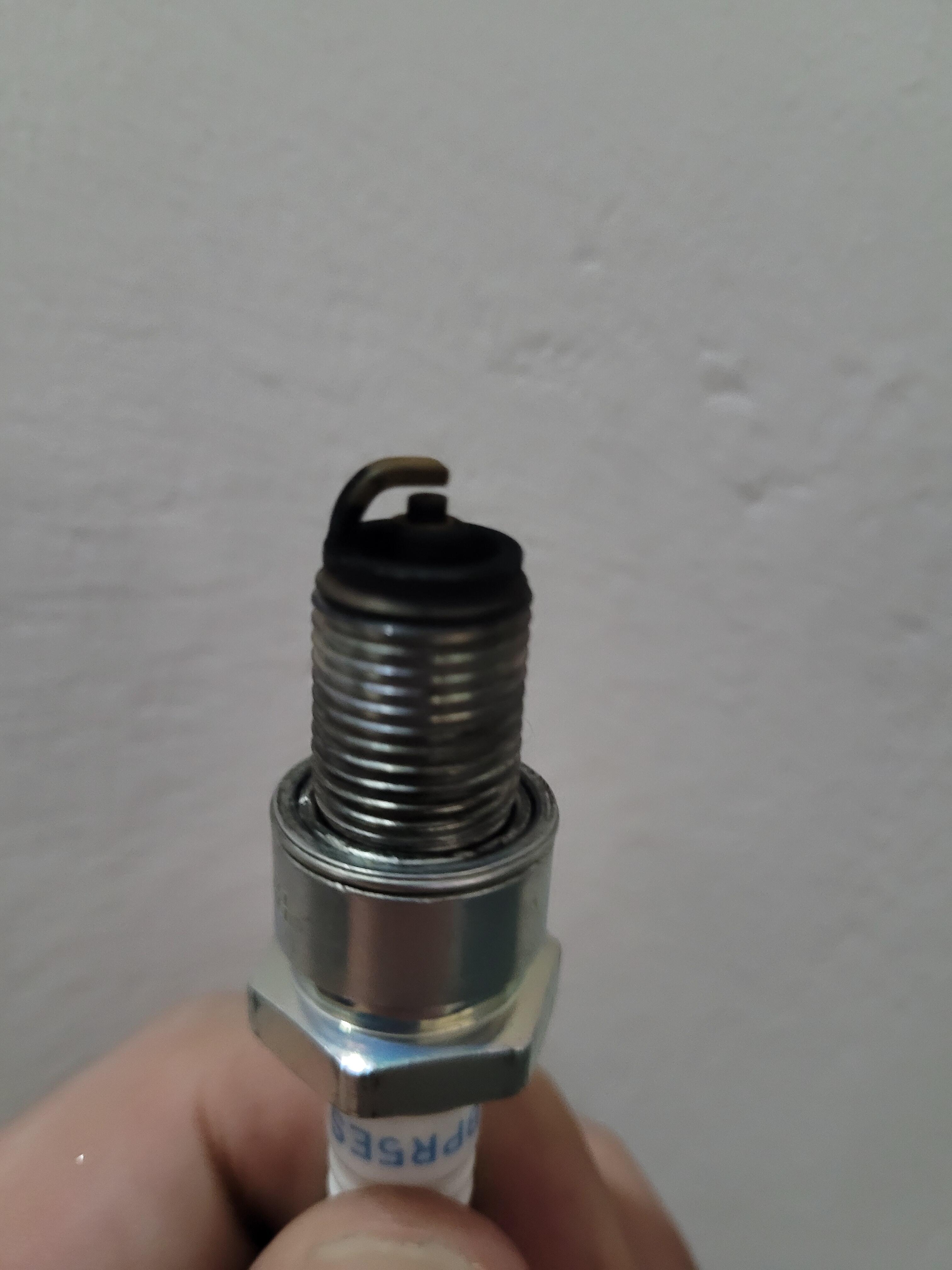

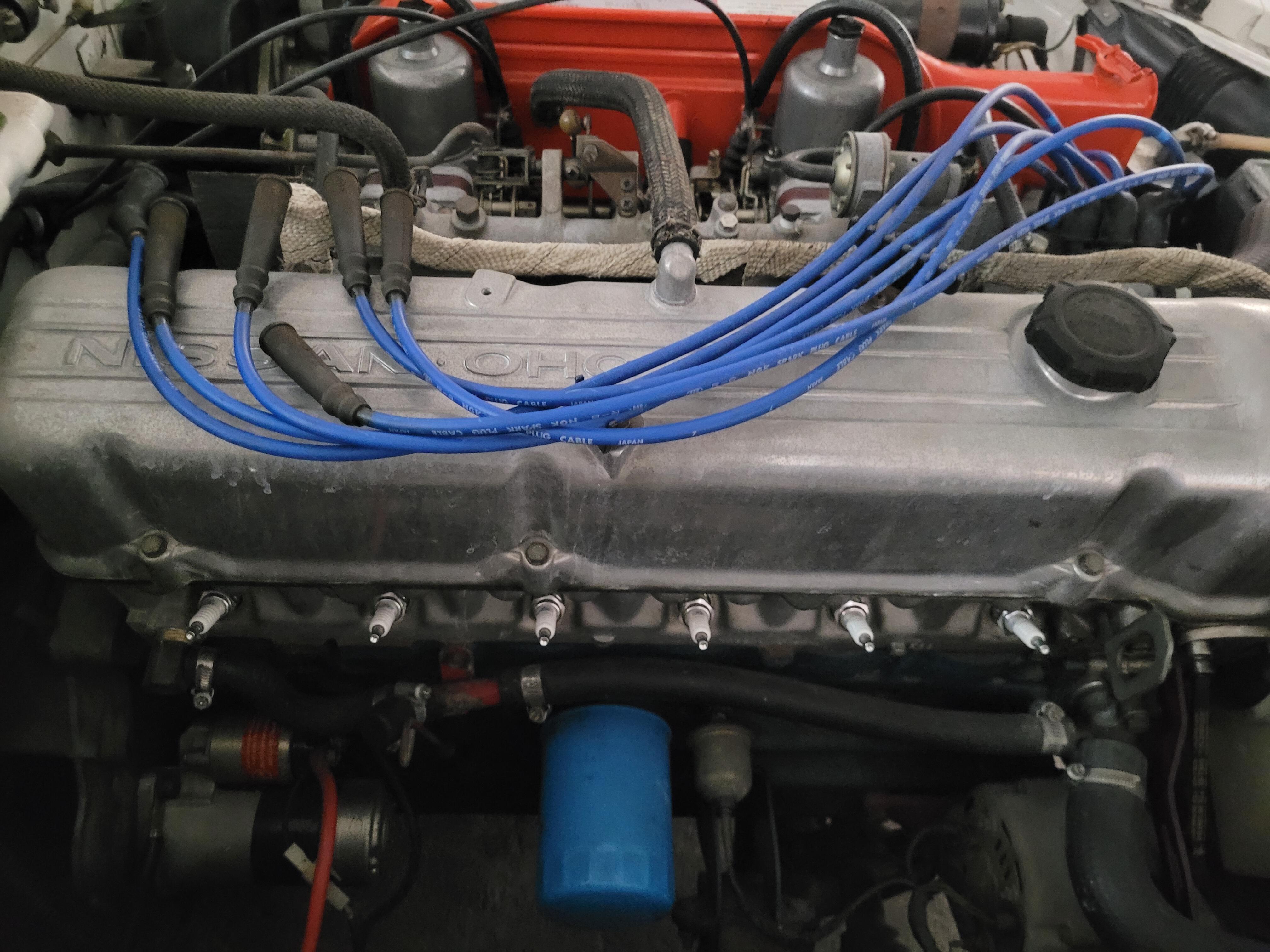

4th plug from right to left still fouls. Im ready to open this engine. Idle gets rough during traffic and clears up once accelerating. Any other thing to consider before breaking the engine?
Yeah, get the parts you need and pull that engine apart.. very interesting to see what the problem is..  Although the compression looks good it could be some broken rings on your No: 4 piston or something like that..
