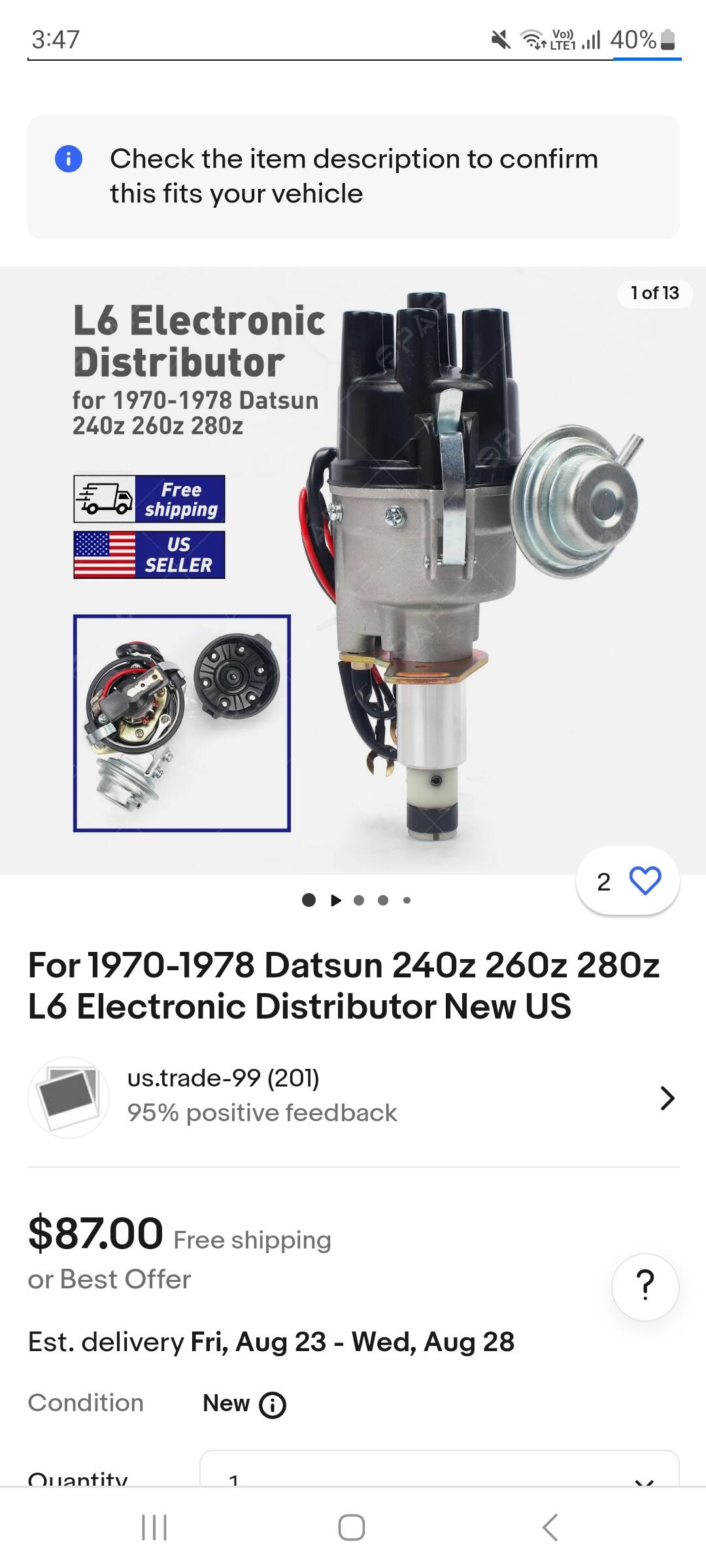

If a new single point distributor will solve this fouling will this one fit and work with my 1972 240z manual transmission?
Post a link to the distributor not a screen shot
He has tested leads, caps plugs, pretty much everything. The only thing he hasn't done is remove the pertronix from the system.
You could just replace the dizzy and see if that fixes the problem. If not then plug wires and coil last...

Jalex's NGK plug wires are almost new. I like the idea of replacing the dizzy. Will the coil he's currently using (snort) be OK with the new dizzy?
I agree, although new doesn't always mean good. I would start with the dizzy. I think if the coil was the problem then it would be more even across all the cylinders. Although the lastest fouling could indicate a broader problem.
