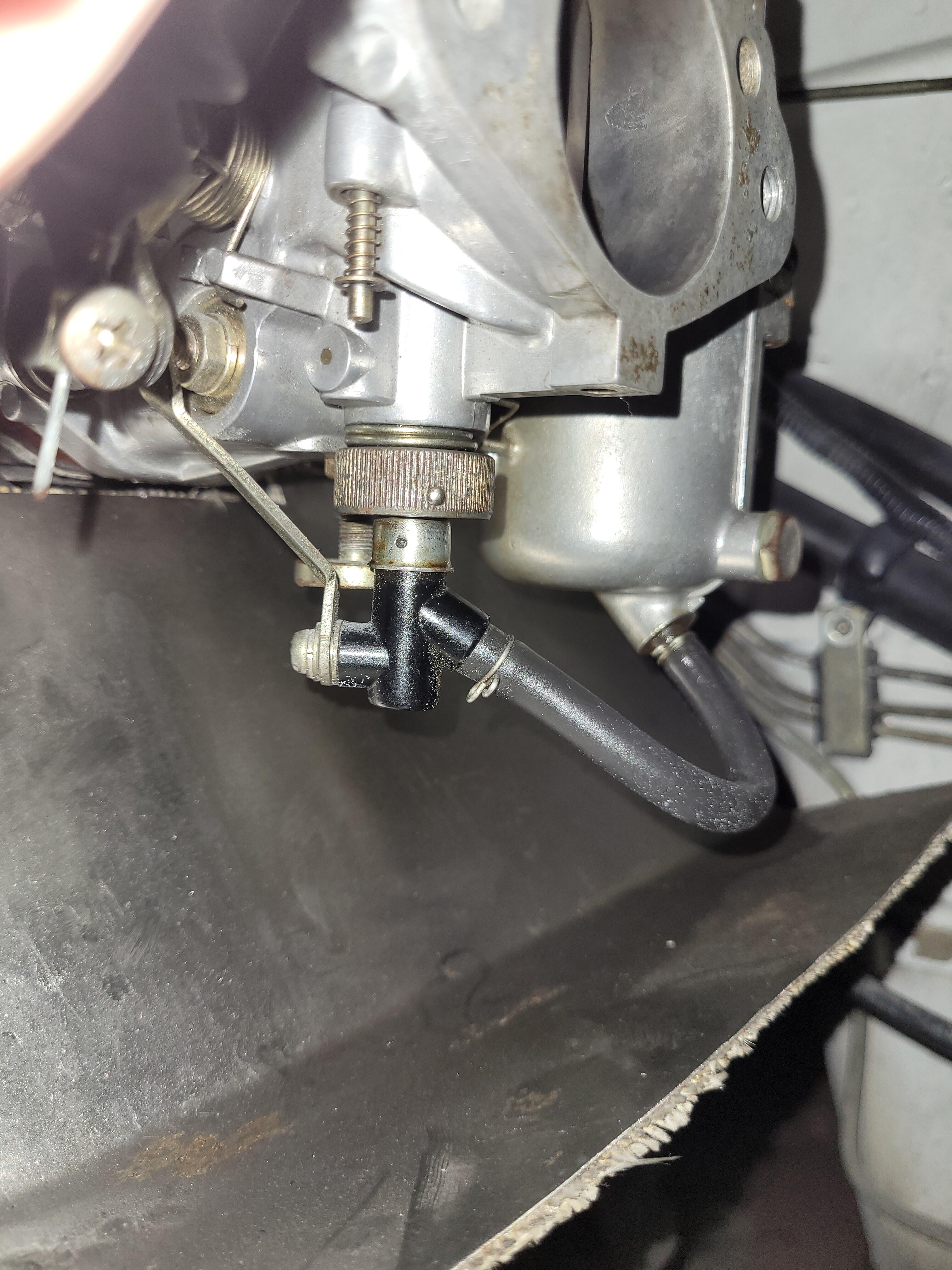

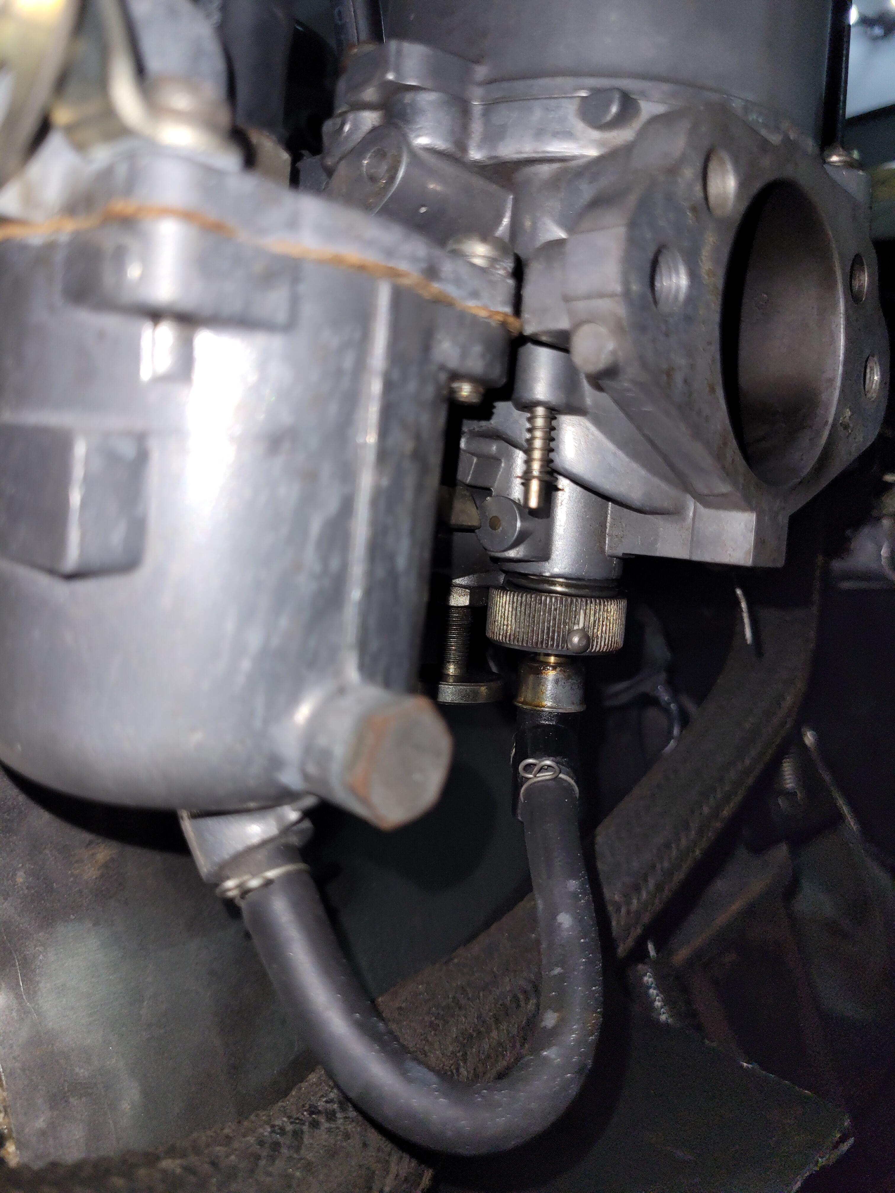

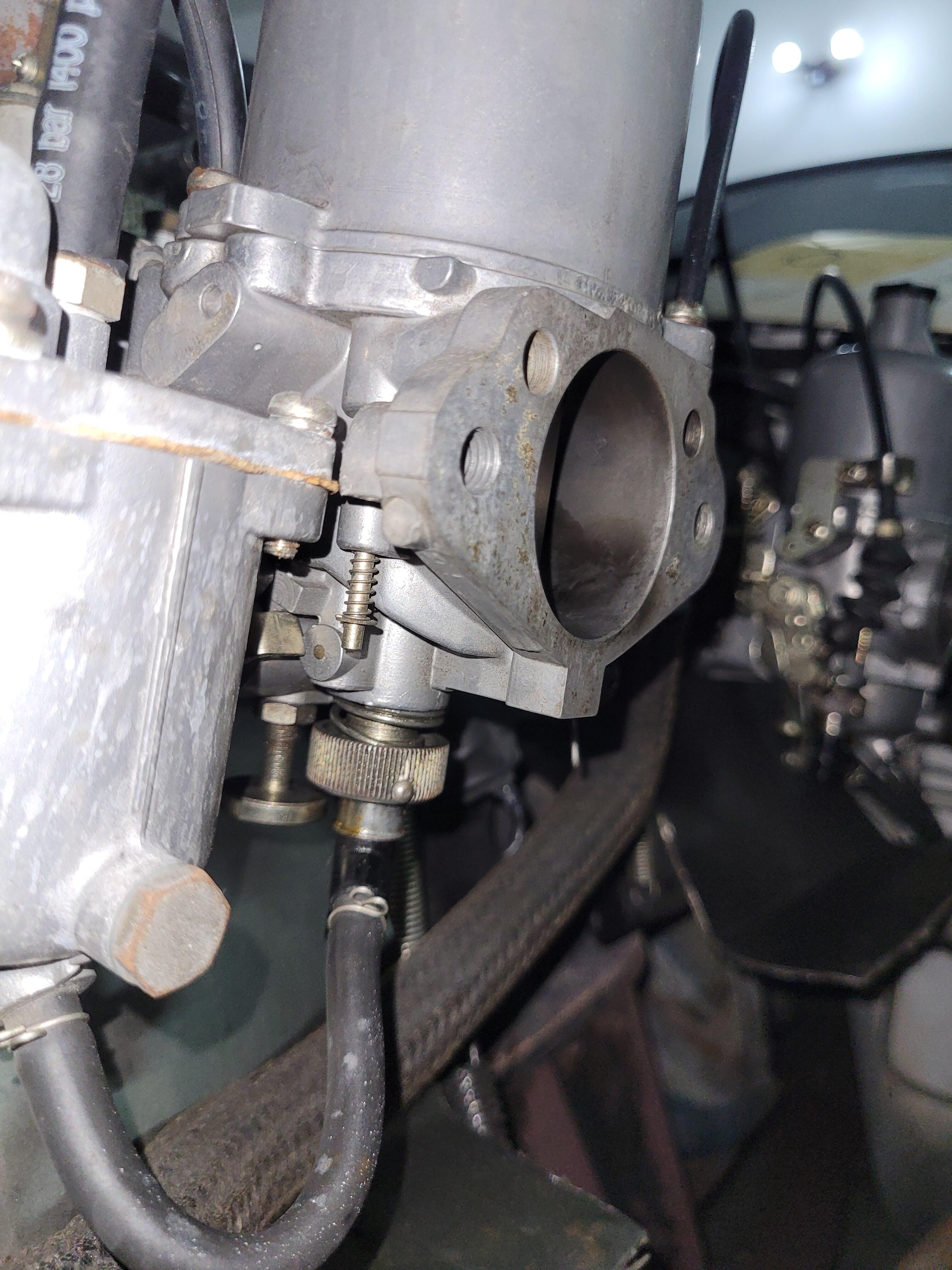

For the sake of order. I closed the jets and dialed them back to 3 turns clockwise each looking from above meaning the jet goes down. I have taken pics the fuel jet closed and opened to 3 turns each. Carbs balanced and rpm at 900. Should i go for a spin just as it is or should i put the air filter on?

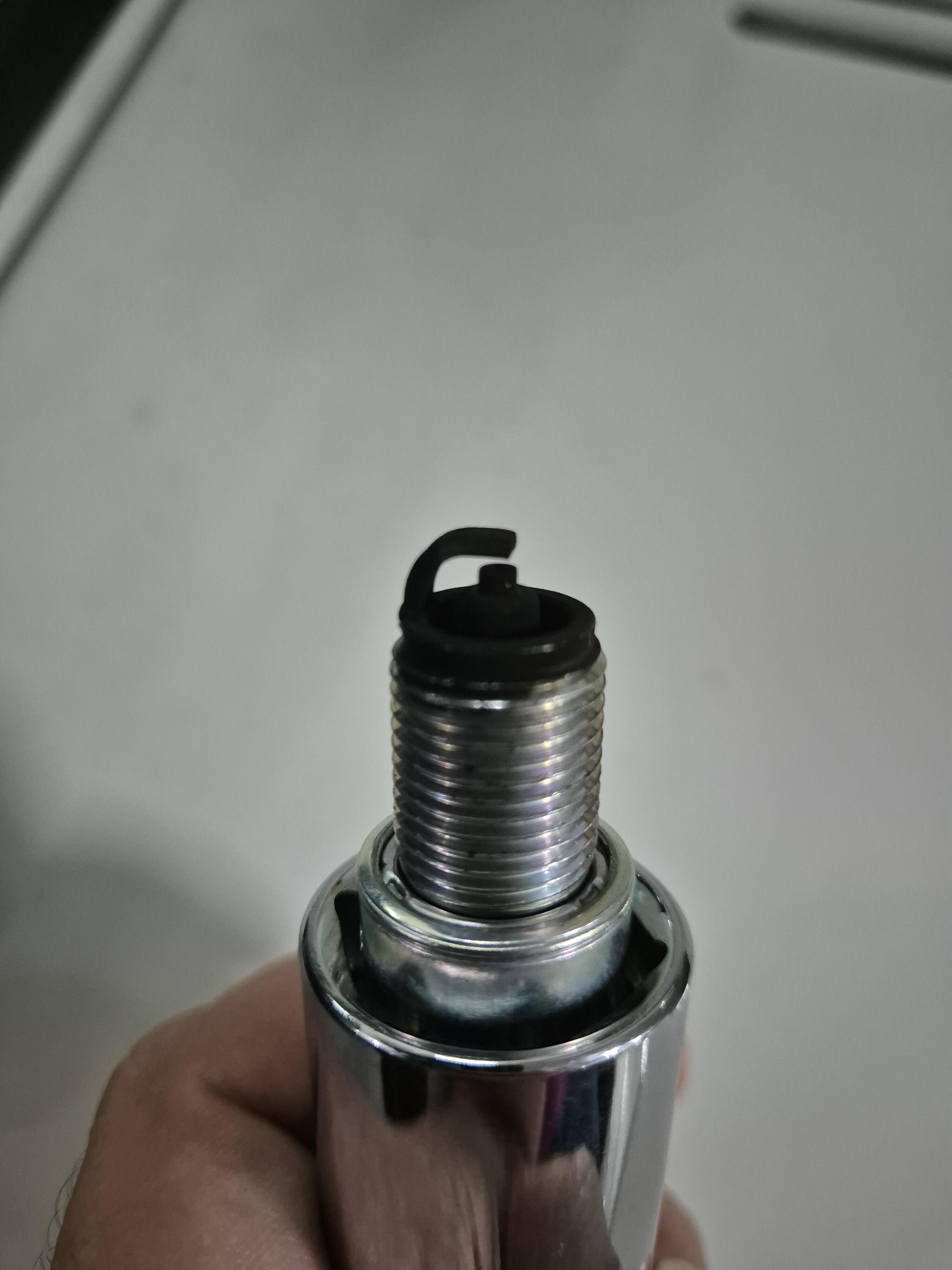

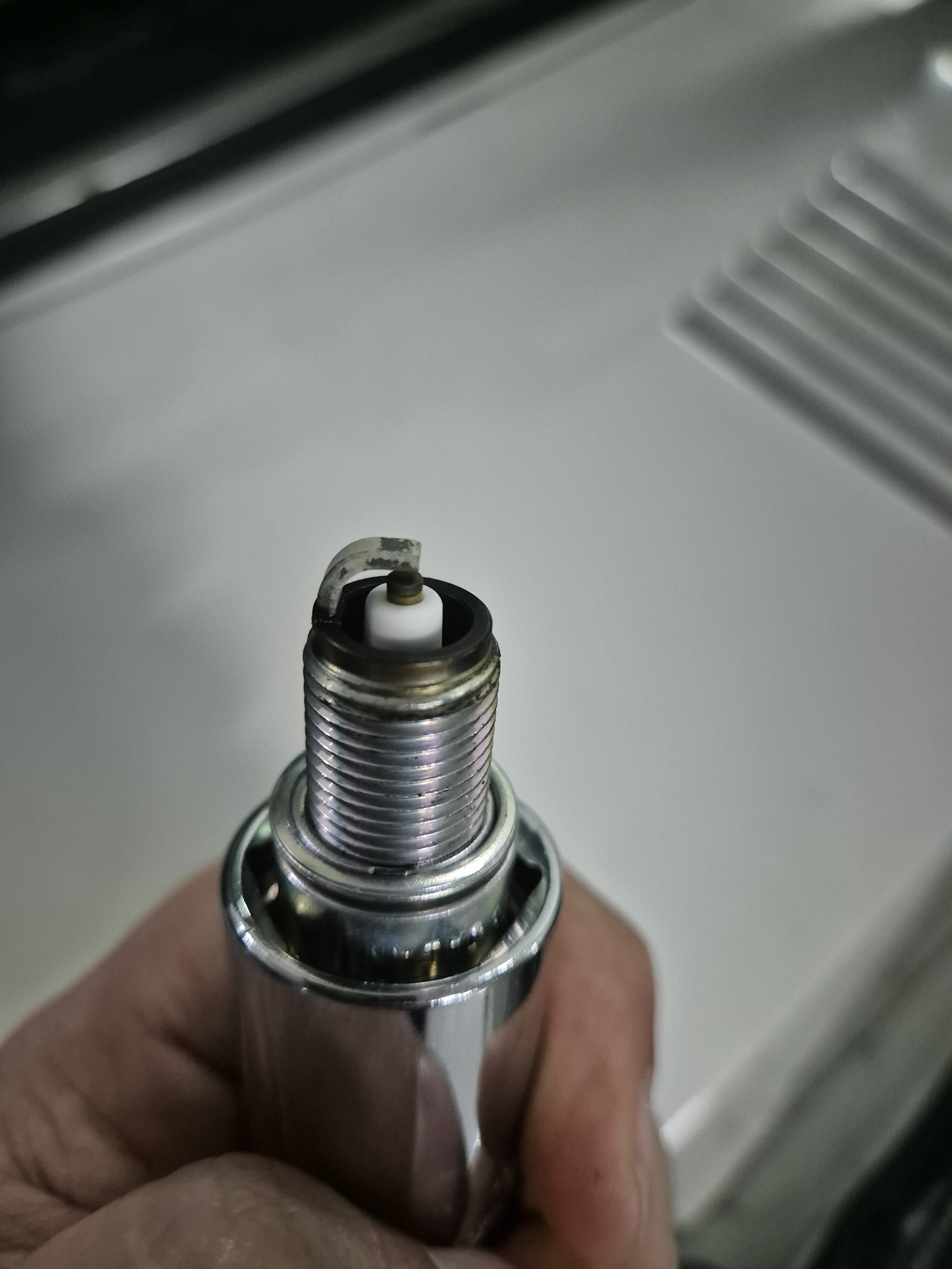

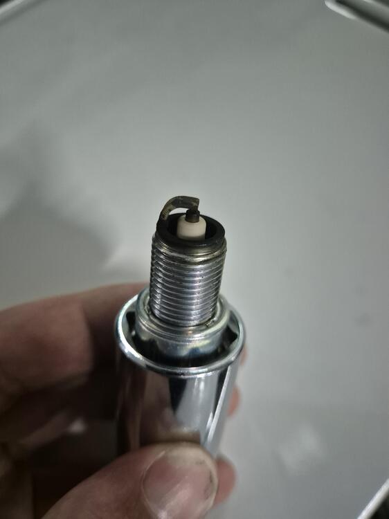

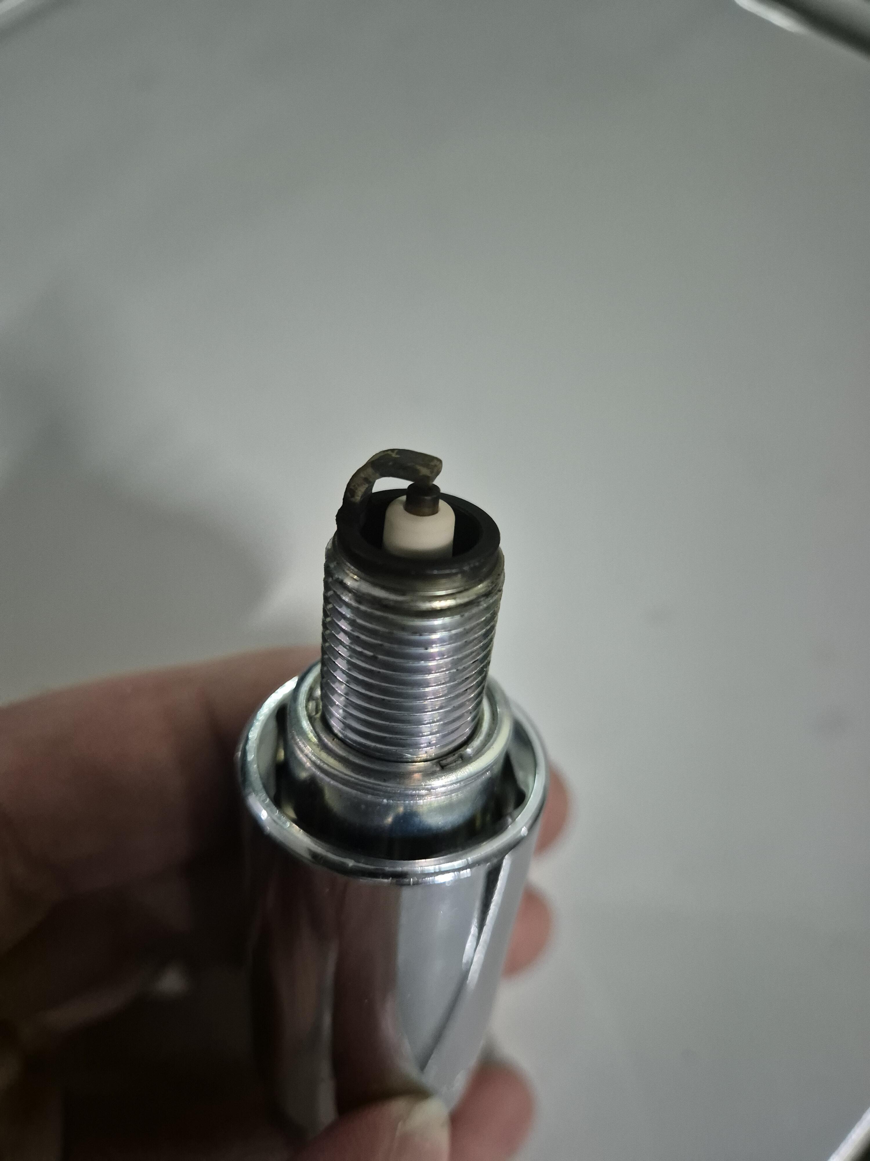

On 8/17/2024 at 1:51 PM, siteunseen said:
Fuel fire and air
You have the fuel checked off, it's good. You have the air filter housing off so no restrictions there. You should focus on the fire or electrical now that all 6 are black and sooty. It could be a loose wire since all of the sudden the spark plugs went black.
Did it not start running bad all at once? It should have after looking at the before plugs and the newest pictures.
Have a good weekend.

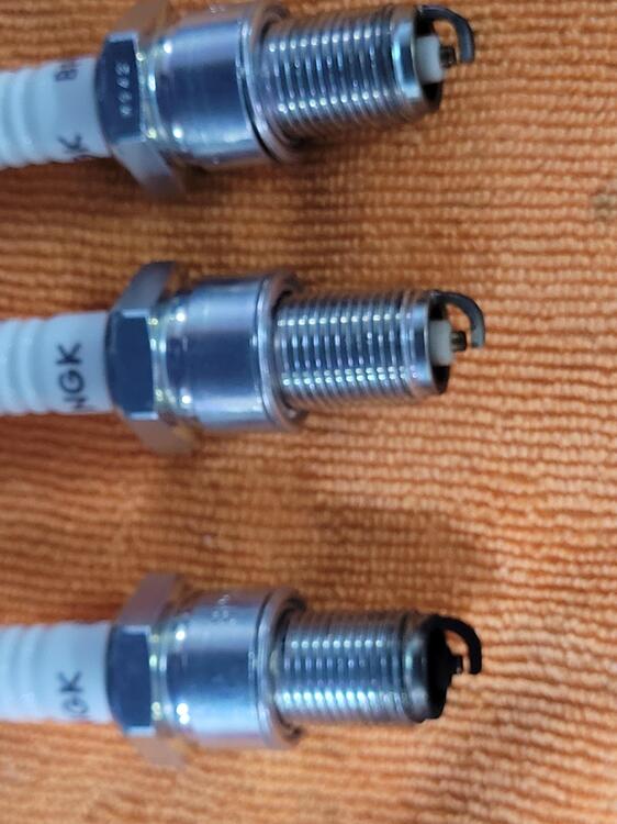

Site and Mark,
I set both jets at 3.25 turns clockwise and as a result only cyl 4 came out black and sooty after driving the car and temporary idling on red lights. Should i consider uaing a non fouler on cyl 4?
Lets not forget this is a California Datsun engine!
That's probably the root of the problems!  After these years, I would have just purchased another engine with the stock cam and not messed up by a builder that doesn't know what they're doing.
