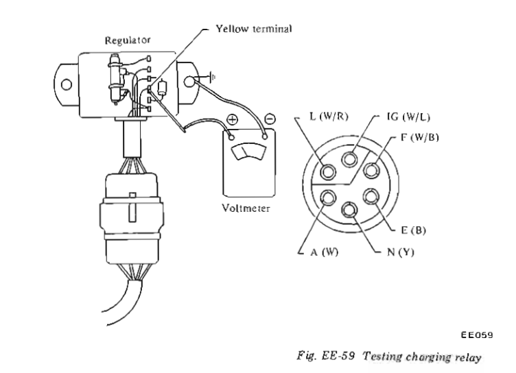

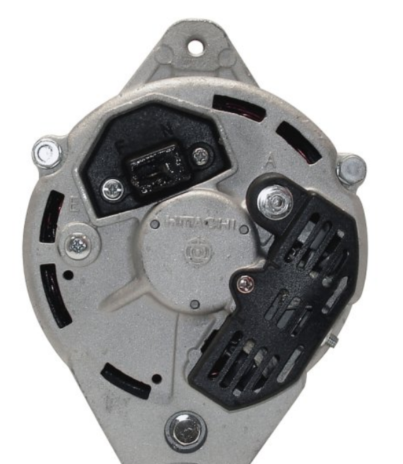

Didn't find a specific test but did find a drawing.  I think that "A" might be stamped in to the back of the alternator.  Set your meter to resistance and measure between the A terminal on the back of the alternator and the alternator body.  It should be infinite resistance.  OL.
If you measure low resistance from A to ground then your alternator is probably bad.
BUT.  It could also be the wiring.  Check resistance from the A terminal in the harness to ground with both the VR and the alternator unplugged.
No offense intended, but this is one of those cases showing why people should get familiar with how their meter works, when everything is working right.  This problem is really kind of a "measure...check, measure...check, measure" kind of problem.  Simple things to check to narrow the problem down to a certain area.  Many of us have a list in our heads and once the meter is in hand it's just check, check, check, fault.
You can even check resistance through the pins of the VR.  I was going to suggest to SteveJ that he do that before he sends out his unused VR.  Check resistance from the battery feed pins to ground.  If it's open there should be no draw caused by the VR.  If SteveJ was at your car he probably would have done this already.  The meter is your friend.
Some of the stuff I wrote above is probably wrong for this specific case.  Because A is also usually connected to the battery positive post.  So if it was shorting through the alternator it would short even with the VR unplugged.  It's just one of those things to check overall.
So, in sum, it still kind of looks like a bad VR.  IF the wiring is not shorted to ground somewhere.

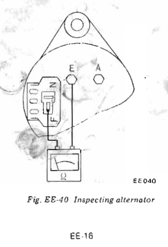

If the VR is bad, I would expect to see voltage to ground on the F terminal of the alternator all of the time when everything is connected. That is the white wire. If there is voltage to ground at the F terminal when everything is connected, then disconnect the two wire connector at the alternator and see if there is still voltage to ground at the F terminal. If there is not, there is your proof.
That makes sense. Like I was saying before, the voltage regulator is trying to excite the field of the alternator to produce voltage even when the car is off. The way it works is that when you are trying to raise the voltage of the alternator you inject current (This is your current draw.) into the field coil.
