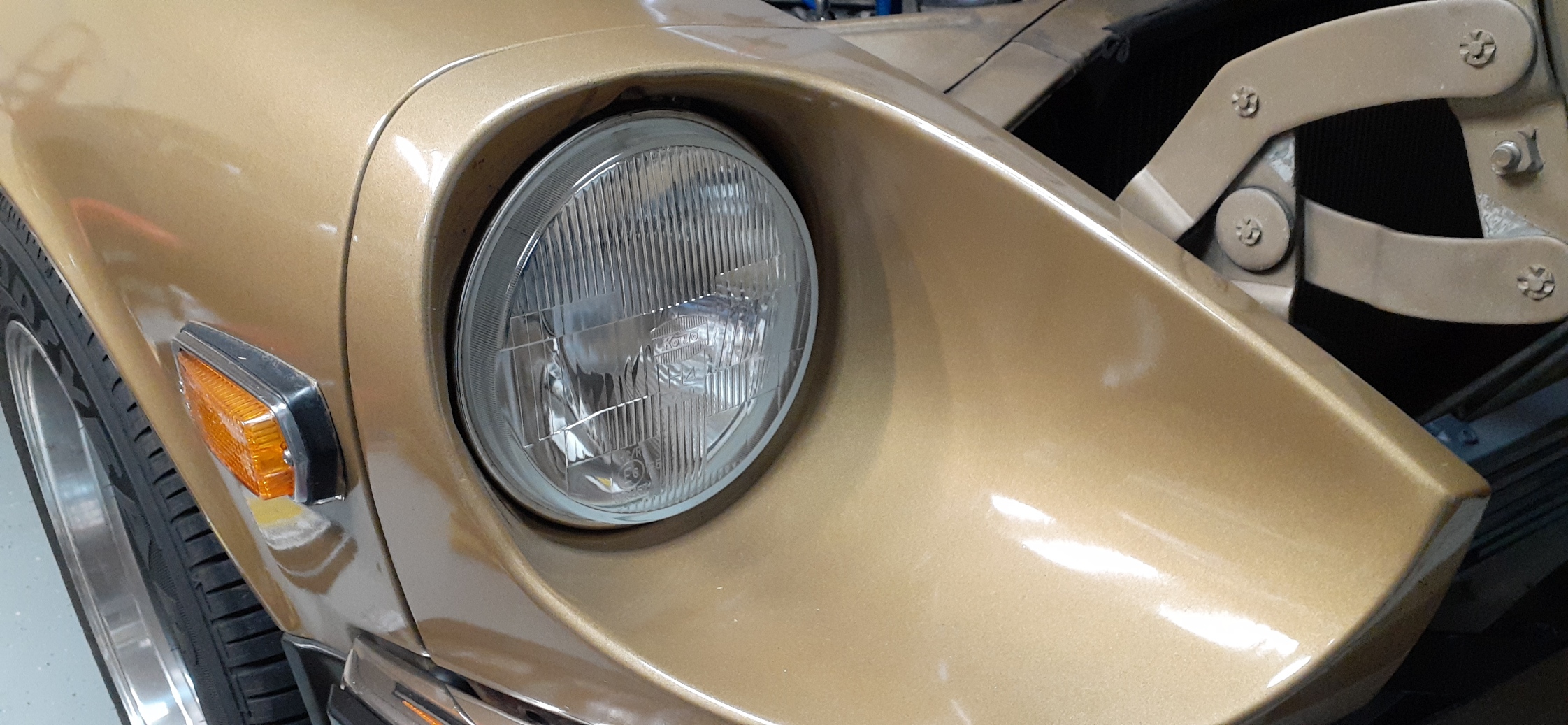

December 2, 20222 yr comment_647759 On 11/22/2022 at 10:54 PM, SpeedRoo said: Yes I need the headlight scoops, the ones on 03802 are metal for some reason and have tabs for perspex covers. Also after the Koito headlights, may fit the upgraded H4 Koitos. I like your idea for the Libres. I installed the Koito H4 housings with Auxito H4 LED bulbs in my 260Z a couple of days ago. I had been using the Auxito bulbs with a set of H4 housings I picked up from Black Dragon many years ago, but I didn't like the appearance. Link to comment https://www.classiczcars.com/forums/topic/67993-51970-240z-03802/?&page=2#findComment-647759 Share on other sites More sharing options...
December 2, 20222 yr Author comment_647760 Thanks @SteveJ appreciate the feedback. Any tricks to fitting them or were they plug and play? Link to comment https://www.classiczcars.com/forums/topic/67993-51970-240z-03802/?&page=2#findComment-647760 Share on other sites More sharing options...
December 2, 20222 yr comment_647761 3 minutes ago, SpeedRoo said: Thanks @SteveJ appreciate the feedback. Any tricks to fitting them or were they plug and play? They are essentially plug and play. You will need to back out the screws on the retaining ring a fair amount to get everything lined up right for reassembly. Link to comment https://www.classiczcars.com/forums/topic/67993-51970-240z-03802/?&page=2#findComment-647761 Share on other sites More sharing options...

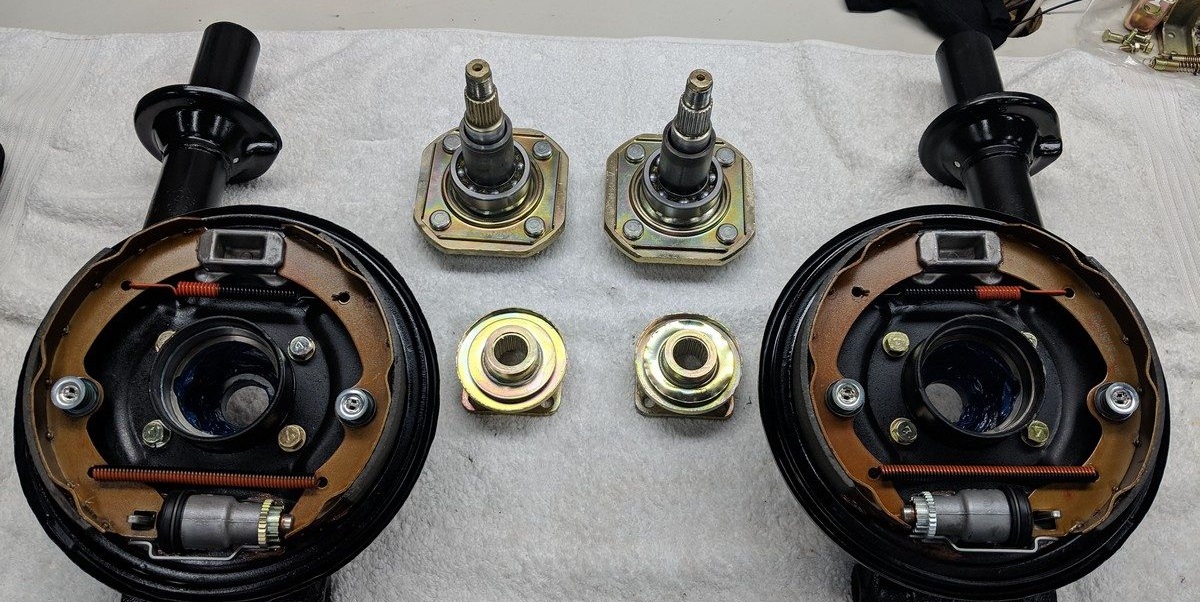

December 5, 20222 yr Author comment_647915 Progress on engine dismantling, everything came apart easily. No broken bolts or anything seized in place. Block stripped down to be boiled out before painting in Datsun "Blue". Started work on rear brakes. Have new Nissan/Datsun hardware and NOS Datsun Akebono brake shoes. Rear hubs disassembled and NOS Datsun bearings prepared to be pressed in place. Question, should the rear inner hub flange be black or gold zinc plated like in the attached picture? Â Edited December 5, 20222 yr by SpeedRoo Link to comment https://www.classiczcars.com/forums/topic/67993-51970-240z-03802/?&page=2#findComment-647915 Share on other sites More sharing options...

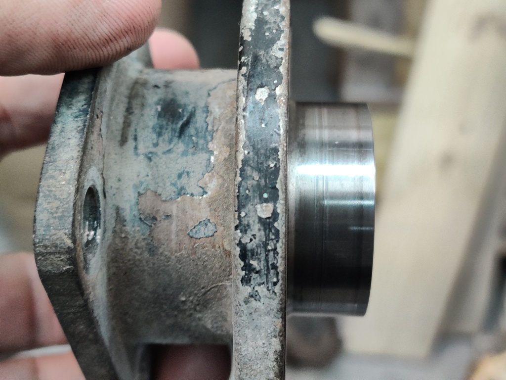

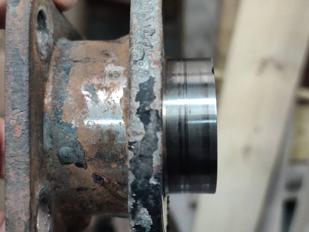

December 22, 20222 yr comment_648530 On 12/5/2022 at 6:10 PM, SpeedRoo said: Progress on engine dismantling, everything came apart easily. No broken bolts or anything seized in place. Block stripped down to be boiled out before painting in Datsun "Blue". Started work on rear brakes. Have new Nissan/Datsun hardware and NOS Datsun Akebono brake shoes. Rear hubs disassembled and NOS Datsun bearings prepared to be pressed in place. Question, should the rear inner hub flange be black or gold zinc plated like in the attached picture?  As removed from my 6/71 car that lived in AZ for an unknown amount of time, and was subsequently stored (non-operational) in a garage near Denver CO for over 25 years.    So, painted black from the factory. Edited December 27, 20222 yr by inline6 Link to comment https://www.classiczcars.com/forums/topic/67993-51970-240z-03802/?&page=2#findComment-648530 Share on other sites More sharing options...
December 25, 20222 yr Author comment_648648 On 12/21/2022 at 8:26 PM, inline6 said: As removed from my 6/71 car that lived in AZ and was subsequently stored in a garage near Denver CO.    So, painted black from the factory. Thanks @inline6 black it is. Link to comment https://www.classiczcars.com/forums/topic/67993-51970-240z-03802/?&page=2#findComment-648648 Share on other sites More sharing options...
