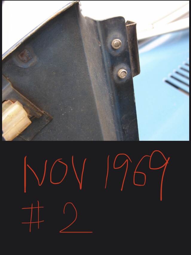

December 3, 20222 yr comment_647780 13 hours ago, siteunseen said: There's one with a single dot, the others have two. I'd like to learn more The one with the single dot is a "misprint" the other dot just fell "into the groove".. (Haha..madonna!!) 😂 I don't know why it has 2 dots.. maybe someone wanted to give their nuts and bolts this so they can recognize their own bolts and screws? (or maybe they are extra hard or strong..) Link to comment https://www.classiczcars.com/forums/topic/68006-240z-restorations-whats-right-and-whats-not/?&page=5#findComment-647780 Share on other sites More sharing options...
December 3, 20222 yr comment_647781 13 hours ago, siteunseen said: I learned something new today. I've never noticed the dot on the heads of screws but found it interesting and then I saw this picture that @HS30-HÂ posted and was perplexed (as usual) by the dots in his photo. There's one with a single dot, the others have two. I'd like to learn more. Hopefully someone knows the story better? Since that's an electrical part from a Works rally car, I would not place too much faith in any level of industrial standardisation being directly applicable. They are a law unto themselves! A lot of that stuff was either hand-made or involved some level of modification over stock. I doubt the dots on those screw heads are anything to do with JIS standards. Link to comment https://www.classiczcars.com/forums/topic/68006-240z-restorations-whats-right-and-whats-not/?&page=5#findComment-647781 Share on other sites More sharing options...

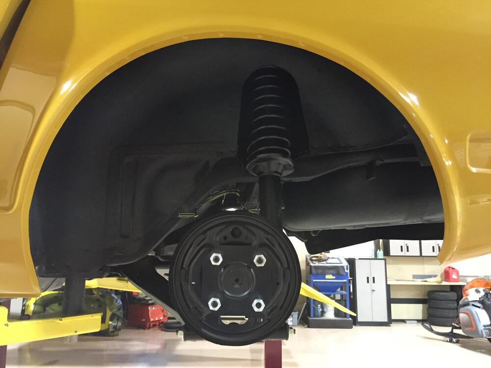

December 3, 20222 yr Author comment_647787 What's the correct finish for the rear hubs, BAT car has them painted? Â They look to be unpainted in the service manual, other than the center piece that is exposed when the brake drum is fitted. Edited December 3, 20222 yr by SpeedRoo Link to comment https://www.classiczcars.com/forums/topic/68006-240z-restorations-whats-right-and-whats-not/?&page=5#findComment-647787 Share on other sites More sharing options...

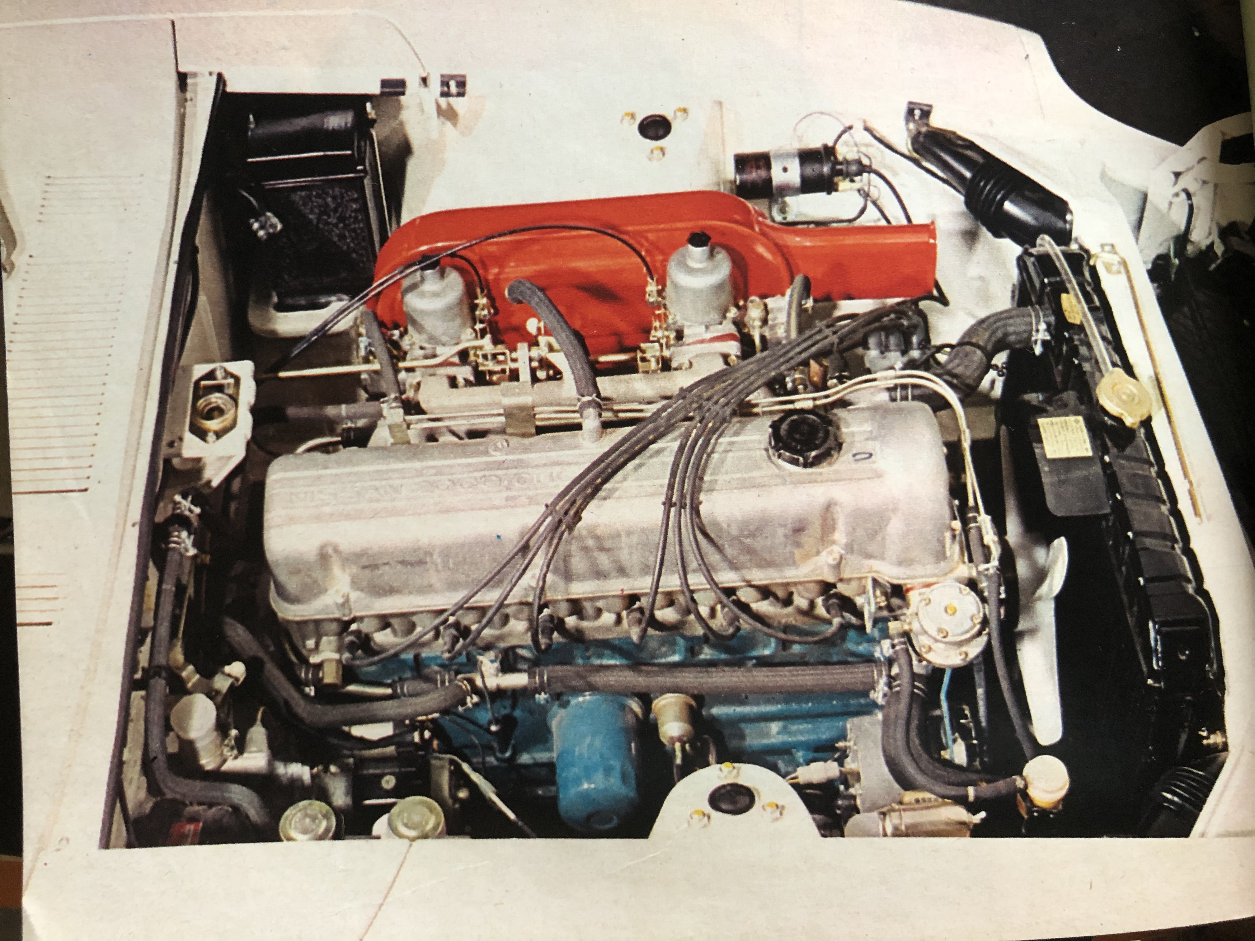

December 4, 20222 yr comment_647825 Hi, these pictures might be helpful for this discussion.From Motor Magazine February 1970 . We can confirm parts, colors, how they are fitted by workers in assembly lines. Although this car is a L20 model but mostly the same parts are used for a L24 models. But this white Fairlady Z-L is a bit early made to compare with the BAT car. Because of absence of the hood bumpers, and the shape of the small rubber tab of the inspection lid . This indicates this white car could be very early like made in October 1969. Kats Link to comment https://www.classiczcars.com/forums/topic/68006-240z-restorations-whats-right-and-whats-not/?&page=5#findComment-647825 Share on other sites More sharing options...

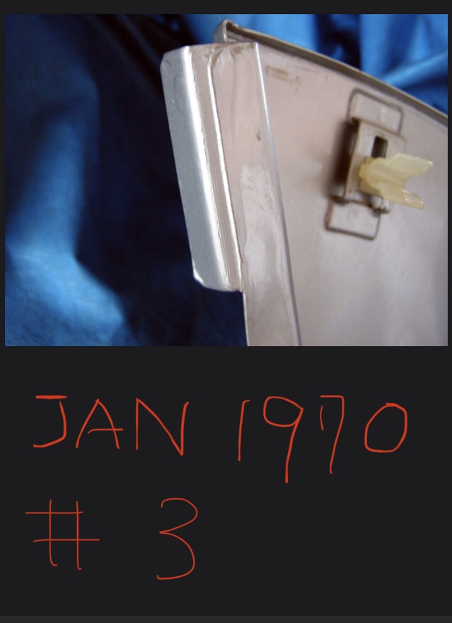

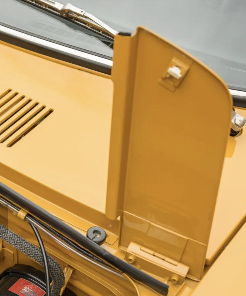

December 4, 20222 yr comment_647826 We discussed this before, early 4 steps of the inspection lid. January 1970 would have #3 version of the lid which has a tab welded to the lid. Seems to me the BAT car has a #4 version which is designed in ONE PIECE with the small tab. Also a rubber cushion is attached a little bit different style from #4 version. So, if this HLS30-01606 has the #4 lid from the beginning, I will tend to think January 1970 was a very complicated month for our Z cars. And this car could be very late of January or maybe touching February . Do we think tar mats on the rear deck was applied from January 1970 ? I am curious about it.  I must say this first, this BAT car is an incredible car with a lot of time and money , and passion were put in. Nice car ! Kats   Kats  Link to comment https://www.classiczcars.com/forums/topic/68006-240z-restorations-whats-right-and-whats-not/?&page=5#findComment-647826 Share on other sites More sharing options...
