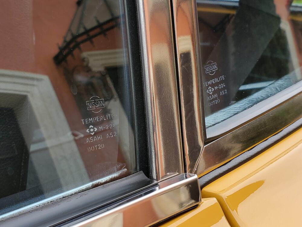

1 hour ago, kats said:
Sorry I was mistaken the car, the picture of the door glass “April 1973 “ is for the 1973 240Z, so it is correct.
I checked HLS30-01606, the car has correct glasses. Like most of other parts, the date is a little bit earlier than the door jam tag.
Kats
HI Kats,
How is the date read from the Nissan Temperlite etch please?  I have the etches on the CSP glass, so it would be interesting/helpful from that side.  Thanks.
@kats I think I have worked out the date codes for the glass. If you look carefully the small dots "." are placed differently for the date. On "01606", a Jan 1970 that was on BAT there are three dots, one after Temperlite, just in front of ASAHI, under the "I" in ASAHI. They signify Dec 1969.
On the 1973 Green 240Z currently on BAT you can see the dots are in a different position to "01606"
Hi Ian, sorry I fallen asleep before explaining about how to. SpeedRoo is correct, the position of dots are telling year and month.
Here is a link when I posted about it,
I think other cars have definitely the same markings. So you can find out when your glasses were made Ian !
Kats
