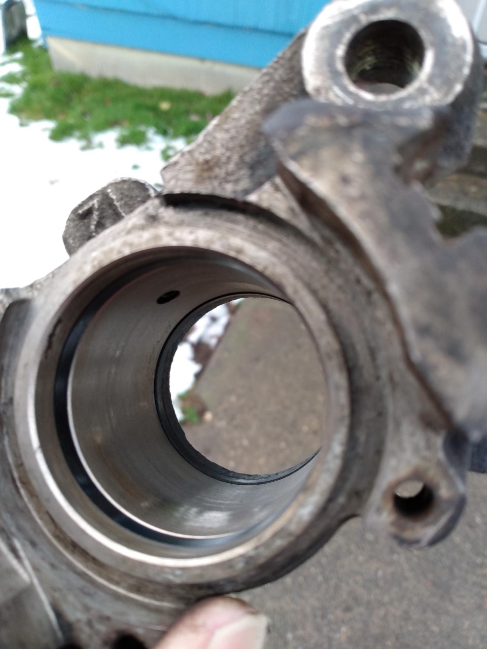

After my last drive my friend noticed a little bit of brake fluid under the left rear wheel after getting it tucked back into the garage.  With brake fluid being pretty much being made of Xenomorph blood I decided to tear into it sooner rather than later.  It was soon obvious that the leak was coming from a failed caliper seal.  No huge surprise as the rear calipers are the only things on the brake system that I have not gone through and replaced/reconditioned.

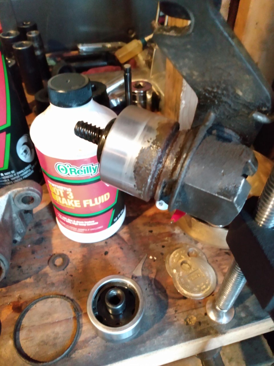

Sadly, upon disassembly I discovered quite a bit of rot on the inner facing piston.  Probably not a good idea to re use it.  Banking on the right side being in close to the same condition.  Luckily I have that parts car.  Unluckily it's buried in snow with wet yard underneath it.  I wouldn't be surprised if the parts car's rear calipers aren't too far off from that same condition.  It's not going to be an easy fight if my parts car ones are toast.  Looks like a lot of the replacements available are for '82-'83 and I have a 1980.

Depending on how far you want to go to retain the OEM setup, there are restoration shops that specialize in restoring brake components for cars that parts are no longer available for. You send your calipers to them, they bore the cylinders and press in stainless steel sleeves, then bore and hone them to the correct size. Pistons are either refurbished, or replacements turned out on a lathe.
Probably not cheap, but with the stainless steel they shouldn’t give you any trouble ever again.

The seals are in the bore right, so the piston is the part that needs to be perfect.  A rebuild kit might be worth an attempt, they seem cheap.  Figure out where the piston will sit with new pads.  Might be that your pads finally wore down enough to let the crusty piston surface hit the seals.  You'd imagine that a Craigslist part needs a rebuild too.  There's a reason they're not on a car.

You are correct, I was thinking it was the other way
C
I do have a Raybestos seal kit from Rockauto I was planning on installing today and having the car on the road. But the corrosion put a stop to that. I believe it's probably worth trying to either have re worked by a reputable shop or replacing.
