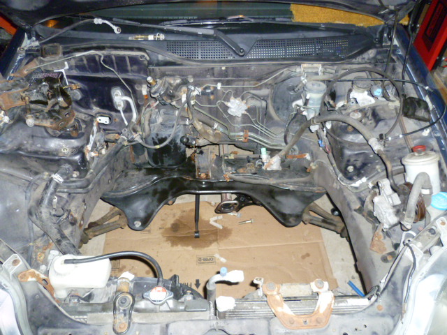

Well that's my DD and not supposed to be the project, so I put as little time and effort into it as I can. LOL! So... The answer to the question about what engine did I put back in is "The same one that came out." I only pulled it because it needed work done on multiple sides of the engine and at that point I thought it was just simpler to pull the whole thing and do everything with the engine out.
Belt side needed new timing belt. Bottom side needed oil pan gasket. Rear side needed new engine mount (taught kid how to drive stick). Transmission side needed new main seal and clutch, etc. So since I needed to work on left, right, rear, and bottom, I just pulled the whole thing out to do the work.
I did do one "bonus" item... I pulled the subframe and put in an Integra steering gear for a faster steering ratio. But that car is not the project.   :beer:

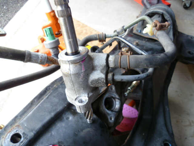

I've got a 6th gen Civic (96-00). I always hated the steering ratio. Always felt like I needed to readjust my hands in the middle of a turn because I needed more wheel rotation. Got fed up one day and started experimenting...

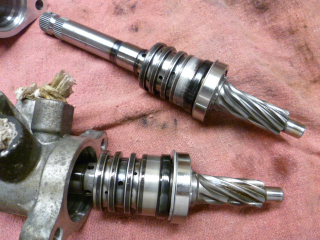

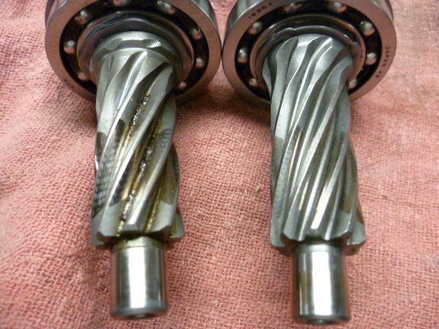

The pinion gear on the end of the power steering spool valve has eight teeth. The similar pinion gear from a third gen Integra (93-97) has NINE teeth (one more than the Civic). Problem is the spool valve bodies are different so you can't just toss the whole Integra body onto the Civic steering rack. However after poking around with both of them in my laboratory, I determined that the GUTS are interchangable.
So it's a "simple matter" of pressing both valve assemblies apart and reassembling the Civic valve body using the Integra spool valve. Then reattach the modified spool valve onto the original steering rack and put in back in the car.
"A child could do it."
Take the valve off the rack:

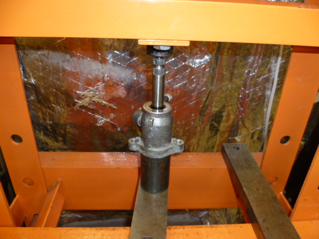

Pressing a spool valve apart on the hydraulic press:
Spool valves. Integra on top. Civic on bottom. Note that the Integra has a tighter pitch on the gear:
Pinion gears. Civic on left. Teg on right:
How did it turn out? Fantastic.
Would I do it again?  If I had the sub-frame out - Maybe.   If I wasn't going in for something else? - Absolutely not.  LOL
