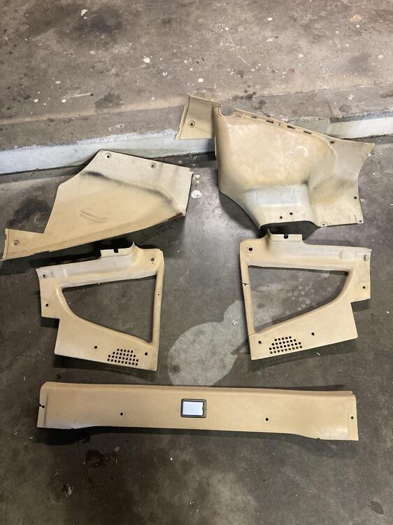

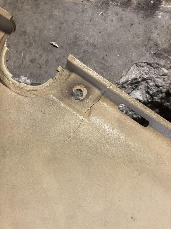

Posted December 6, 20222 yr comment_647965 Hey guys, I am repairing the interior trim on my 280z and I wanted your advice on what I should do. I have read forums everywhere, and it seems like everyone has a little bit of a different method. My panels aren't terrible, but definetly need some structural work. I took some photos of the cracks, but there are a lot more. I was wondering if I should just tack glue things back together with superglue then put plastic epoxy over the back? Others say they add a little bit of fiberglass too? I could do that, but would I need epoxy resin for that too instead of the plastic epoxy. In addition, how would you repair those cracked holes where the pop clips should go through. The thing I am most confused about though is how to paint them with SEM products. I bought the SEM plastic adhesion promoter, and plastic/leather prep, and then a white colorcoat. I have now read there is a product called SEM sand free that people also use to prep the plastic? I am confused as to if I should use the sand free or adhesion promoter. If there are any SEM masters in here please share the best way to go about this, I really want to get this right the first time and never have to touch these again. I am looking for the original plastic texture to look the same. I provided some photos of the affected areas. Thank you! Edited December 6, 20222 yr by ckurtz2 Link to comment https://www.classiczcars.com/forums/topic/68033-280z-interior-plastic-repair-and-sem-coat/ Share on other sites More sharing options...
December 6, 20222 yr comment_647967 I have achieved good result using JB Weld Plastic Bonder and reinforcing the back of the panels with sections of window screen to strengthen the area and provide a good base to fill any voids. Link to comment https://www.classiczcars.com/forums/topic/68033-280z-interior-plastic-repair-and-sem-coat/#findComment-647967 Share on other sites More sharing options...
December 6, 20222 yr Author comment_647970 @DatsunZGuy Did you put the epoxy and screen over the whole panel. or just the areas that had cracked? Link to comment https://www.classiczcars.com/forums/topic/68033-280z-interior-plastic-repair-and-sem-coat/#findComment-647970 Share on other sites More sharing options...
December 6, 20222 yr comment_647974 @ckurtz2 I applied the JB Weld and screen material just to the areas around the cracks or voids. I went so far as to also reinforce the rivet areas as well. Any excess epoxy or screen was removed with an xacto knife and light sanding with my dremel tool. Link to comment https://www.classiczcars.com/forums/topic/68033-280z-interior-plastic-repair-and-sem-coat/#findComment-647974 Share on other sites More sharing options...

January 25, 20232 yr comment_649684 On 12/6/2022 at 6:31 PM, DatsunZGuy said: I have achieved good result using JB Weld Plastic Bonder and reinforcing the back of the panels with sections of window screen to strengthen the area and provide a good base to fill any voids. Thank you for this post. Swapped the screen for fiberglass cloth and treated it more like a layup, but I used this epoxy to bond everything. I'm happy with the results I'm getting. Link to comment https://www.classiczcars.com/forums/topic/68033-280z-interior-plastic-repair-and-sem-coat/#findComment-649684 Share on other sites More sharing options...
