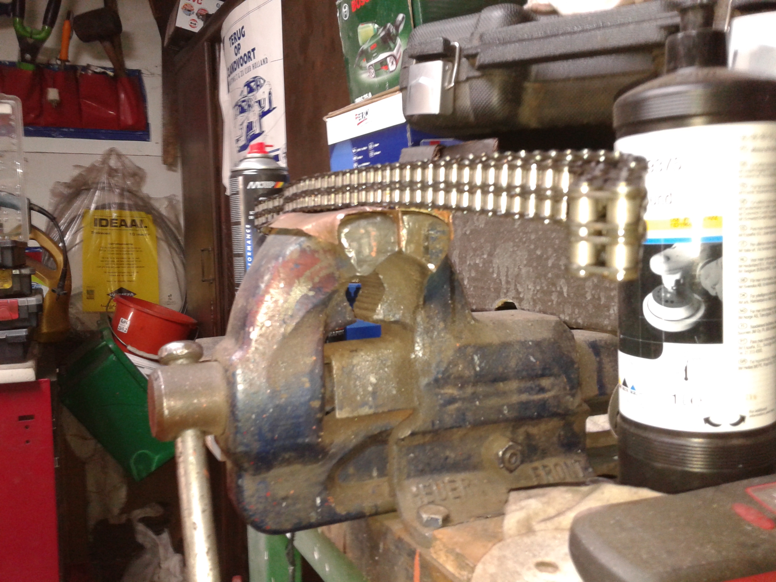

December 11, 20222 yr comment_648120 11 hours ago, kcpope said: Closing lock? Can you elaborate on what that is? A chain has 2 ends.. they meet at one point.. (in your case ON that picture AT 3 o'clock !! You know what 3 o'clock means? that's to the right of the middle bolt, seen from the front.) It looks like there is the closing lock.. It's to long ago for me that i looked at the timing of a L28 but there should be a chain lock in your chain were the ends are connected.. I see something odd in the chain at 3.. Just check the chain for irregularities. Also if you can bend the chain in the wrong way to much it's worn and needs to be replaced. If the chain is very loose replace it anyway. If your chain is like this one.. not bending (to much) in the wrong way, it's still good.. (On a Heuer Front bench vice.. one of the best there are.. 😉 ) Link to comment https://www.classiczcars.com/forums/topic/68038-fuel-pump-eccentric-on-a-28l/?&page=2#findComment-648120 Share on other sites More sharing options...

December 11, 20222 yr comment_648126 I think that dutchz means that there is a plate missing. If it was a bike or motorcycle chain we'd call it the "master link". Not sure that Nissan timing chains have one though. But, considering the odd fuel pump who knows what the PO did in there. Link to comment https://www.classiczcars.com/forums/topic/68038-fuel-pump-eccentric-on-a-28l/?&page=2#findComment-648126 Share on other sites More sharing options...
December 11, 20222 yr comment_648127 Since you have the valve cover off now is a good time to verify all of your timing marks and check your timing chain for wear. Set your damper mark at zero, make sure the tight side of the chain is tight, check the notch and groove alignment, check the distributor timing marks. Determine where everything is now so that when you're trying to get it running you'll know your starting point. It will save a lot of fumbling around later. Link to comment https://www.classiczcars.com/forums/topic/68038-fuel-pump-eccentric-on-a-28l/?&page=2#findComment-648127 Share on other sites More sharing options...
December 12, 20222 yr Author comment_648155 I think that dutchz means that there is a plate missing. If it was a bike or motorcycle chain we'd call it the "master link". Not sure that Nissan timing chains have one though. But, considering the odd fuel pump who knows what the PO did in there. Ah yes, master link is what I’m familiar with. Sounds good.Sent from my iPhone using Tapatalk Link to comment https://www.classiczcars.com/forums/topic/68038-fuel-pump-eccentric-on-a-28l/?&page=2#findComment-648155 Share on other sites More sharing options...
