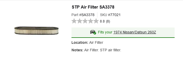

December 14, 20222 yr comment_648225 You can go down to your local AutoZone, O'Reilly's, etc... and try an STP SA3378. Worse case, if it doesn't fit, just take it back to the store for a refund. Edited December 14, 20222 yr by DatsunZGuy Added Image Link to comment https://www.classiczcars.com/forums/topic/68042-air-filter-source/#findComment-648225 Share on other sites More sharing options...

December 20, 20222 yr Author comment_648476 SUCCESS - Autozone was able to special order the STP air filter - #SA3378, and it fits my airbox. I have not heard back from O'reilly's yet. Once again thank you DatsunZguy. Update 12/21/22: Unfortunately O'reillys was not able to locate a suitable filter. They were as always very nice. The manager took the time to take the measurements and search for similar filters. He did come up with the K&N filter that zKars mentions below but said that all of his sources claimed that it was out of stock. Edited December 21, 20222 yr by qz16 Link to comment https://www.classiczcars.com/forums/topic/68042-air-filter-source/#findComment-648476 Share on other sites More sharing options...
