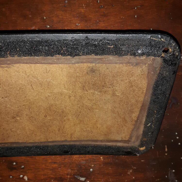

There's a vinyl rectangle on the inside bottom of the rear hatch above the locking mechanism. Mine needed resealing I thought
You might have missed this because it wasn't the problem in site's case.  But it is a big deal if the panel is not completely sealed around the edges.  There is no way to seal all of the entrances in to the inside of the back hatch lid.  The area around the latch loop cannot be sealed without lots of effort.  The best way to keep the gases from getting sucked in is to completely seal the perimeter of the cardboard panel.  I used stick-on foam weather-stripping from Home Depot.
The funny thing about the problem is that opening the windows makes it worse.  It creates low pressure in the cabin, which causes anything hanging out behind the car to get sucked in through the hatch lid.
That piece is indeed off. This could be the issue but I am not understanding how in the world exhaust is coming in through that area though
i have some 3m weatherstripping tape. I will put it back on with oem screws and tape all around edge.

Originally mine had some black urethane caulk type stuff. I had to remove mine to get the bolts/screws that held down the rear spoiler. The weather stripping is what will use just like Zed Head.
Here's the best i can get on the OE sealer...

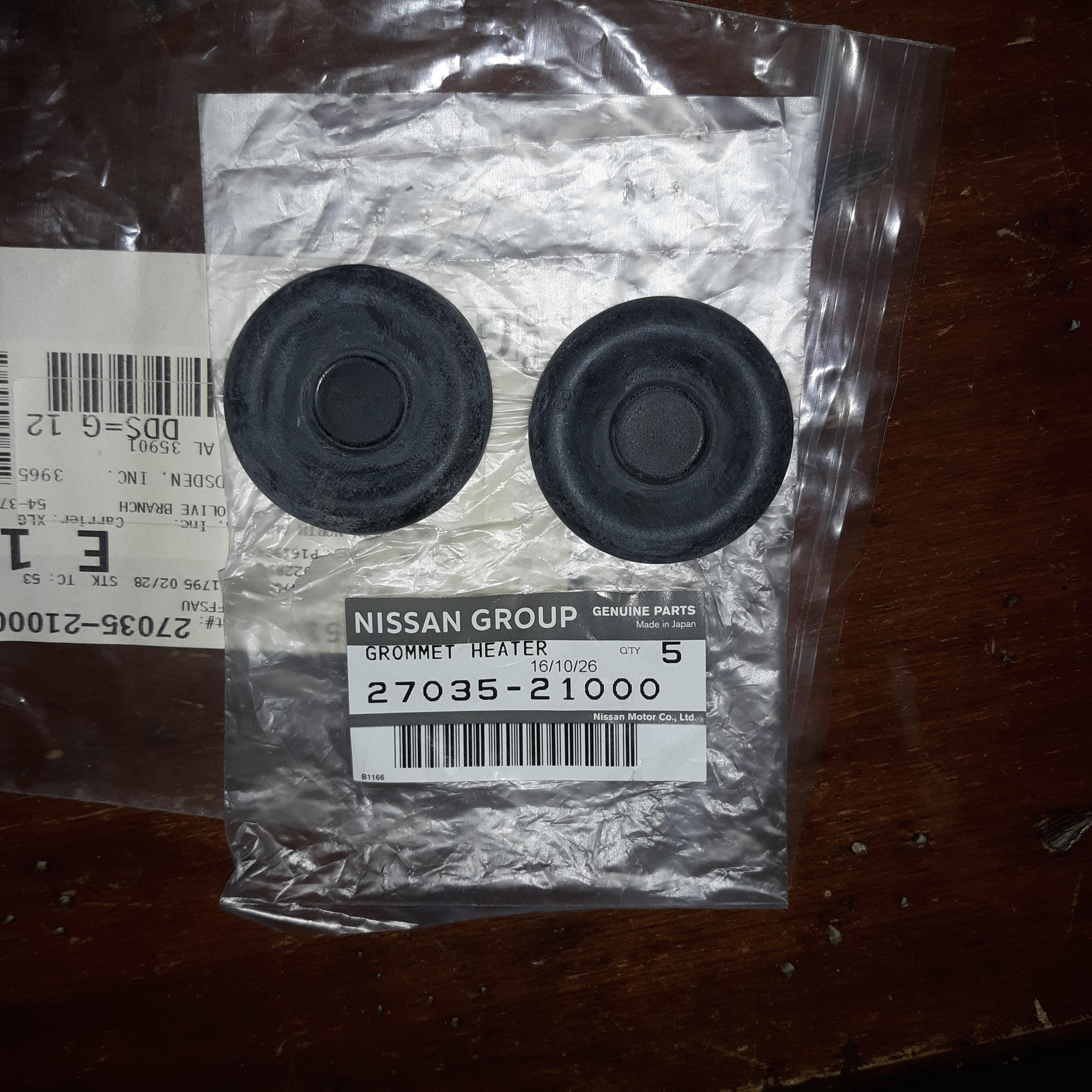

i have all the grommets in place. also i put the rectangle piece back in with sealant all around it. SIGH!!!! there is still an exhaust smell.

Uggh... So i have replaced all the firewall grommets, made sure they all seal good. All new rubber seals on hatch and it seals really tight. Just drove the car and still smells bad of exhaust fumes. I am thinking may have to try the colored fog machine in the car and see where the gas is escaping to. Not sure what else to do at this point.
